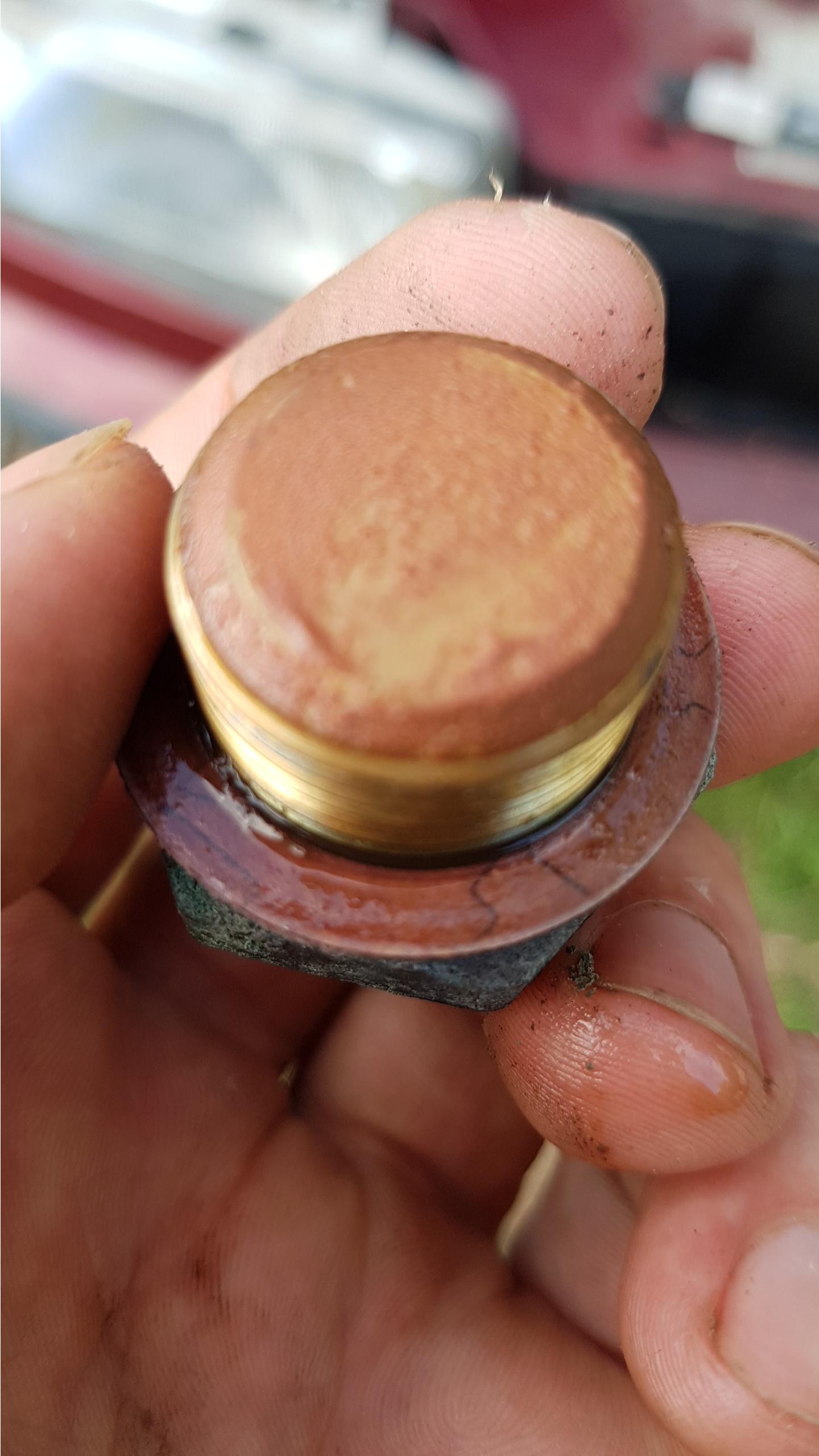

  2. Ah, I believe you are talking of the rubber bit? The part I was referring to is below the rubber. It's not in the carburetor manual, but here is a photo of it: My rubber part is OK, but this has a noticeable wobble when pressed on corners. When placed on a flat surface, if I add water in the middle it leaks out to the sides so it's likely warped a bit.
  3. Cancel that, the shop I contacted to get the part sanded quoted me a new part (original). I was a bit weary of that, but the price was so low that even if there is a risk the part is crappy I don't mind.

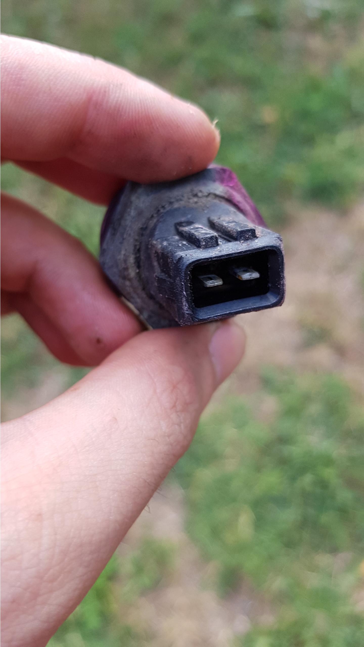

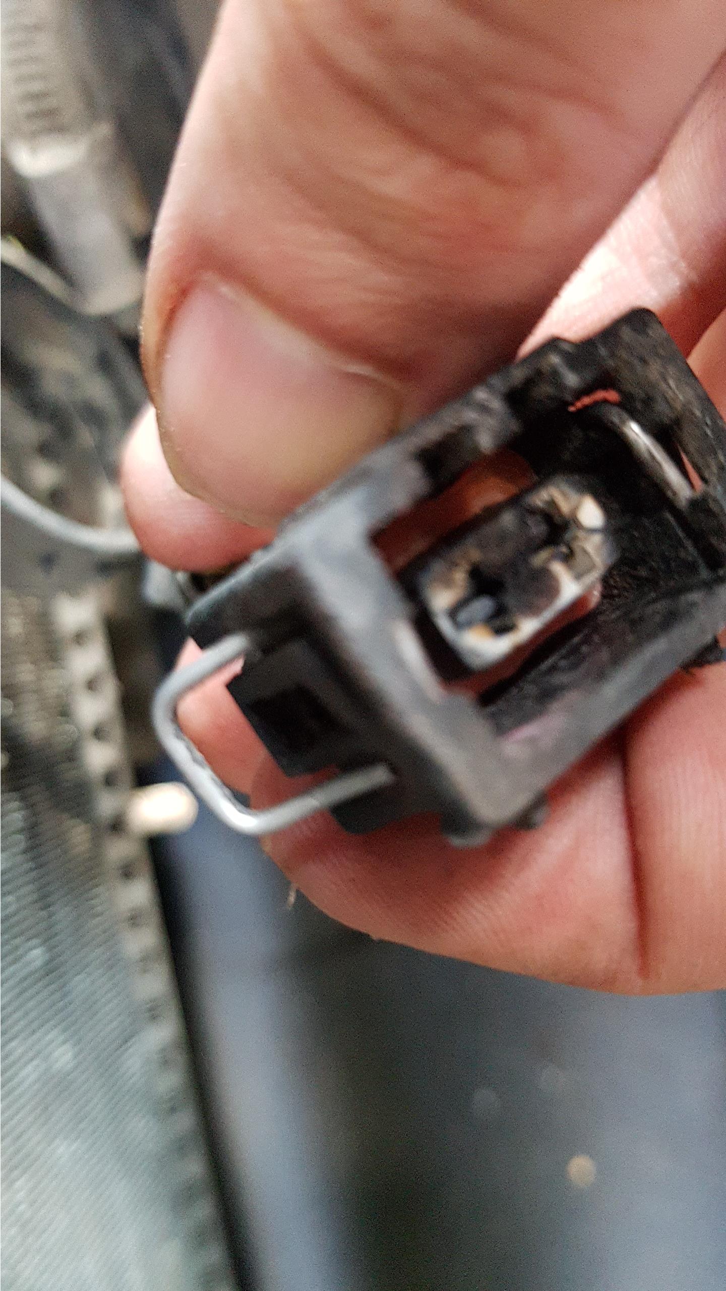

  9. The new radiator switch fixed the issue of the fan being on all the time. Was a pretty easy job, many thanks to Thefeliciahacker for the idea of using spade connectors, it worked like a charm. Replacing the thermostat housing was also easy, previous one seemed to be broken, as the internal components were all loose inside. Now onto the rough idle problem. Whenever I start the car, the RPMs go down until it dies out. If I press the gas, it stays alive, but I have to keep pressing it to keep it that way. There are faint sputtering sounds at idle (though the roughness of it seems to have been improved a bit with the new thermostat). The issue doesn't show itself on the road and at speed, it goes on the highway with no issues, it seems to be at startup only. So far the ideas I have are: 1 - Clean and reset the throttle body 2 - Check the fuel pressure by using the "finger in hose" method 3 - I previously thought a look at the MAF sensor and a cleanup would be appropriate, but it seems Felicias have a MAP sensor instead, and I can't find much information about it and how to maintain it, especially in carburetor models. 4 - Check the tightness of the throttle cable. I've done it, and it has a tiny bit of play, which is how I think it's supposed to be. That is all I have for now. Are there other parts that could be causing this issue, maybe a sensor I don't know of? I ordered a Haynes manual but it will take a bit to get here. Any input or suggestions are appreciated.

  11. Ok, so continuing on this topic (not sure if I should create a new topic for the new issue or not). All attempts to charge the battery ended in failure, so I took out the old one and put in a new battery. With that, car turned on and there was no trial or error with the key, the new ignition switch just worked, so that's an improvement. The car doesn't stay on without the gas pedal being pressed, but that's a problem for another day (need to check the throttle body, the fuel pump and the sensors but since I'm waiting on getting a proper VAGCOM cable for it, it has to wait). As soon as I plugged in the battery, the radiator fan came on and stayed on. That likely explains why the previous battery went flat. I read that in some cars this can be caused by a faulty relay, but I don't think that's a likely issue since I unplugged all relays and the connections look good. Next came checking the radiator: First off, it was out of coolant, so I flushed the cooling system and the stuff in there was absolutely disgusting. Secondly, I read that this can be caused by a faulty Temperature Switch, I took it out and it doesn't look too bad but it's a cheap replacement anyways so I might as well put in a new one. Here is a photo of the existing one: However, I think the likely issue is the cable that leads to the temperature switch. It looks pretty burnt out to my eyes: What part should I get to replace it? I can see temperature switches on local part websites and skoda-parts, but I can't seem to find the cable that actually leads to it. Here is also a photo of the inner part of the temperature switch. The stuff that was in the radiator was absolutely vile and left a coating of crud on the surface...
