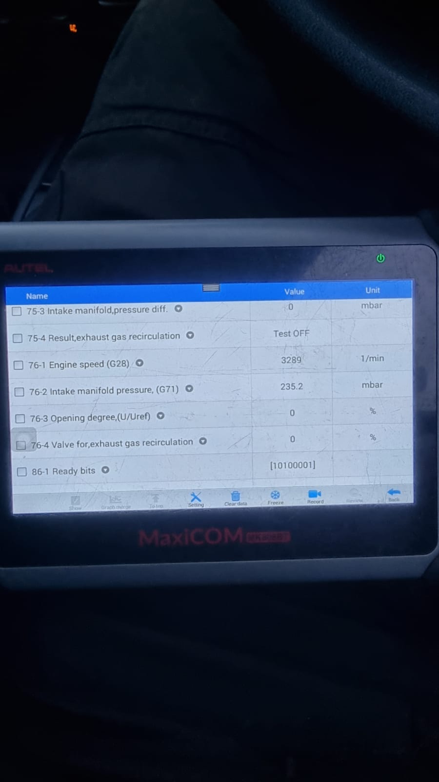

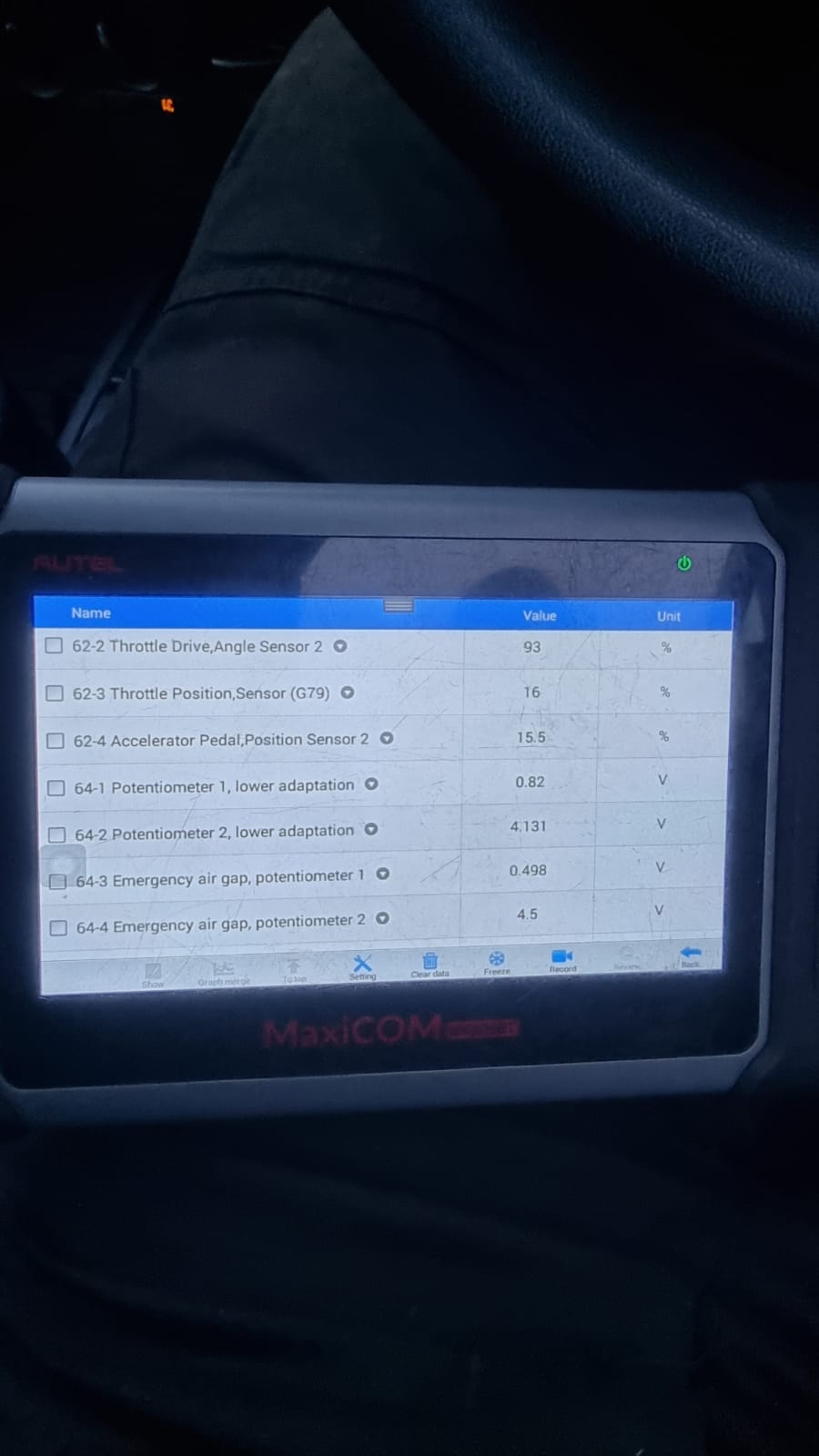

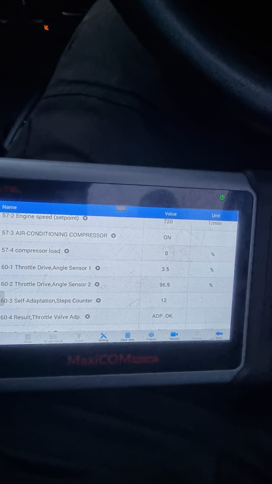

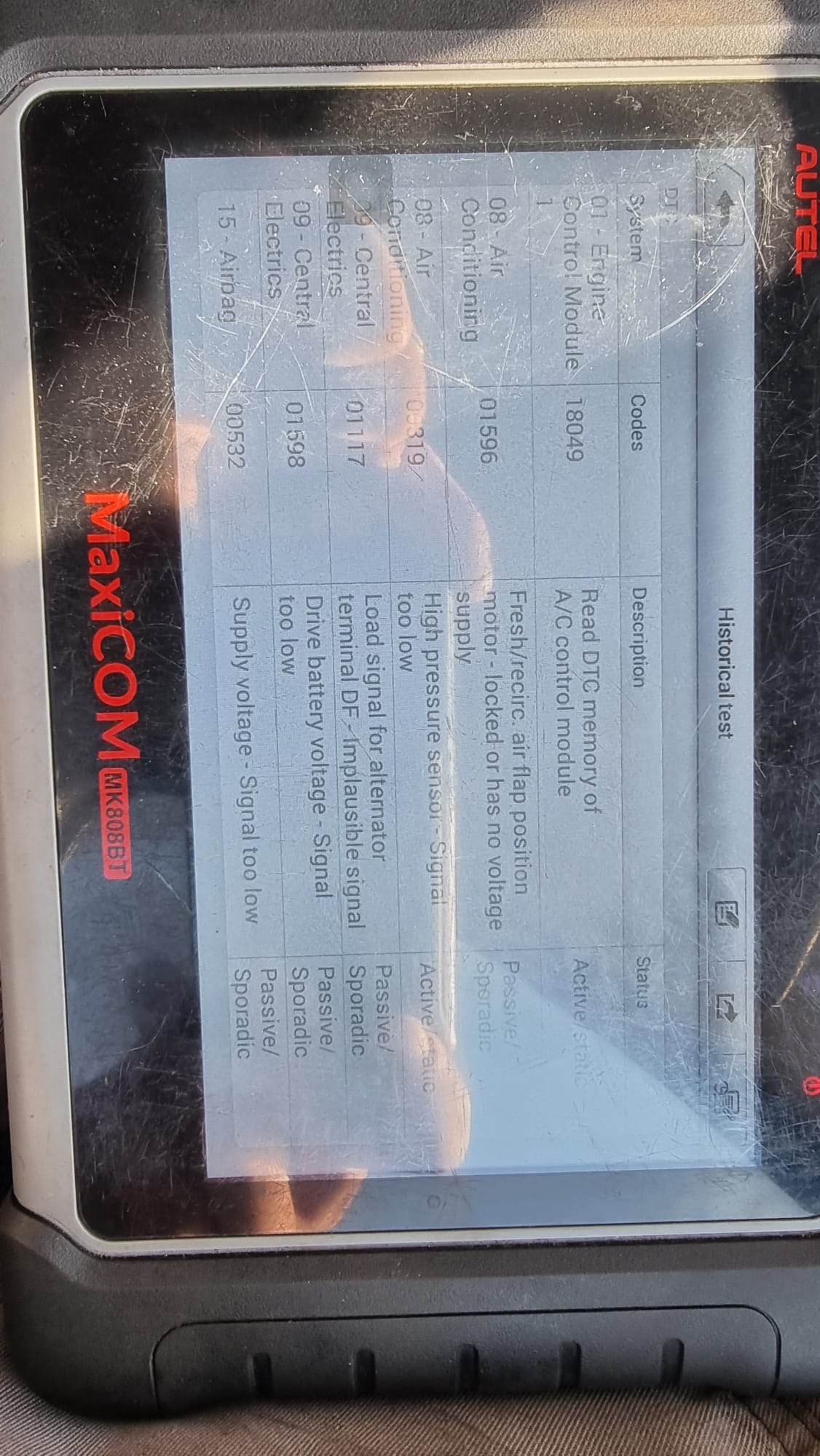

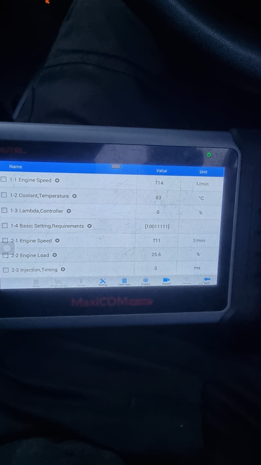

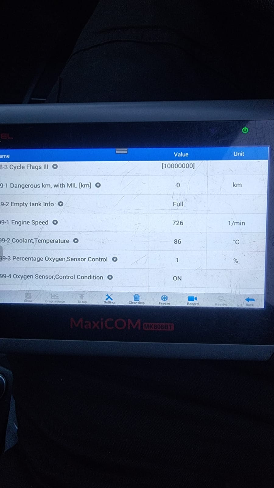

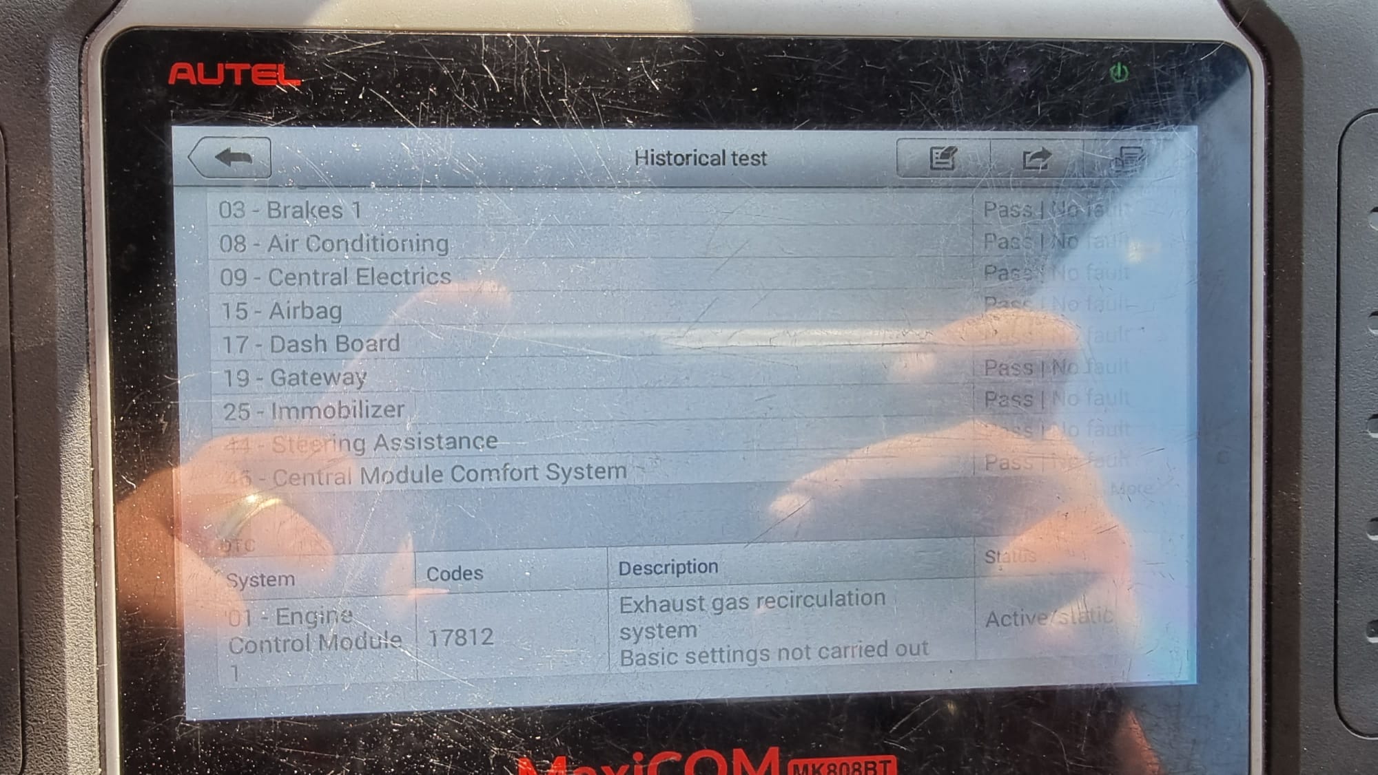

  1. I went to the mechanic with the car put on the tester and it was all was OK, I attach the photos. .
  2. Hello, I have a problem with Skoda fabia 1.4 16v 101hp 2006. At idle the car starts to shake very hard and the tachometer oscillates until it stops. I cleaned the throttle, EGR, and MAP flap and continue to stop can you help me please? Thank you
