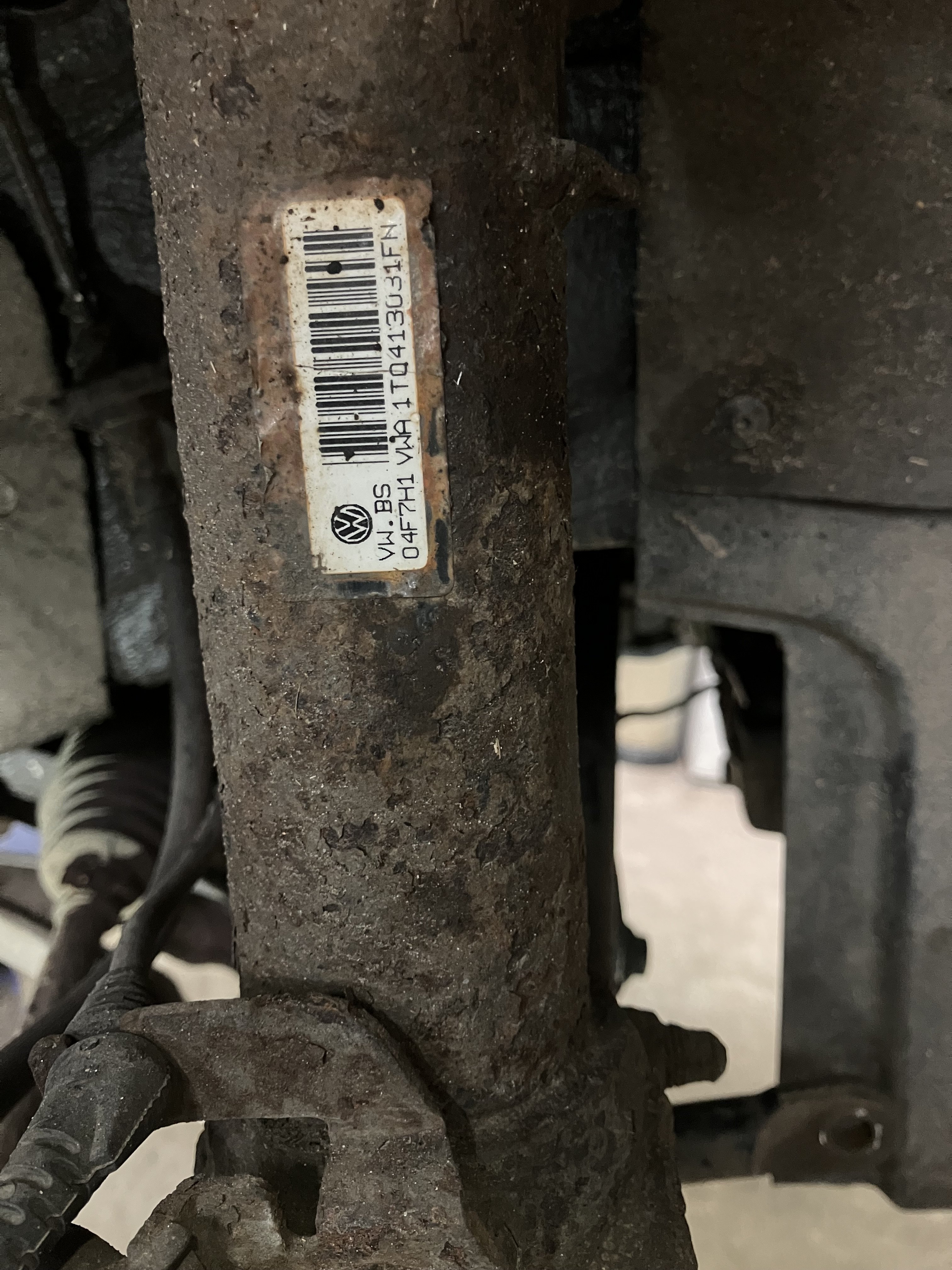

  8. Hi folks, does anyone know if the part number 1T0413031FN has been superceded? (this is the VAG part number on my old part). I am after replacement front shock absorbers for my 2007 VRS TDi, after a bit of googling a lot of aftermarket suppliers list one of their options to fit numerous O.E part numbers. Also does anyone have any recommendations on brand/supplier, i.e. Sachs, Bilstein, KYB etc? Many Thanks
