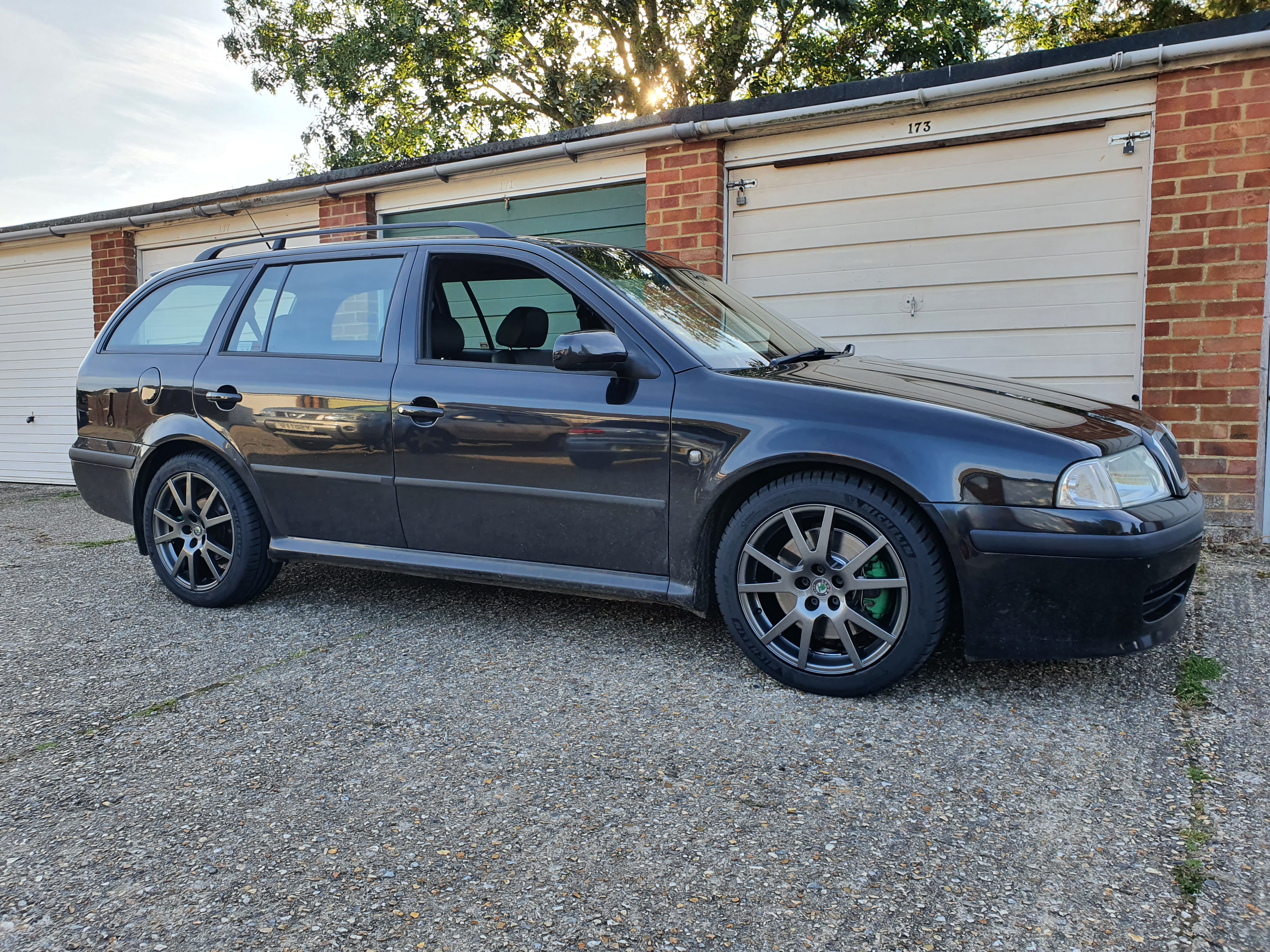

  3. Combi update! Firstly I appreciate these photos are not the most exciting, just parked up in front of a load of bins... 😂 But the weather is awful today, and I only just managed to take these whilst dodging rain and wind. I will of course be taking some much better shots, but for the meantime I just wanted to take these as a way of updating the project. It's been back together and on the road for the past two weeks and apart from a few niggles like the Forge intercooler hose popping off its been faultless. The timing belt, water pump, and aux belt were all replaced last week along with new injector seals and cups as 3 of the 4 were sweating around the inlet manifold. A new coolant bottle has been fitted also to replace the very tired original one. I finally got round to fitting the Whiteline rear adjustable anti-roll bar after hearing so many people say what a difference it makes and I can now only agree with everyone else! I've currently only got it set on the softest setting as I wasn't sure what difference it would make, but it's completely tightened up the rear end and taken away any wayward handling. Before I fitted the front bumper and Forge intercooler I tackled a few jobs in and around the engine bay. SAI, N249, N112, and EVAP all now deleted and the PCV system simplified and now running through an oil catch tank. My next plan is to refresh all the suspension components with polybushes and source Audi TT lower arms, hubs etc to enhance the handling of this old barge further! It's booked in at Badger 5 next Friday for a session on the rollers and hopefully to take advantage of the stage 2 mods that are currently fitted, and to map out the deletes I've done. I'm really looking forward to getting out to as many meets, and shows as possible this year and once I've sourced a second set of wheels with some sticky rubber I will also be venturing out on track!
