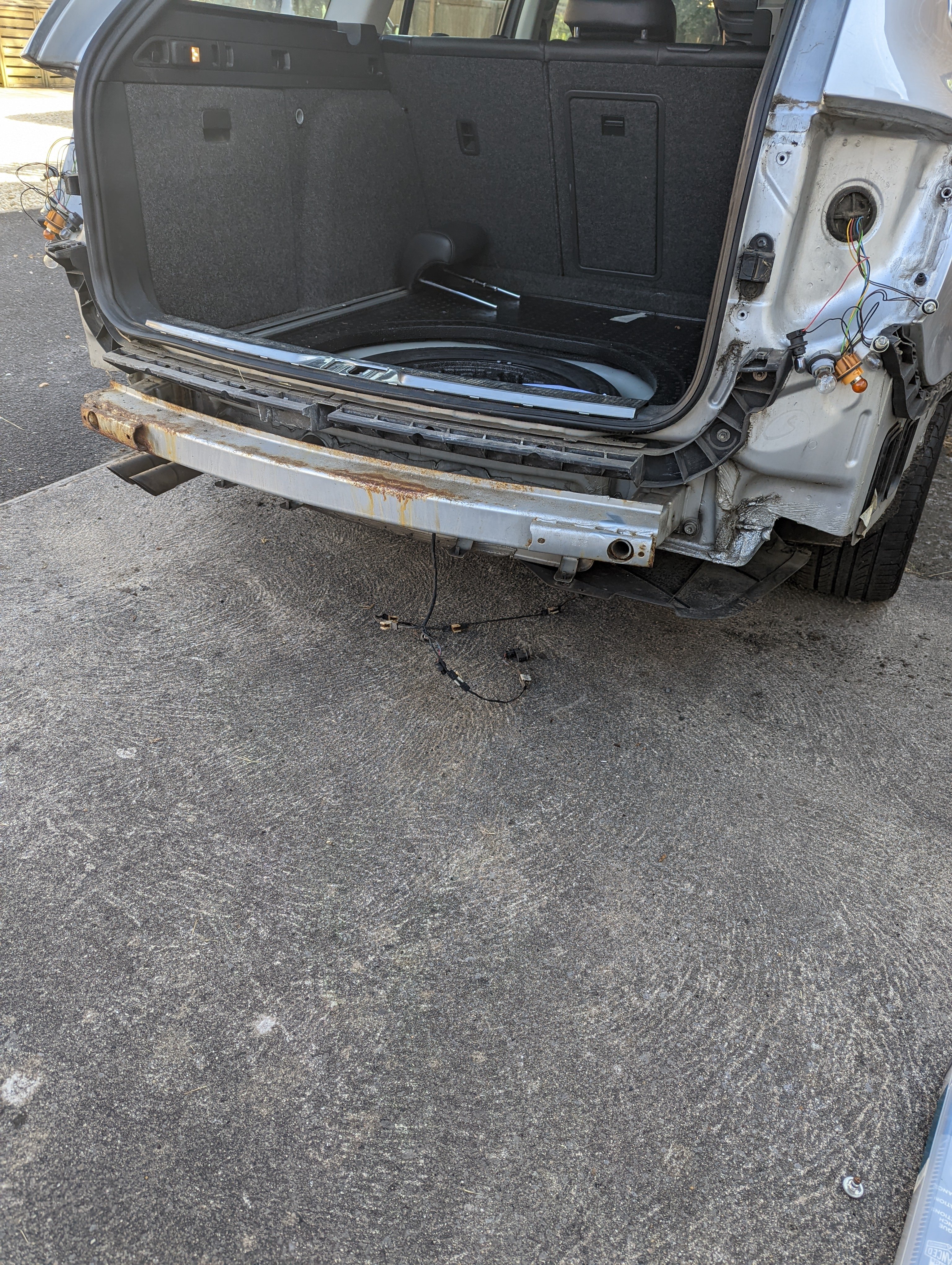

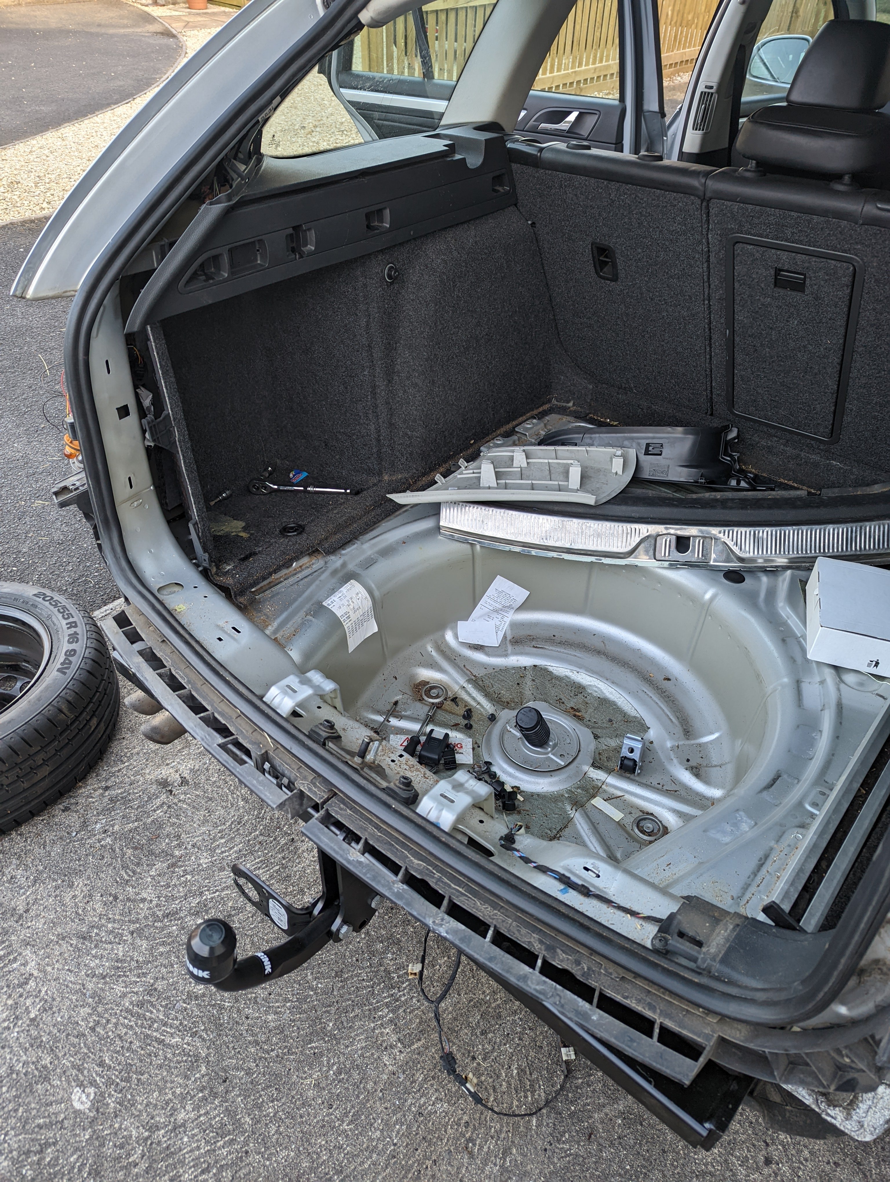

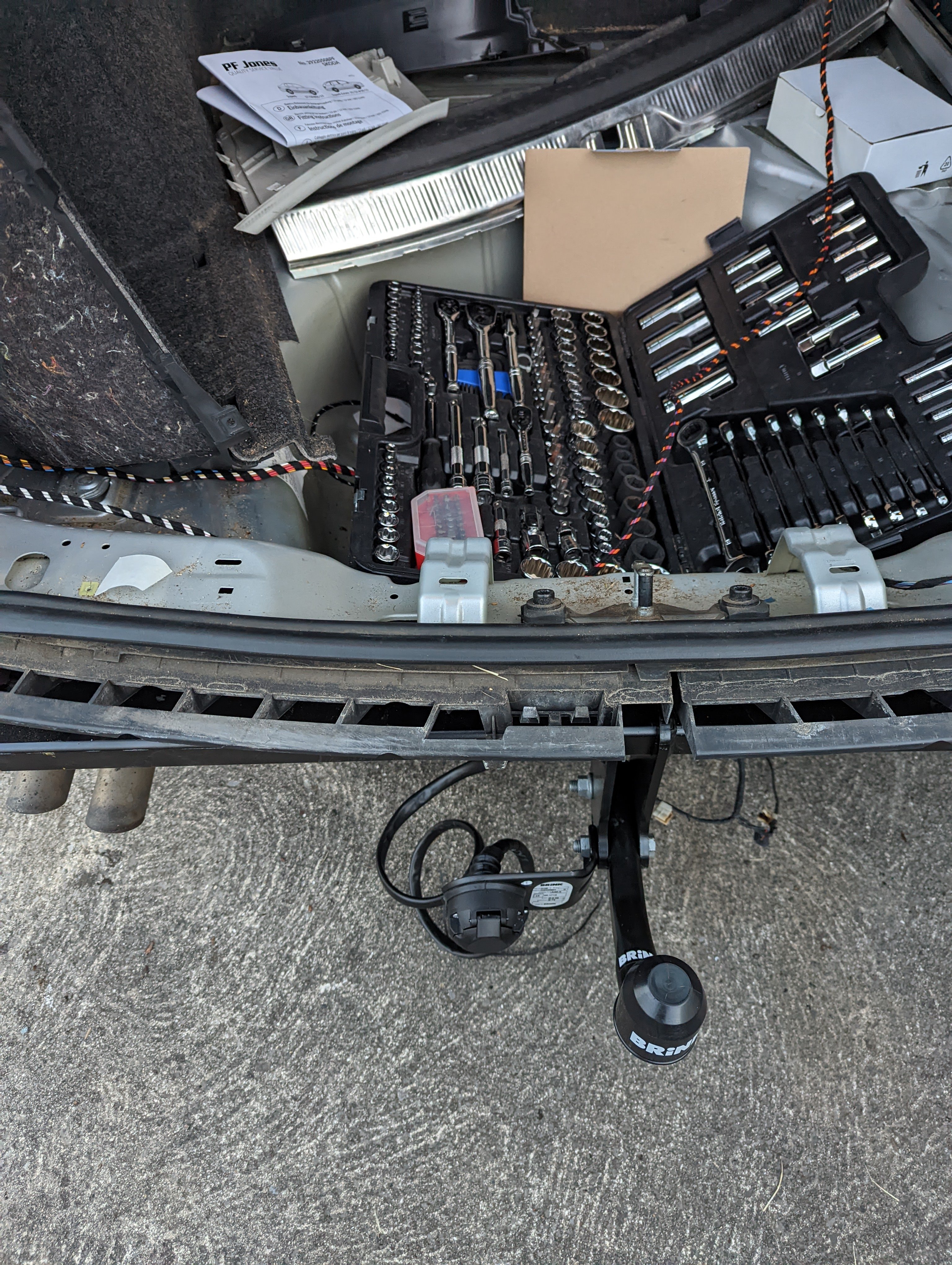

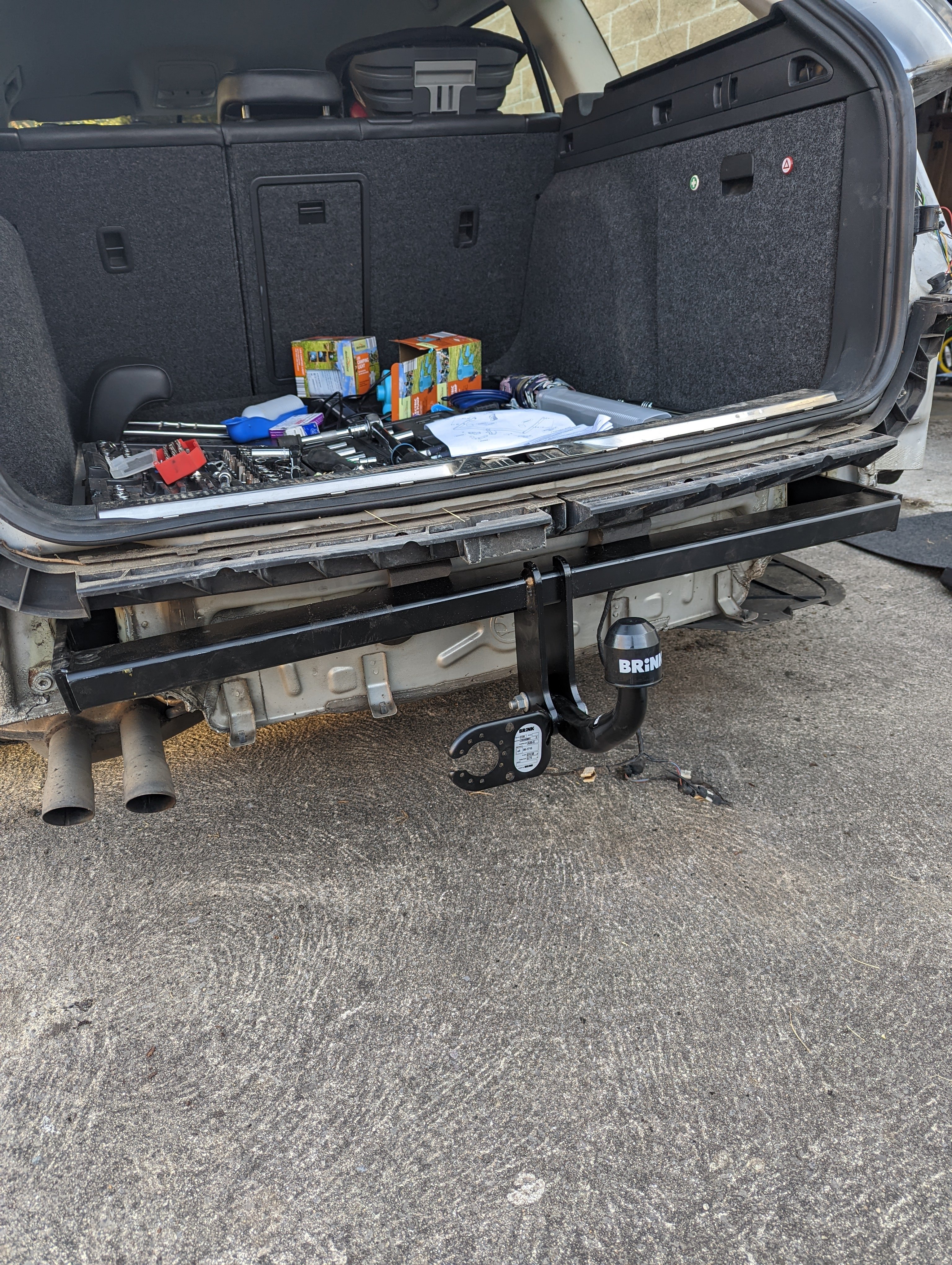

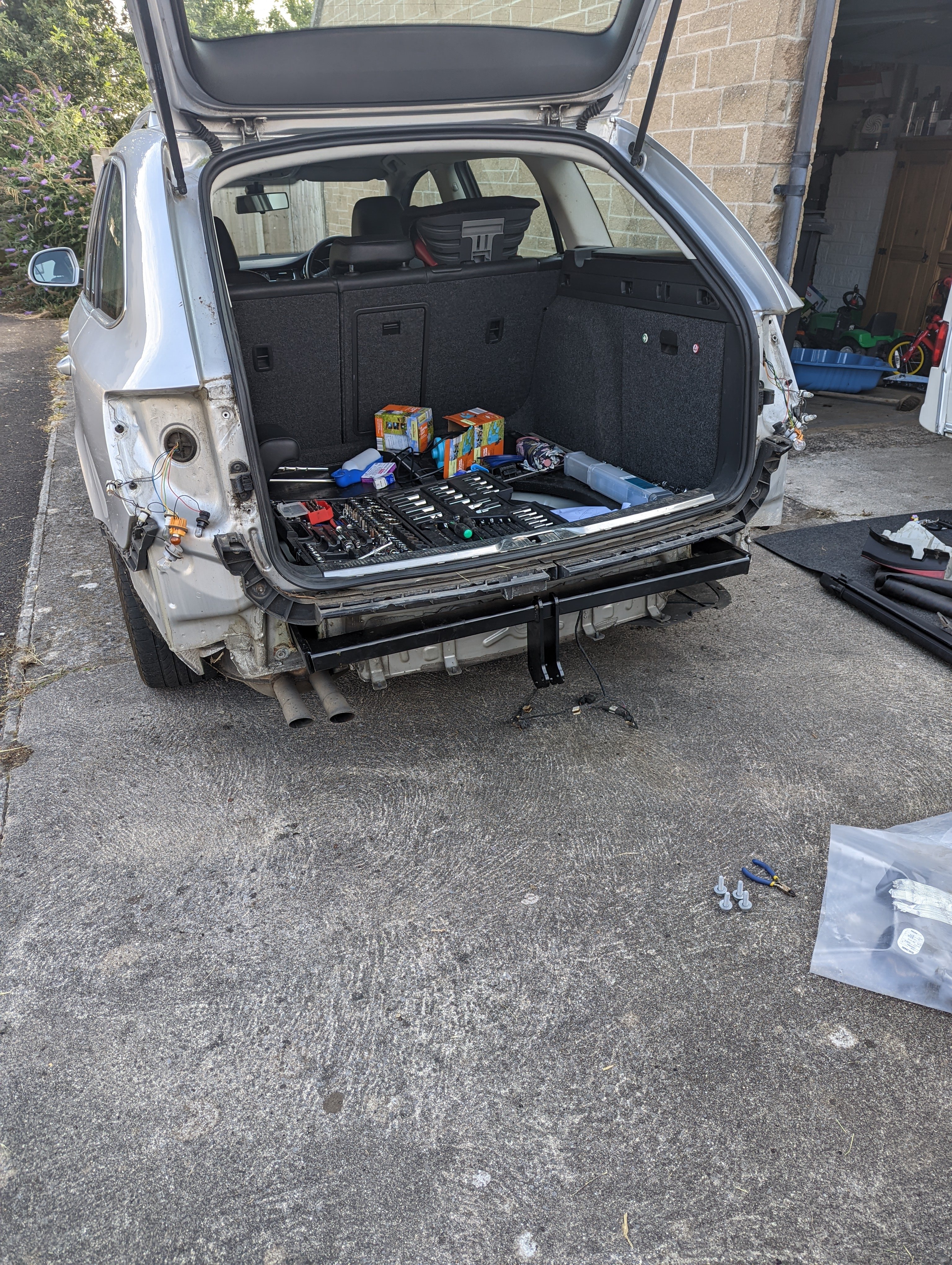

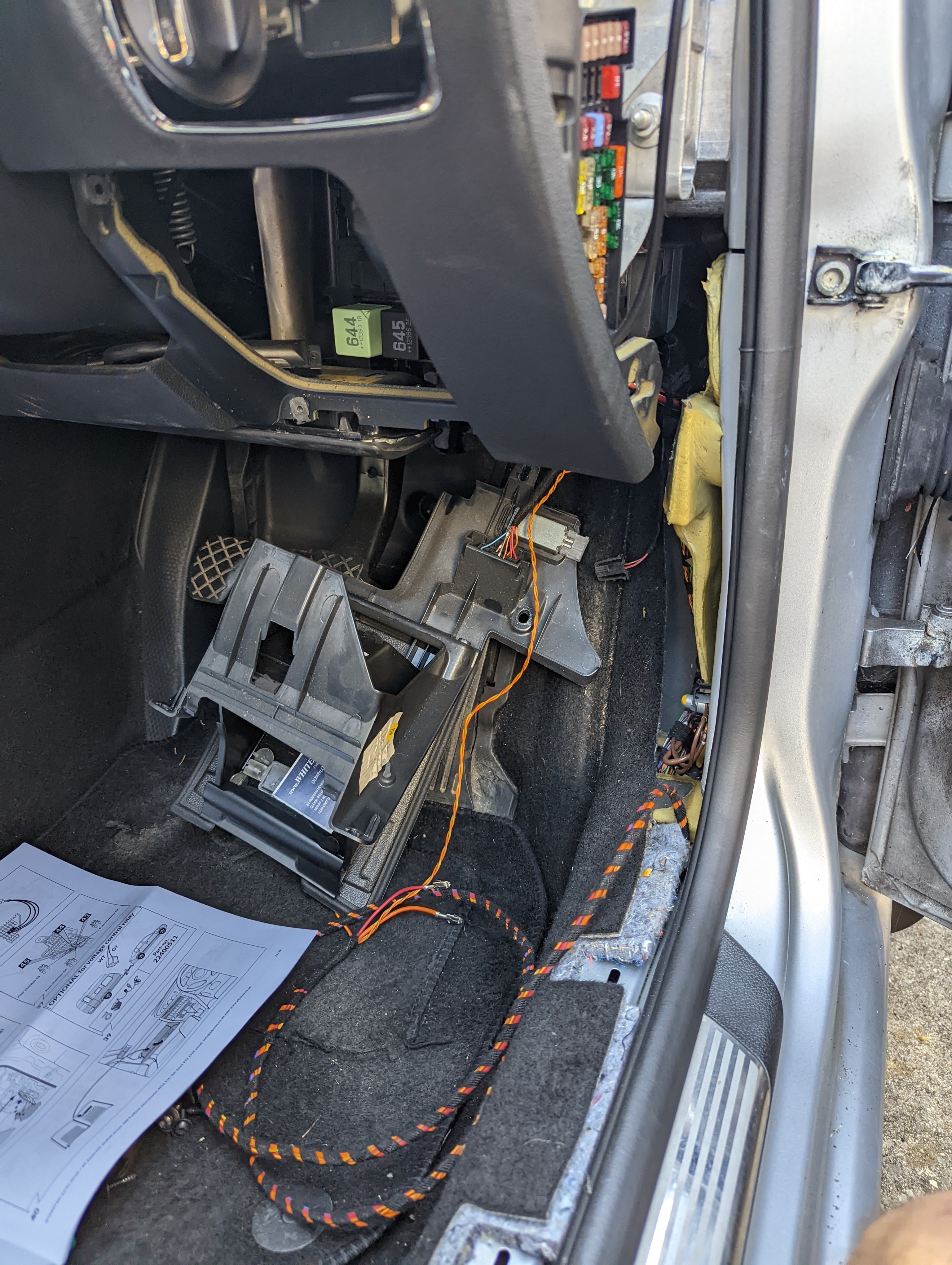

  4. Superb MK2 Estate - Towbar fitment I am using PF Jones Brink fixed towbar and vehicle specific electrics. This has been a mammoth job so far. The instructions and technical support has been brilliant if anyone is thinking of buying from them. Towbar - simple to fix on if you have a good set of tools and torque wrench. Lights electrics - bit more challenging, all fitted and running from the boot, down the right to the fuse box at the side of the drivers steering wheel. Hooked onto the canbus network. Power electrics - instructions just say fit to the battery power and run down the left side ok the car to the boot 🫣 Glovebox out, found a grommit under the windscreen to feed the wires through and removed all the trim down the left to the boot. These wires have now connected to the lights electrics and is monitored by a battery regulator relay. Jobs left - Coding the electrics, this is the moment of truth 🤣 found a very nice man to help locally with his VCDS. Put the trim back into the car and cut the bumper to fit around the towbar. I got quoted £400 to fit all of this and I wanted to have a go at fitting myself. I have really enjoyed doing this so far and would urge anyone to have a go. But make sure you have a good set of tools, torque wrench, wire strippers and access to VCDS. Otherwise, pay someone else 🤣
