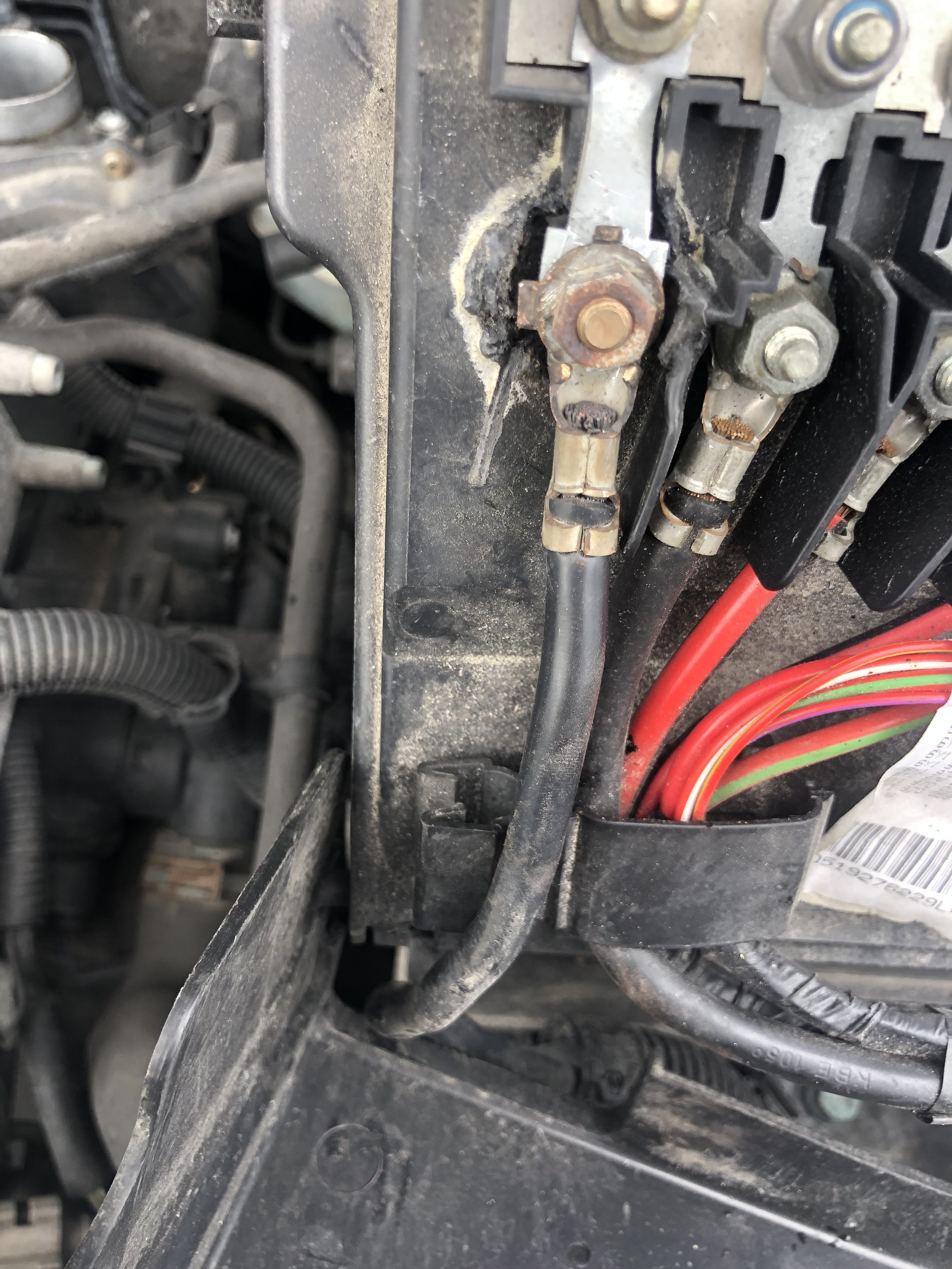

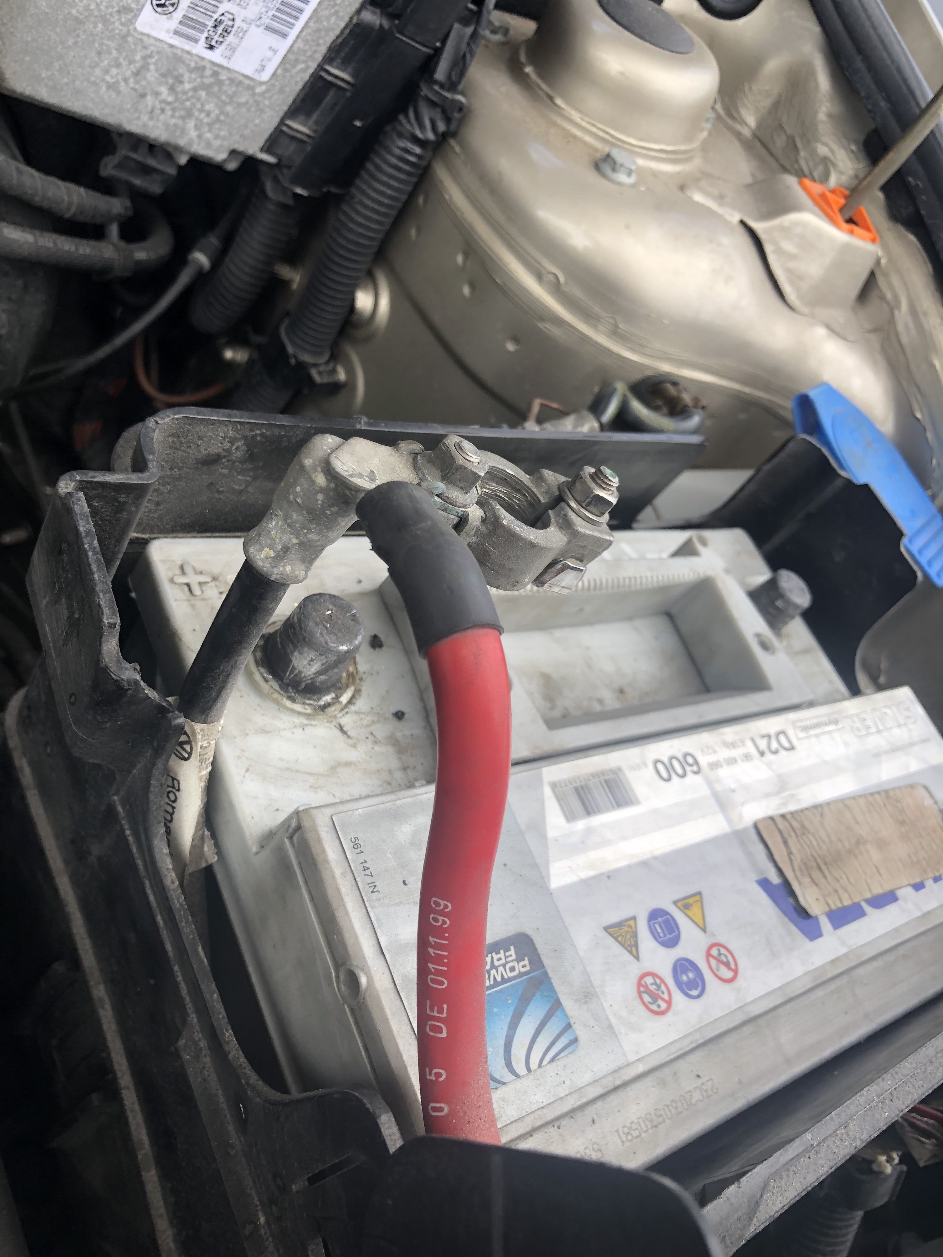

Guessing it´s the one that goes to the fuse on picture 2. Next question, are you sure there are no other connectors from there to the alternator? This cable more looks like a 8mm2 rather then 16mm2.
Engine dies, battery dead and then it starts a few days later
I'll get it, hopefully tomorrow! just gotta be sure now, is it the bottom cable that comes from the alternator output (picture 1) or is it the one that goes to the fuse to the left? (Pic 2)

Cant explain how grateful i am for your help. Im going to take it off now and see if i can find any visible damages.

Found this connector for the battery plus, when i measured the V between these spots it was like 0,2-0,3V difference so i took it off and cleaned the connectors, now it´s the same between and now the V is a little better on the battery when engine is running. From 12,7 (off) to 14,13 on idle when i turn off all the electricity but then i tried to turn everything off to see what happens under load. When everything is on (ac, radio, blinkers, headlights etc) the V jumps from 14,13 to 12,78. Is this normal or is the output too low? If so, can it be anything else then alternator?
