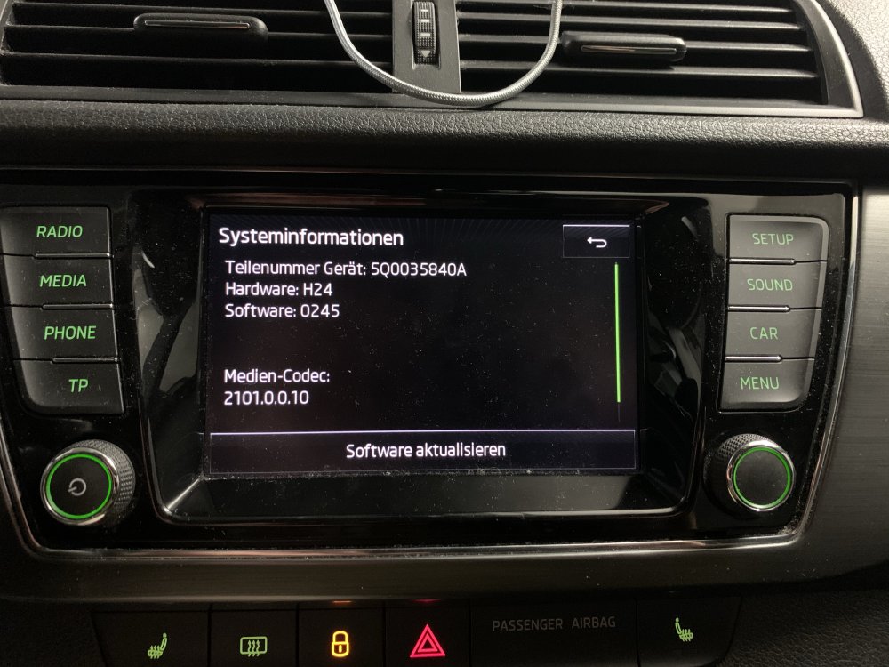

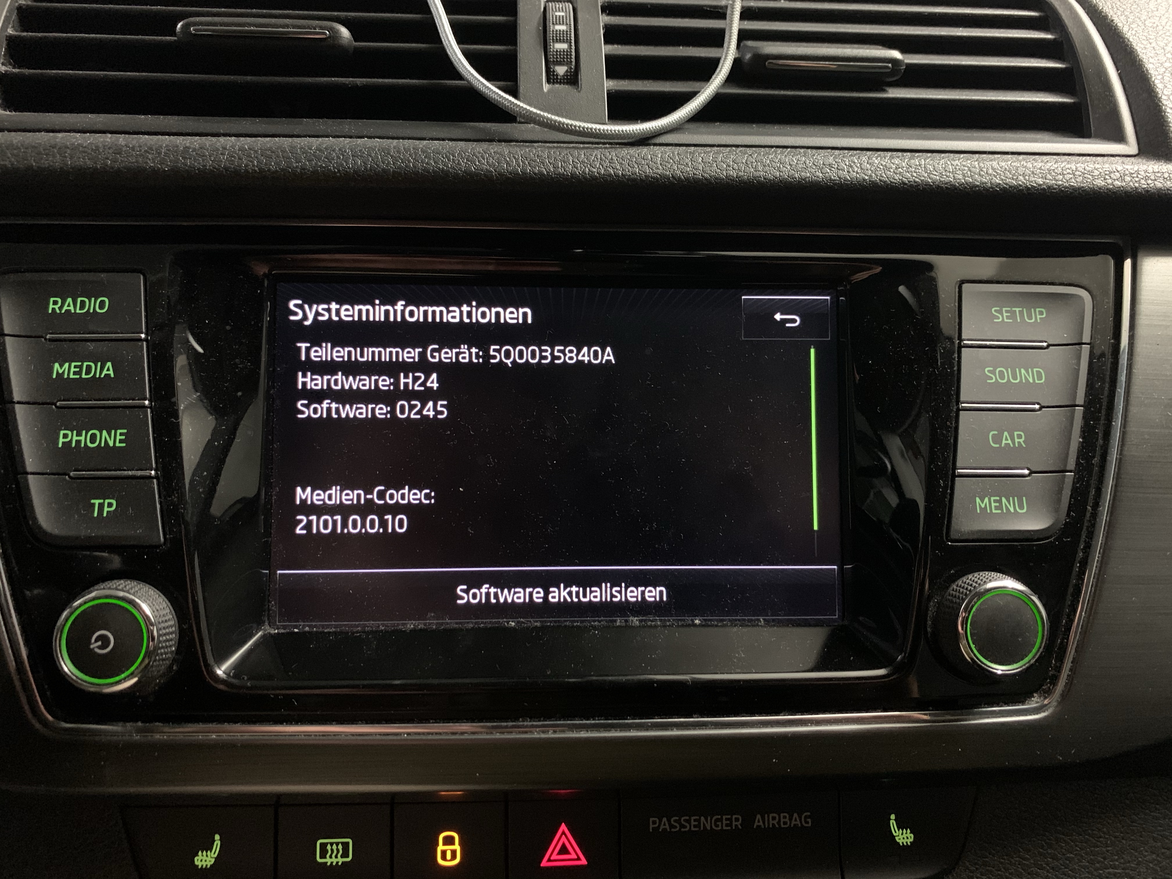

  1. Thank you very much, this solved my issue. With a fat32 formatted sd Card It was possible (it let’s you choose between usb,sd,cd)
