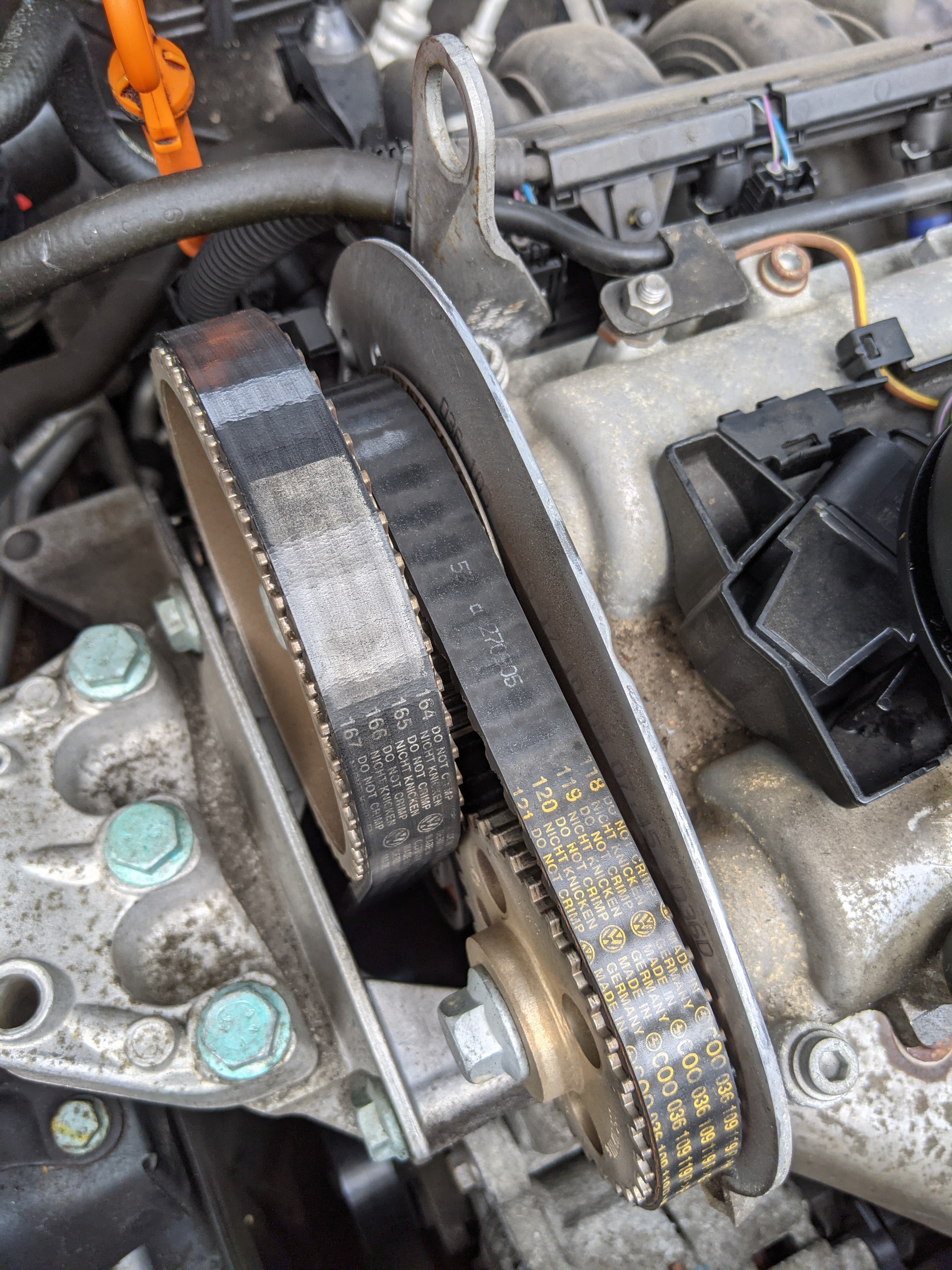

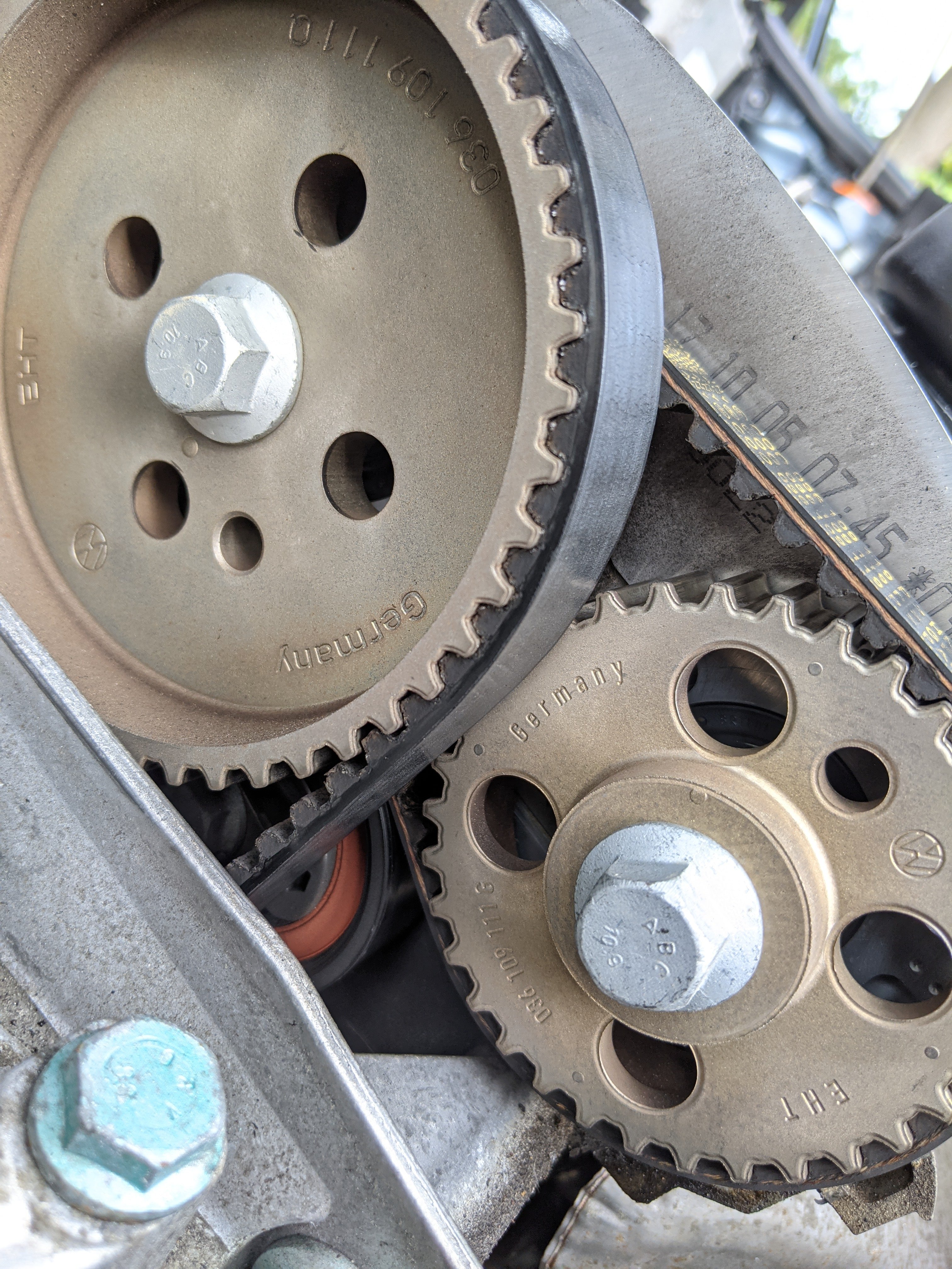

  4. Hey @Wino, I finally found the time to check it. These are some photo's, more on the link, https://imgur.com/a/IlHvIg0 As far as I can tell the date says 270905, or about 4 months before the car was initially registered, so I'm guessing it's from the factory. The condition to me seems good, but I have no idea. Thanks for taking the time to check it out!

  7. No I'm afraid it doesn't. It was around 5 years ago.
  8. Hi all, I bought a 2006 fabia 1.4, with 134000km on it. The first owners have documented the maintenance quite okay, but after 75k, there is nothing to be found. I have replaced the oil, oilfilter, airfilter, sparkplugs, brakefluid, coolingfluid. The dealer I bought it from replaced the clutch, since that started slipping within 4 hours of purchase. I'm guessing that 15 years, 8000km per year it's just been used for groceries, so lot of city driving and thus clutch wear. The tires are getting replaced in october, the brakes seem fine for now. Enough pad left, no grooves. I am worried about the timing belt, I don't know if it has been replaced and if not, I don't know if it needs replacement. Is there are way to check the condition, and how do I judge if it needs a change? And is that possible for a beginner with basic tools? If there are any other parts I should check, please let me know. The car itself is in great condition, like it has been in a garage it's whole time. I just think that the last owner neglected some maintenance.
