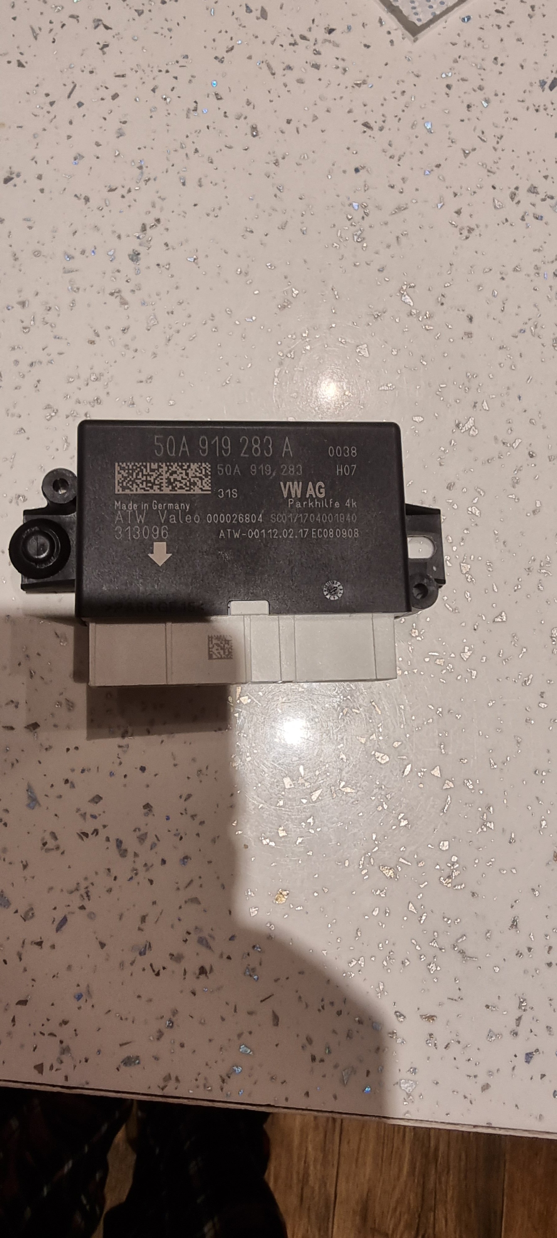

  3. I've got the v2. I paid £60 for an auto election to put his 2 different computers on today and he can't find the problem 😏

  6. 2017 skoda superb estate Is the a front headlight levelling sensor on this car? I've checked all of the suspension parts on the front left where it's supposed to be located and nothing Thanks
  7. Afs cornering fault. I've tried vcds to find the fault but it cannot connect to module 55. Is there a master control unit in the mk3 ?? If so where is it. The driver side light moves up and down but not side to side. The near side does nothing. I have removed both lights and swopped the left light with the right and then the left operates connected to the right side wires. I have changed the rear level sensor but there is not one on the front ????? Any ideas would be a great help thanks
