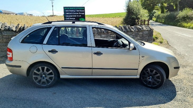

  7. Hi all. First time poster here but used this forum for many a fix on my 2006 1.9 TDI PD100. I had the P0118 code and EML on, so replaced the coolant temperature sensor. The code and EML keep coming back after a reset. I've read that this can be a wiring issue, so I've checked as much as I can physically and all looks OK. Does anyone have any pictures of usual areas they may chafe or become damaged? Also I've seen to measure from the plug to ECU - is that on the connector to the ECU itself? Any help would be much appreciated as MOT is up on Saturday and I have no money to get this sorted by someone else beforehand. Thanks!
