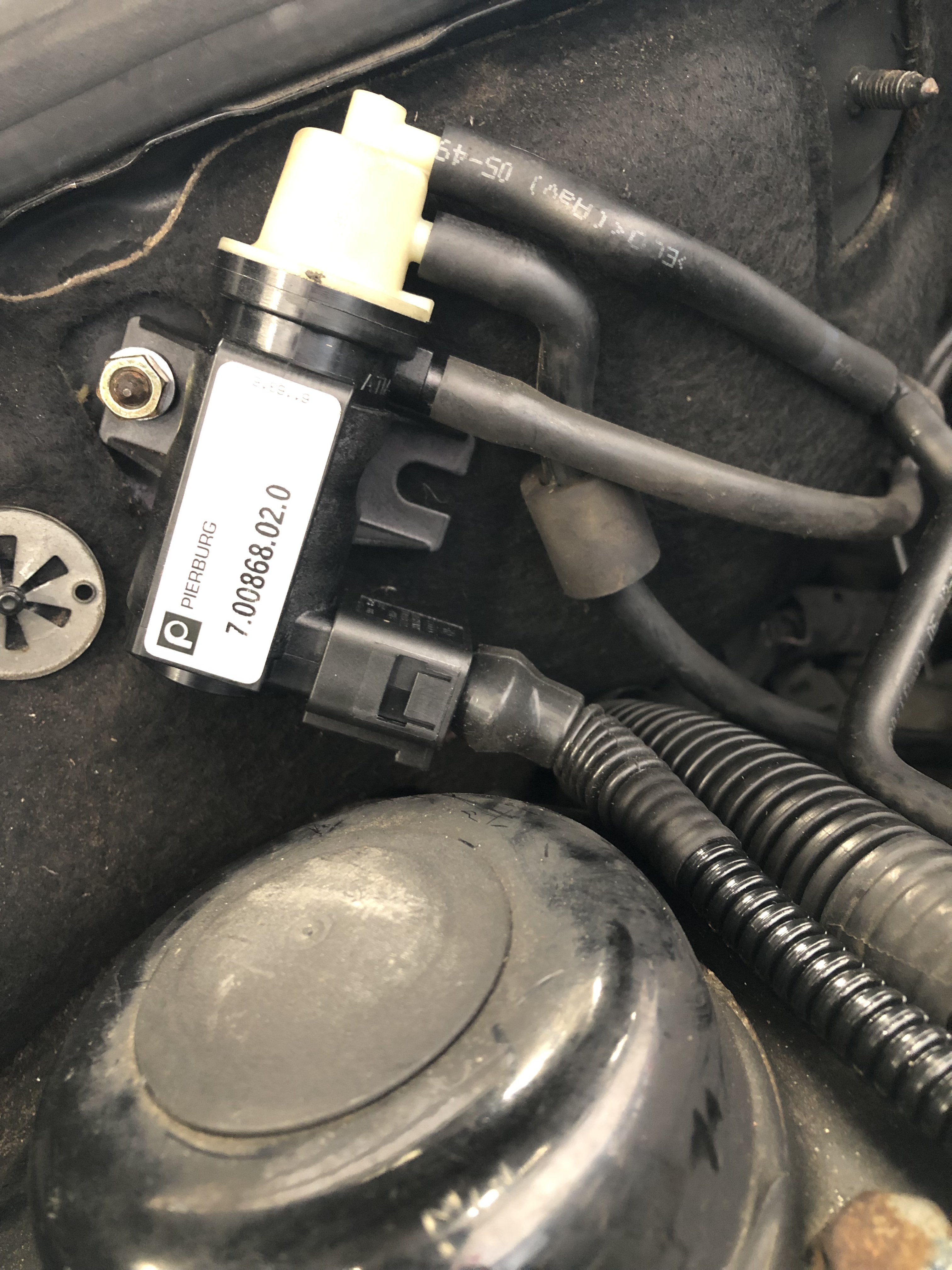

  1. There’s no obvious signs of a boost leak, no oil weeping from pipes and For how slow it goes id expect some black smoke 😂 it’s doing my head in now 😐
  2. So on the n75 the top line goes to the air box, one below goes to the turbo actuator and the one at the bottom has a T piece which joins the vacuum reservoir to the servo line. This problem existed before I fitted the n75 anyway so I sort of ruled that out 😂
  3. That’s what I was thinking… I’ve examined all the vac lines, and since fitting the new n75 valve there is no need for the egr and asv vac lines
  4. alright lads need some advice on my fabia i have been experiencing a lack of power in 1st and 2nd gears. it is not completely gutless, however drives nowhere near as hard as it used to. Sometimes it will be slow up until 3k and then suddenly theres a noticable kick in power until i run out of revs. Really weird issue as i know that the gear i am in shouldnt affect the turbo in anyway at all really. some stuff ive tried is: check for fault codes - all ok cleaned maf sensor + checked wiring all ok check map sensor wiring all ok replaced o ring on turbo coupler eradicated all boost leaks confirmed vaccum present at turbo actuator (only through feel as i cant access vcds) checked for stiffness in actuator rod - moves freely no tough spots replaced vac box for n75 simplification it is worth mentioning theres an audible hissing while on boost which i have narrowed down to the egr blanking plate. I cant get it to seal for the life of me, its the darkside kit and ive used exhaust paste and a new gasket to try and create a good seal, but nothing seems to work... im wondering the the plate itself may be bent or warped. would this even cause such dramatic loss in power anyway? any advice greatly appreciated cheers

  6. so stick to putting 4.3l of oil as i normally would? and the dipstick will read the same? cheers mate
  7. im going to be fitting a shallow sump to my fabia soon and i am wondering if a shallow sump requires less oil than the standard one? in my head this seems like a stupid question but id imagine that i can stick to using the dipstick as normal. even though the darkside shallow sump may hold less oil so long as the dipstick reads on the max line it should be ok right? cheers
  8. It’s more a simplification. My understanding is the original vac box is basically an n75 valve anyway, but once you delete the egr you have no need for 2 of the vac lines. So you can clean up the engine bay a bit, and some say it controls boost better I think.
