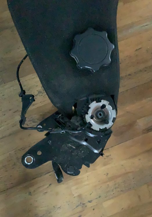

  1. Managed 100 miles and it popped out again pulling off a junction! some kind lads in a VRs stopped and towed me home any thoughts?
  2. Just had another look as it’s been pouring down with rain the outer cv joint seems to have popped out. I’ve wiggled it around and managed to get it back in, should this be okay now? seems that it happened when I was trying to wrestle the strut in and out.
  3. Hi all, well I managed to get the secondhand strut on and all fitted nicely thinking how sweet of a job it was, however… The drive shaft has popped out and I’m a bit unsure what to do next. All the rubber boots are in tact and the brake rotor spins freely and so I’m a bit unsure where it has pulled away. any advice where to go from here? Should I dismantle everything take the strut out again and wiggle it back in? I’ve made a right **** out of a simple job!

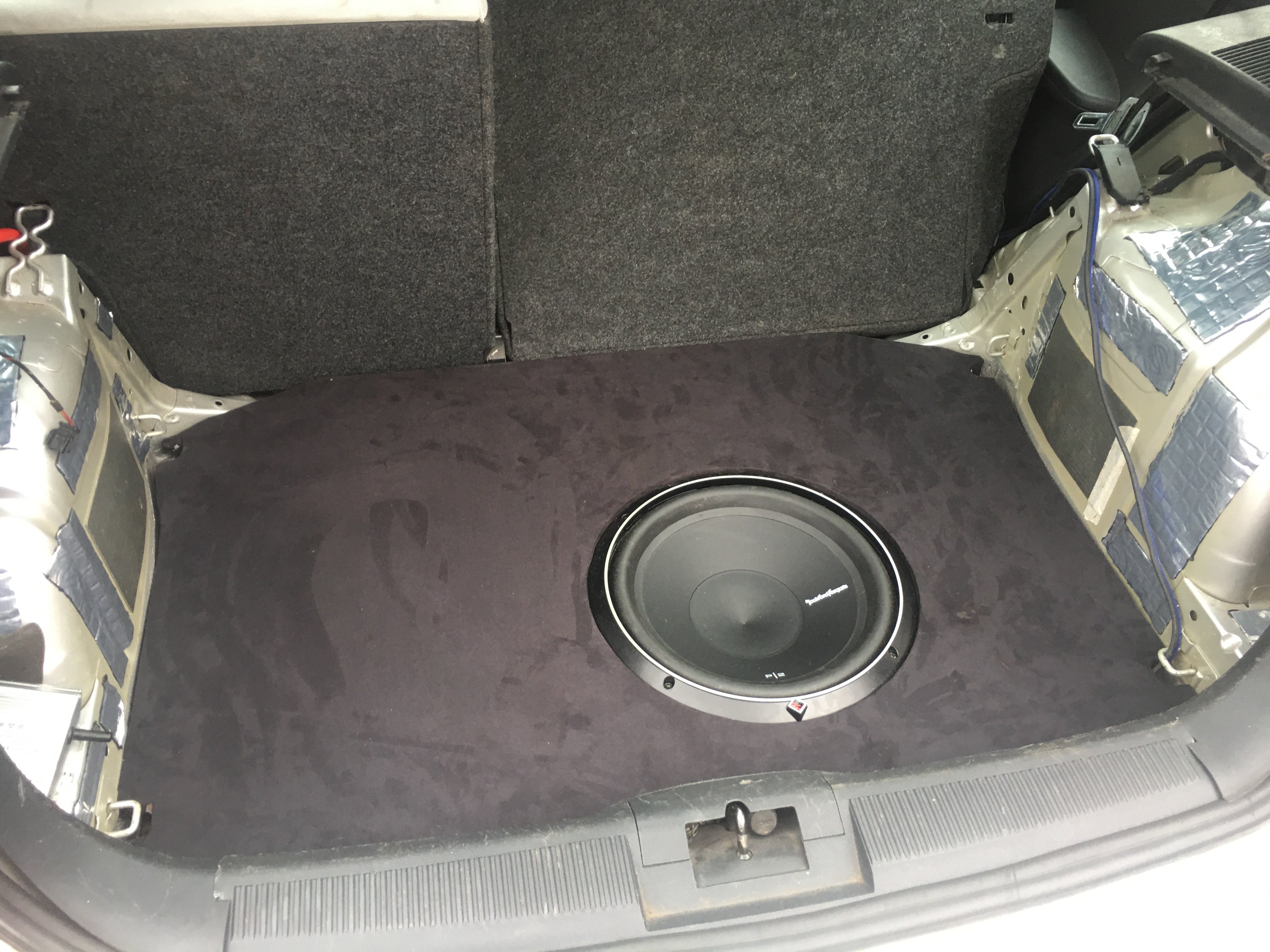

  12. I’ve been doing a bit of an audio overhaul in the Mk1 fabia VRS and recently installed a false floor with a subwoofer (which looks and sounds awesome) I am now looking to install some quality speakers at the front of the car (budget £250ish), and understand by reading through the forums that the maximum mounting depth is 62mm. I’m having a hard time finding a pair of speakers which will comfortably fit at the front and I was wondering if anyone on the forum has any advice as to what they opted for. As an example I’ve been looking at the JL C2-650 https://www.caraudiocentre.co.uk/product_m-jl-audio-c2-650_p-33119.htm

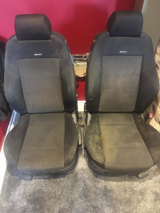

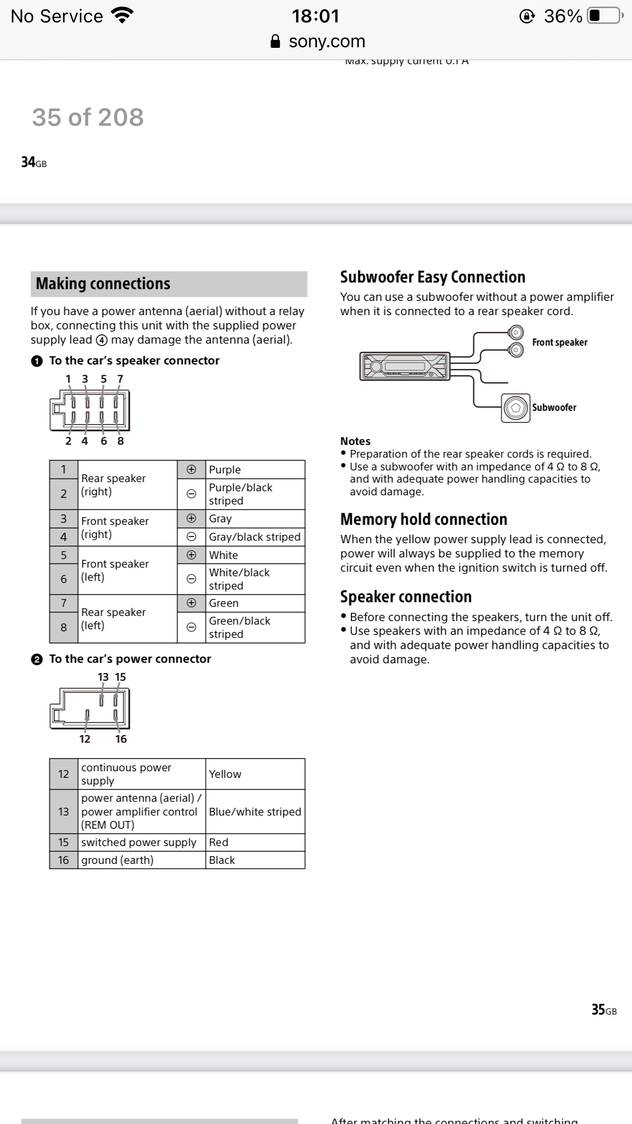

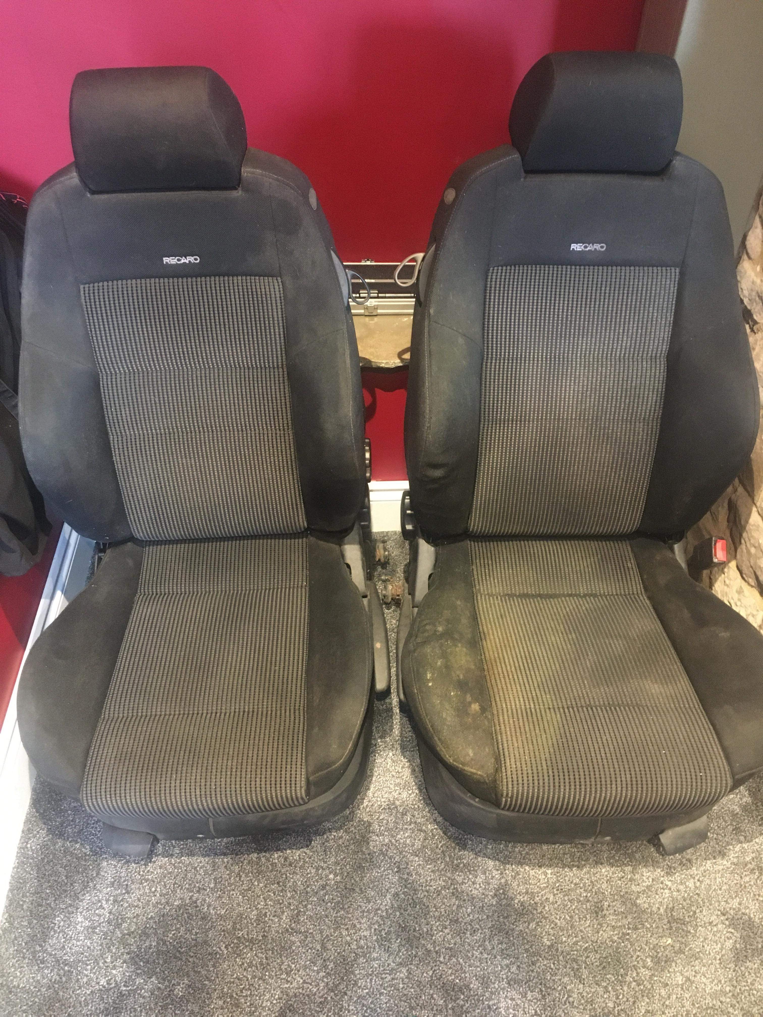

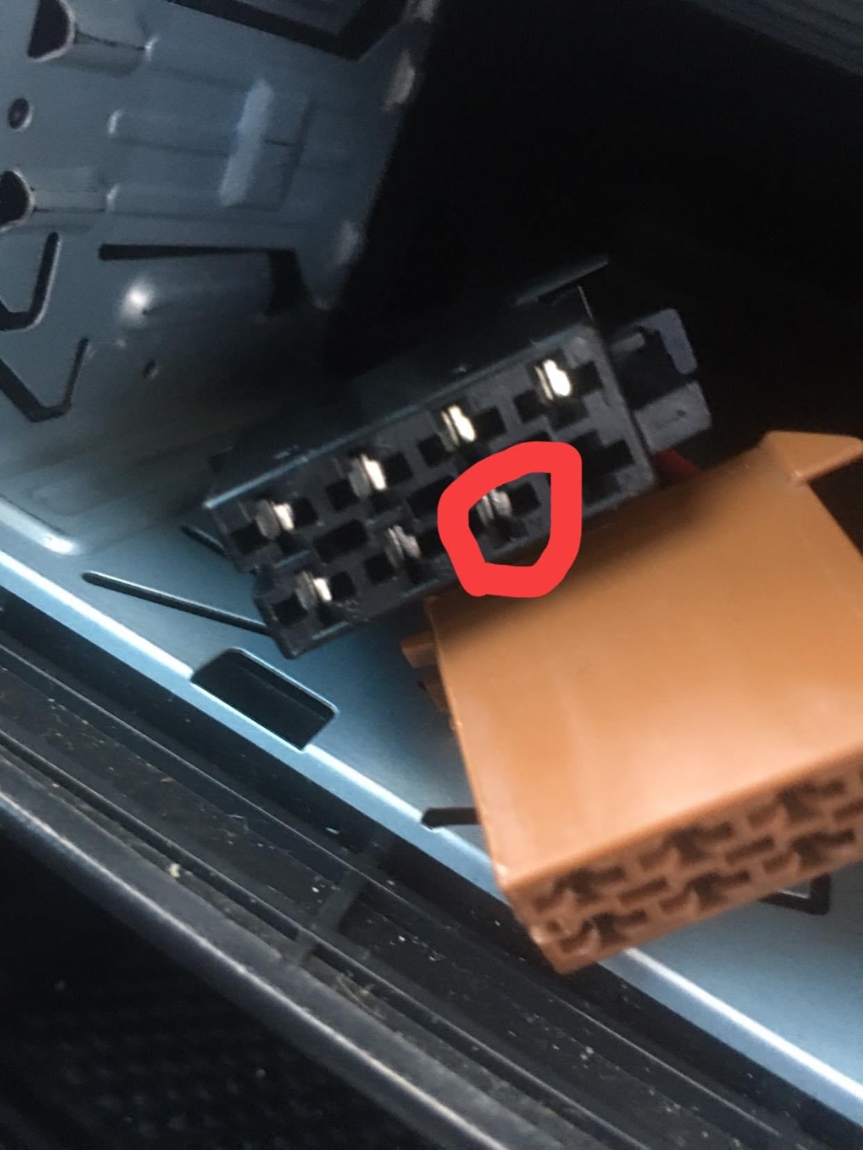

  13. I sorted the issue guys! Thanks for all your responses. I cut the blue white wire that is my REM out from the radio and attached my DAB wire to that which is all working now.
  14. Hi guys I’m a bit perplexed by the wiring layout from the Skoda fabia mk1 radio unit. I tried tapping into the blue and white wire for the REM turn on for my amp, alas I discovered with my handy voltmeter that it’s a constant 12v supply. I tested all the pins and it seems that there is only one pin available that switches on and off with the ignition? My understanding was this was an alternative 12v supply and not the REM wire out. Can I wire the powered dab aerial and amp together for this one terminal? I wanted to ideally keep them separate. thanks
