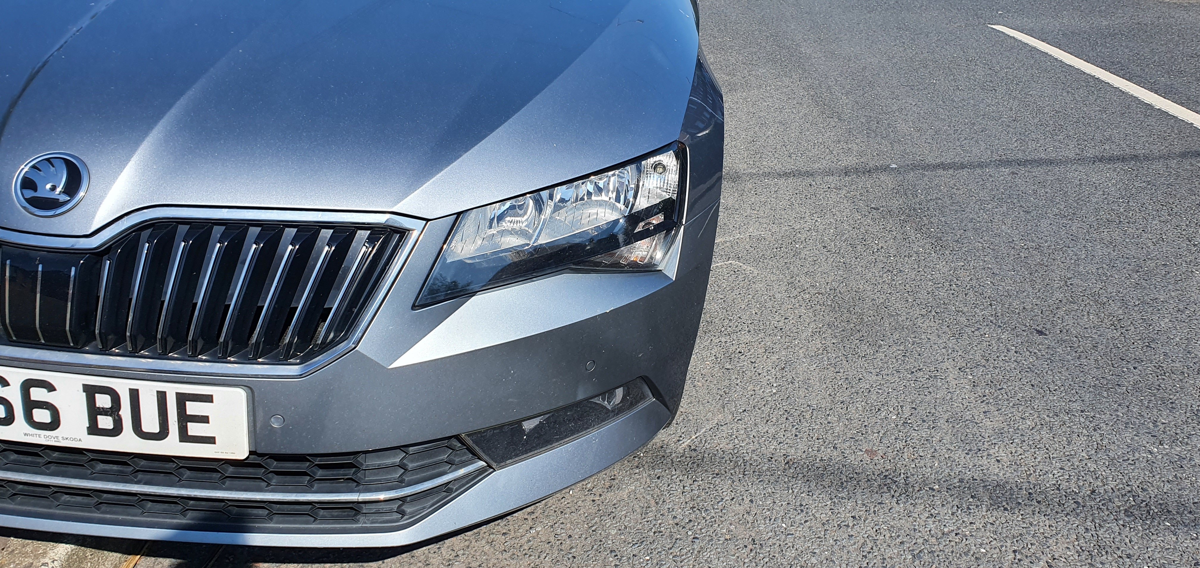

  8. Nice one.. really appreciate that. so i'm be hunting ebay and the likes for 3v1.941.015 and 3v1.941.016's then :-) this is great. The only other bit of tech is there is radar at the front, don't have lane assist-- just the distance alert that kicks in when on cruise control. Many thanks Varooom
  9. So does my car have this headlight capability as standard? Or am I potentially looking at temporarily firing on some eurolites to get me over there legally and swapping in new headlight units / fog-lights once there and before i get a french mot (control technique). Apologies for all the questions..
  10. I'm going to be shortly moving from the UK to France, and want to bring our 2017 Skoda Superb 3 estate over with us. I realise there is something we need to do with the headlights, i.e. get them pointing the opposite way to the UK but what I can work out is whether this car does it automatically based on GPS or am I dreaming I read this somewhere. The headlight units have a part number of 3V2.941.016 (1LJ 011.939-04) and are made by Hella in the Czech Rep.. As the car will be going over permanently I don't mind going through the hassle of replacing the headlight units if required so if anyone knew of the part numbers that I would need to get that would be great.
