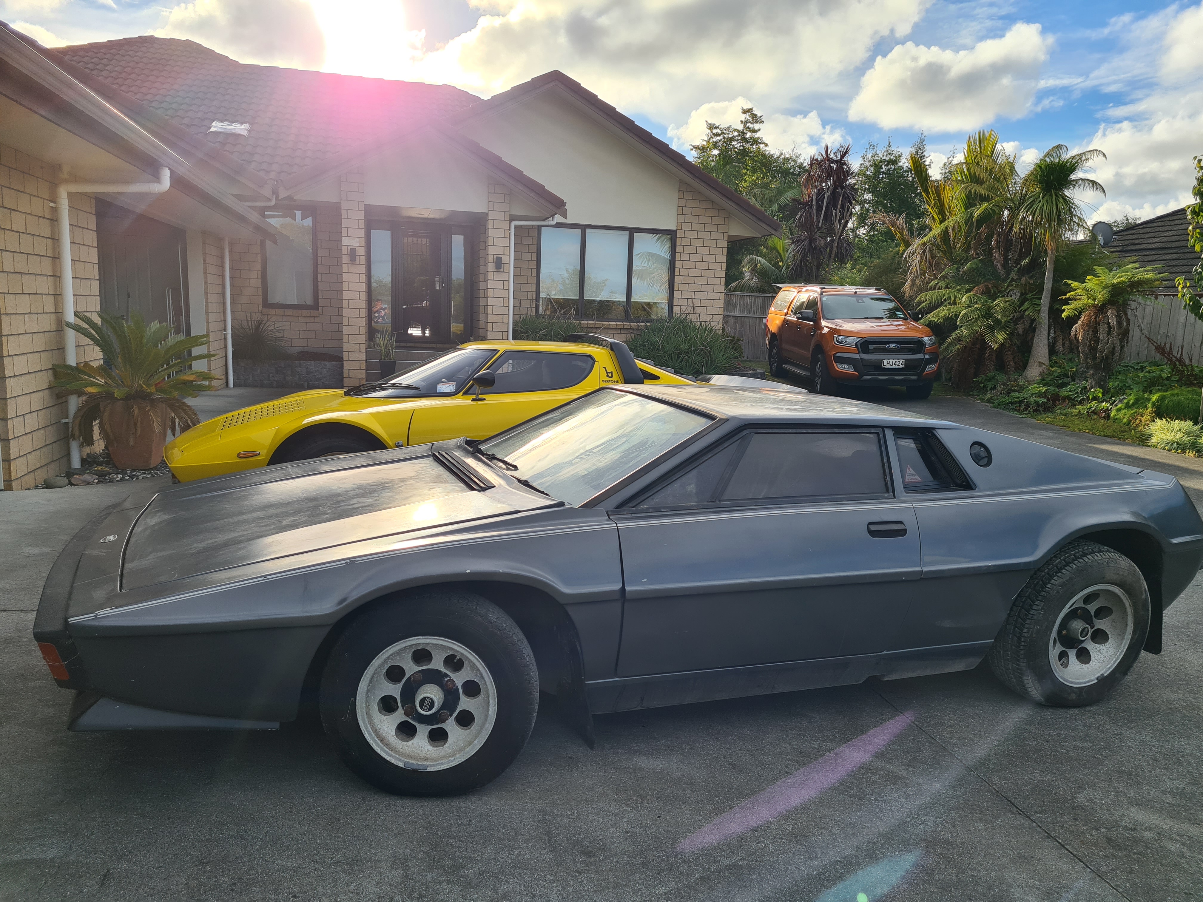

  2. Ok - I've been having a hunt on line but I haven't been able to find answers to the following questions - can any one help? Does the flywheel for the 190mm clutch have the same ring gear diameter as the flywheel wheel for the 180mm clutch.? Does the 190mm clutch plate have the same spline as the 180mm clutch?
  3. My understanding that it was more a "method" patent rather than the idea of composite monocoque
  4. The yellow car is a Lancia Stratos replica, the grey car is the Heron MJ1. They were not intended to be a Esprit replica but the styling was inspired by the Lotus (and other wedge shaped cars of the era). Fun fact - the Heron has a fully composite moncoque chassis, the process to make it was patented and later sold to Lotus, in some ways it's the ancestor of the Elise
  5. I'm an idiot, just remeasured the clutch plate, it's 180mm, but my question about changing it to 190mm still stands
