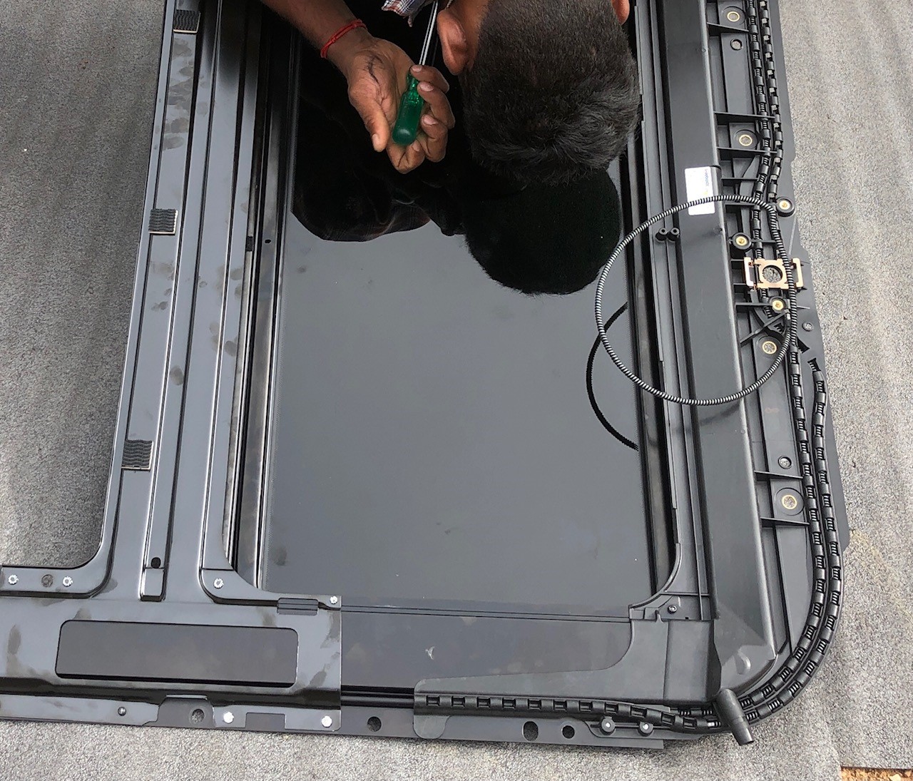

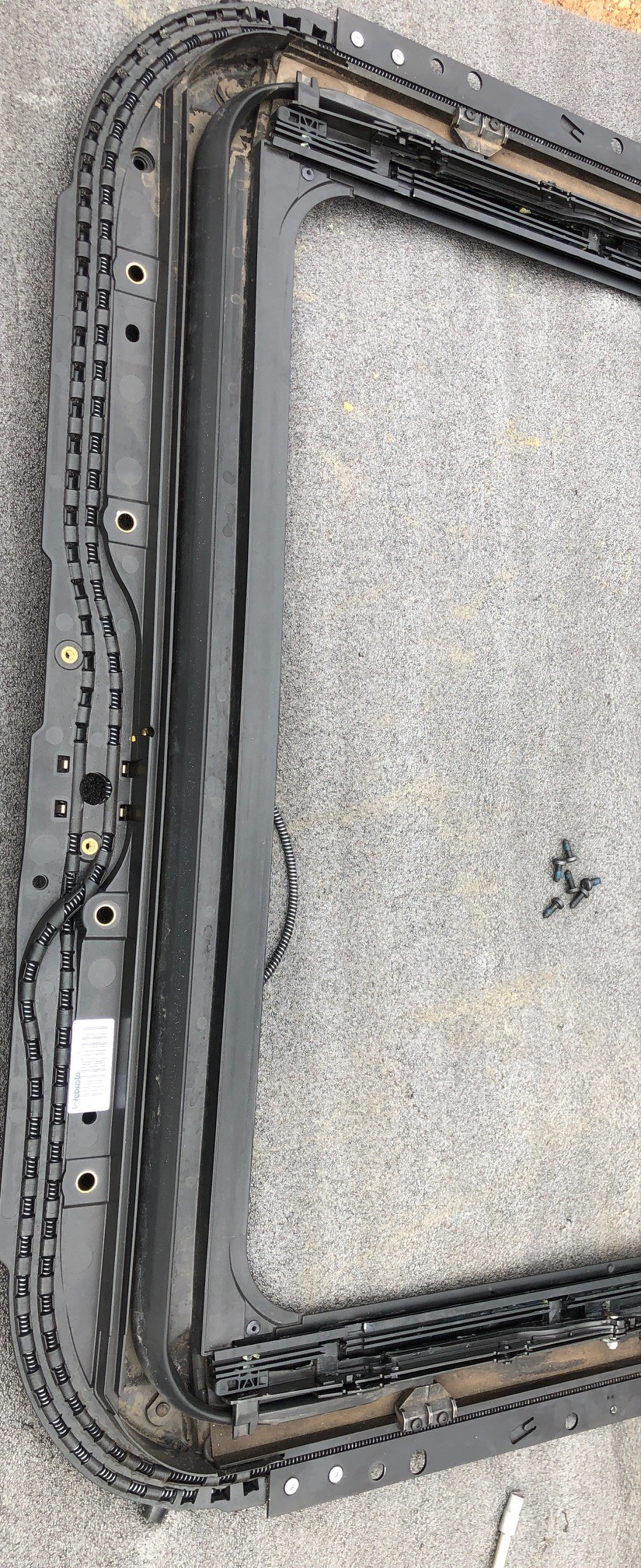

  1. Hello Friends All of a sudden my sunroof made such a cracking noise and stopped midway. It was raining and I used manual force and closed the opening. It was not perfect and allowing wind entry. Back home I found the worm cable out of the track (picture 1) and fixed the cable into the track and reset the roof with help from a headliner mechanic (picture 2) The motor is fine and also the cable moves into the track freely. I see no issues Now the roof is set and wind noise is reduced. I disconnected the motor fearing issues again. I am too afraid to use the roof again Any suggestions from the forum here ?
