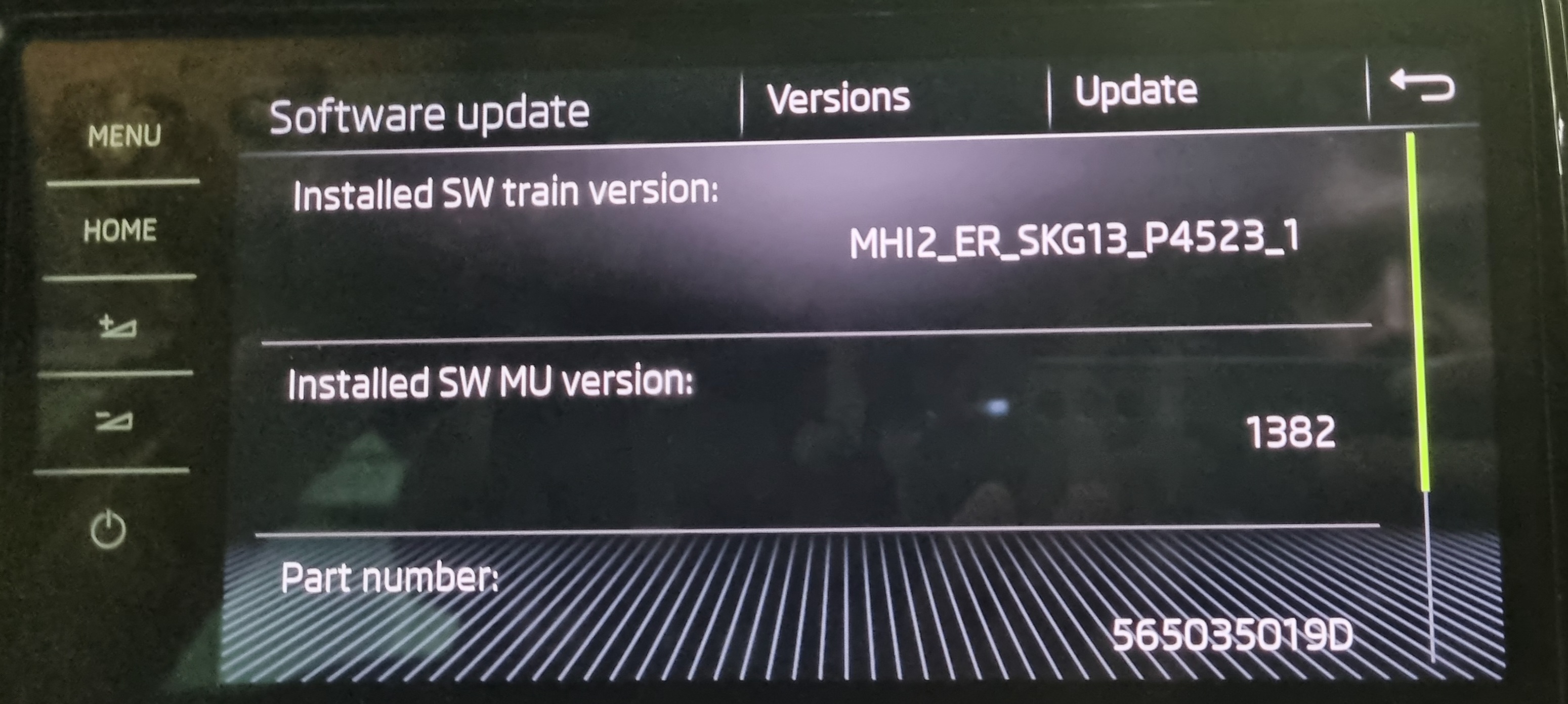

  6. Success! Ws able to flash the VW ROW 2024 using the System Information method. I had a look using the SWDL method but I wasn't able to unselect any of the options. Clicking on the green ticks didn''t change their status.

  8. I have been struggling to update my 2019 Kodiaq (Australia) with the maps downloaded from the Skoda portal HIGH12_P353_ROW_202345 I tried to manually update using the menu in System Information like I've done previously, but it would fail with an Error at 2% and the reboot. I then tried to update using the hidden Service menu and this time it got up to around 40% on the Thailand update and then failed and reset. This time it got stuck in a loop trying to apply the update which I managed to stop by holding the power button until it rebooted. Unfortunately now I have no maps and neither method will install the maps. Any ideas on what I can do next or am I stuck going back to the dealer?
