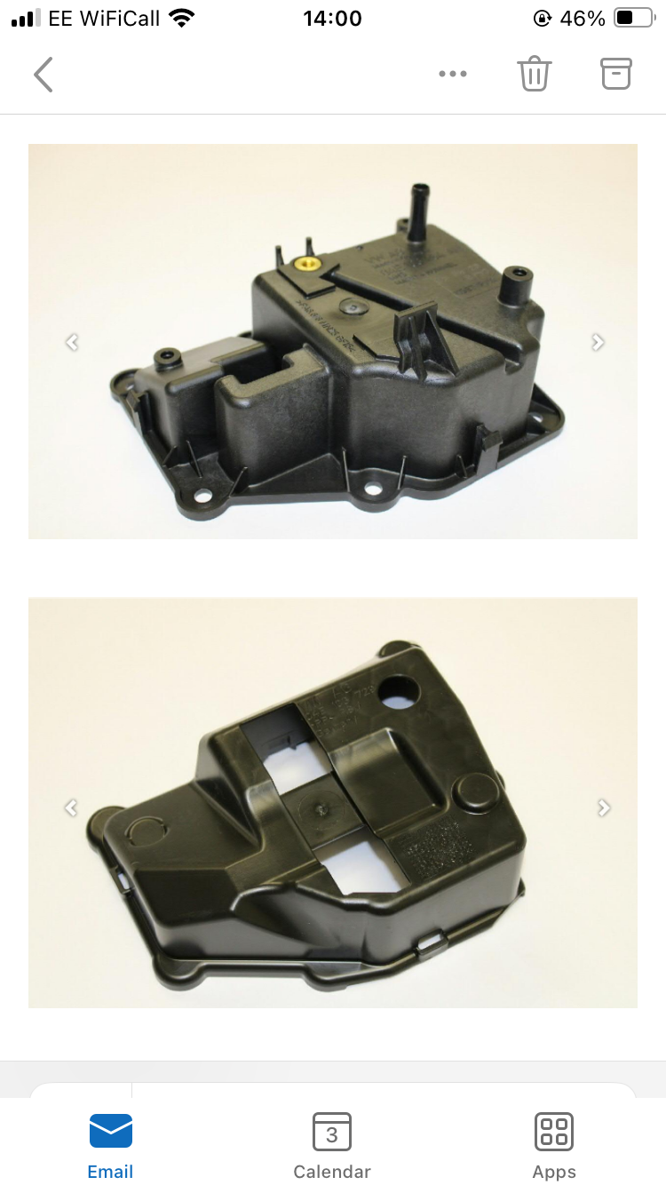

  3. Hi @netman82 thanks for your interest. Incidentally I’ve just got back from my local garage for a scan and happy to report it’s all fixed! The parts required were the crankcase breather/oil separator and its cover (04E103464AM & 04E103729, pictures attached). Got them both from Skoda direct for about £70 in total. The other part I listed that was on autodoc (https://www.autodoc.co.uk/bogap/18571281) turned out to not be for my car. As a complete non-mechanic I’m struggling to understand how two new bits of plastic have fixed the issues as the garage said there was no visible signs of damage on the old parts, but hey ho! Kind regards Ed
  4. Have had a conversation with a technician at Skoda who said the part number for that engine block breather valve is 04E103175. However he thinks the PCV valve actually sits on the side of the crankcase and which degrading of the valve is a common issue. These seem to also be called oil trap / crankcase breathers… https://www.autodoc.co.uk/bogap/18571281 The part numbers he quoted for those were 04E103464AM for the breather/oil separator and 04E103729 for the cover.
