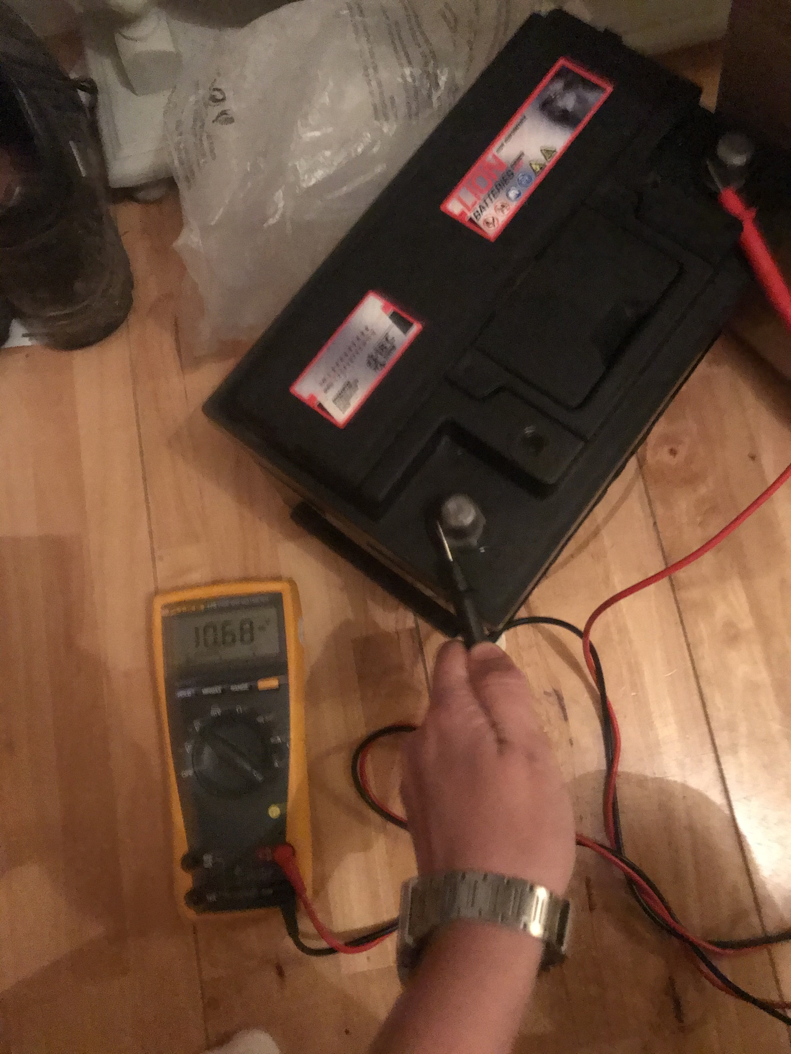

  4. Ok update. I think I’m still not getting the amp reading quite right. Probably slipping off the terminal( even with an assistant. ) as it reads 0.00 amps throughout and when I put the negative terminal back down the alarm goes off. I guess I’ll have one more go tomorrow. as for the ‘new’ battery I thought I’d do some testing out of the car. I charged it up this morning until the charger read full and read the voltage which was 13.12. Then measured it a few times throughout the day obviously got a quick drop after removing the charger as it settled down. And then by 10 hours later.l it had dropped to 10.68. Is that normally with nothing attached to the battery?

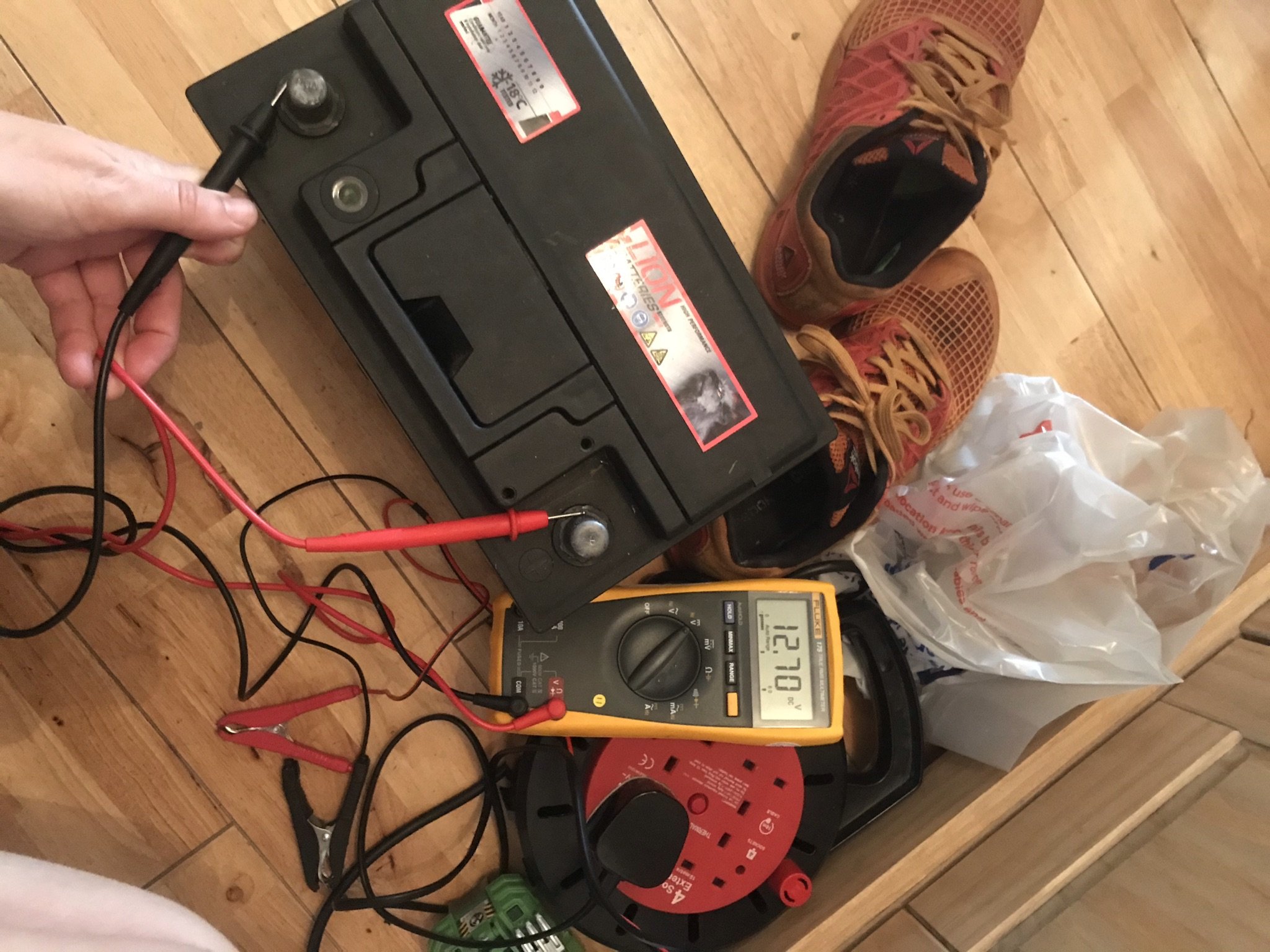

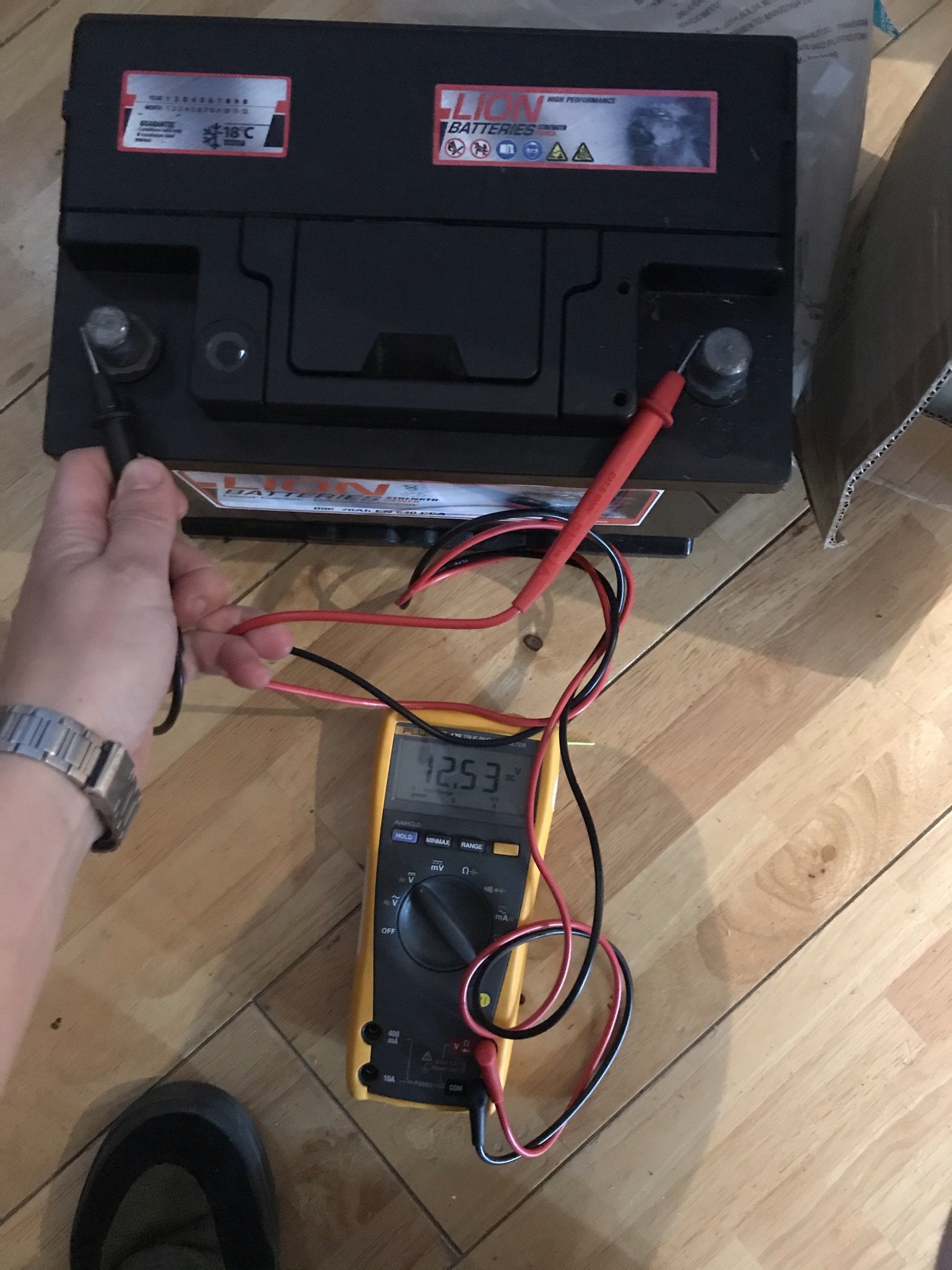

  7. Little update. Checked the battery (without the engine running) this morning at it was down slightly at 12.21V. Checked again after work and it was steady at about 12.20. @Wino I tried your parasitic current measurement but not sure I did it right. Locked up the car and locked down the bonnet with a screwdriver and left it for an hour and a half, then read. But the reading when detached was quite hard to work out as it was jumping all over the place. Not sure I did it correctly. It read 0.02mA before disconnection. See attached video! If it looks unsuccessful I'll try again tomorrow for a smoother technique. @KenONeillplugged the new battery into the charger today for half an hour or so - couldn't hear it bubbling or fizzing but perhaps it needs to be on longer for that to happen. Plan to try again tomorrow but was off out tonight and didn't want to leave it plugged in unattended. WhatsApp Video 2021-09-24 at 18.02.51 (1).mp4

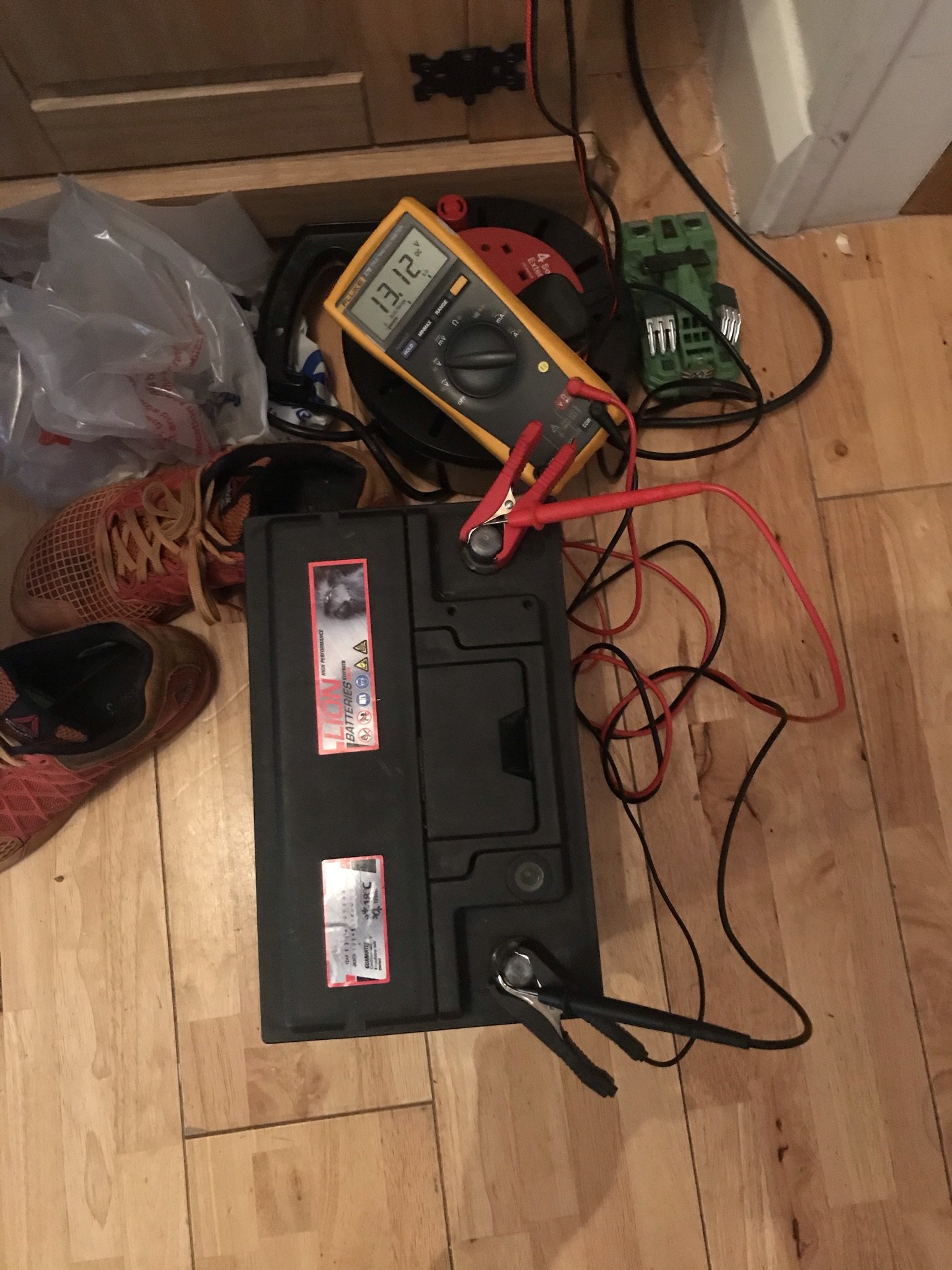

  13. OK good shout I'll try again over the weekend to charge the battery properly as I've never got to full charge before. Do you think there's a chance that the 'new' battery is a dud? I'll check the voltage on the old battery tomorrow and report back . In terms of finding a drain I would imagine I'd read the amps from the battery with nothing on (after leaving the car to sit) and take fuses out one and a time and see if the amperage drops? Thanks again for all the help!

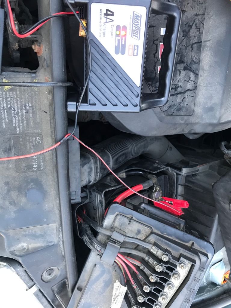

  14. Thanks Sepulchrave - I know it's very short. But have used this charger before during this issue and have been leaving the batteries to charge for 8+ hours and it's never given me a 'full' reading so far. I have only stopped charging after this amount of time in this instance because the charger is reading as fully charged. But if you guys thinks it's ok (and advisable) to leave it to keep charging I'm happy to take your advice and leave it longer 👍 no idea why this photo is right in the middle of the comment! Apologies.
