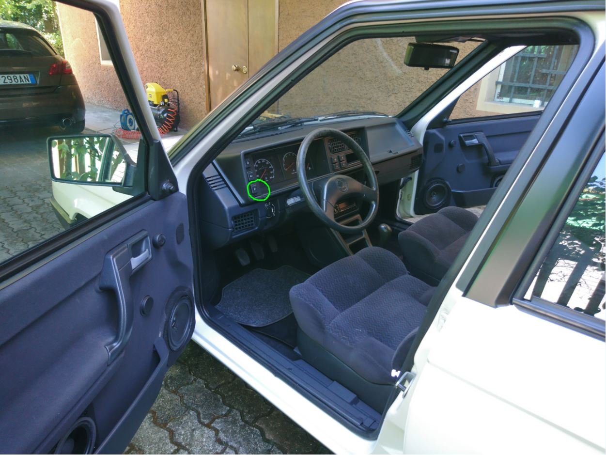

Well, thank you so much! Front grill with lights is an original Skoda accessory of that time. For what I know it has never been fitted as standard equipment on any model/version. I've found it somthing like 15 years ago on eBay and now I think it's very rare to find. They work as a second pair of fog lights, they can be turned on once the main lights are turned on too. The switch is located under the main light's one (I've marked it in green). P.S. Don't look at the mold on the steering wheel π I took that pic after 12 years that the car was locked in a box and never opened. Now she's clean again! π
