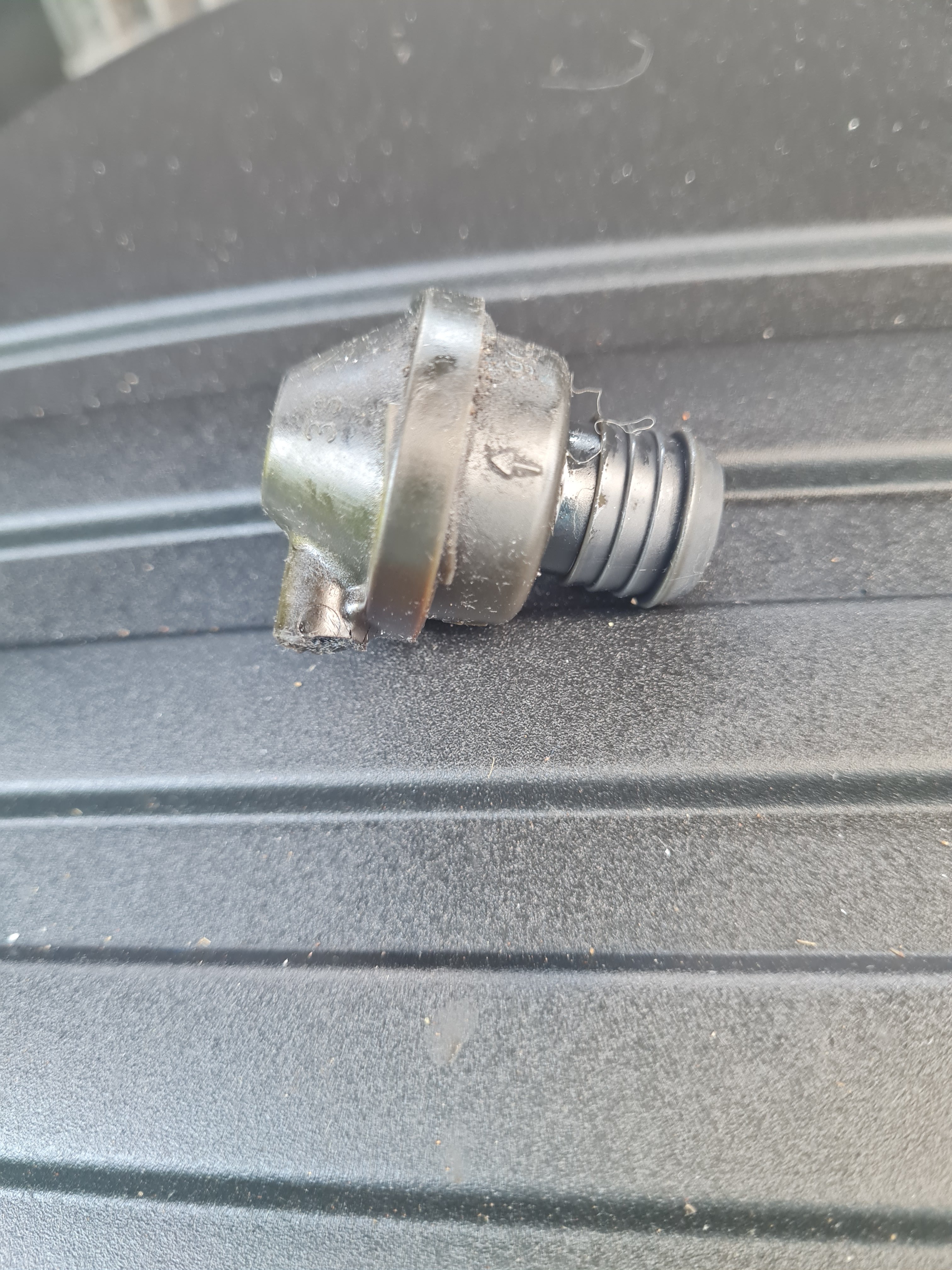

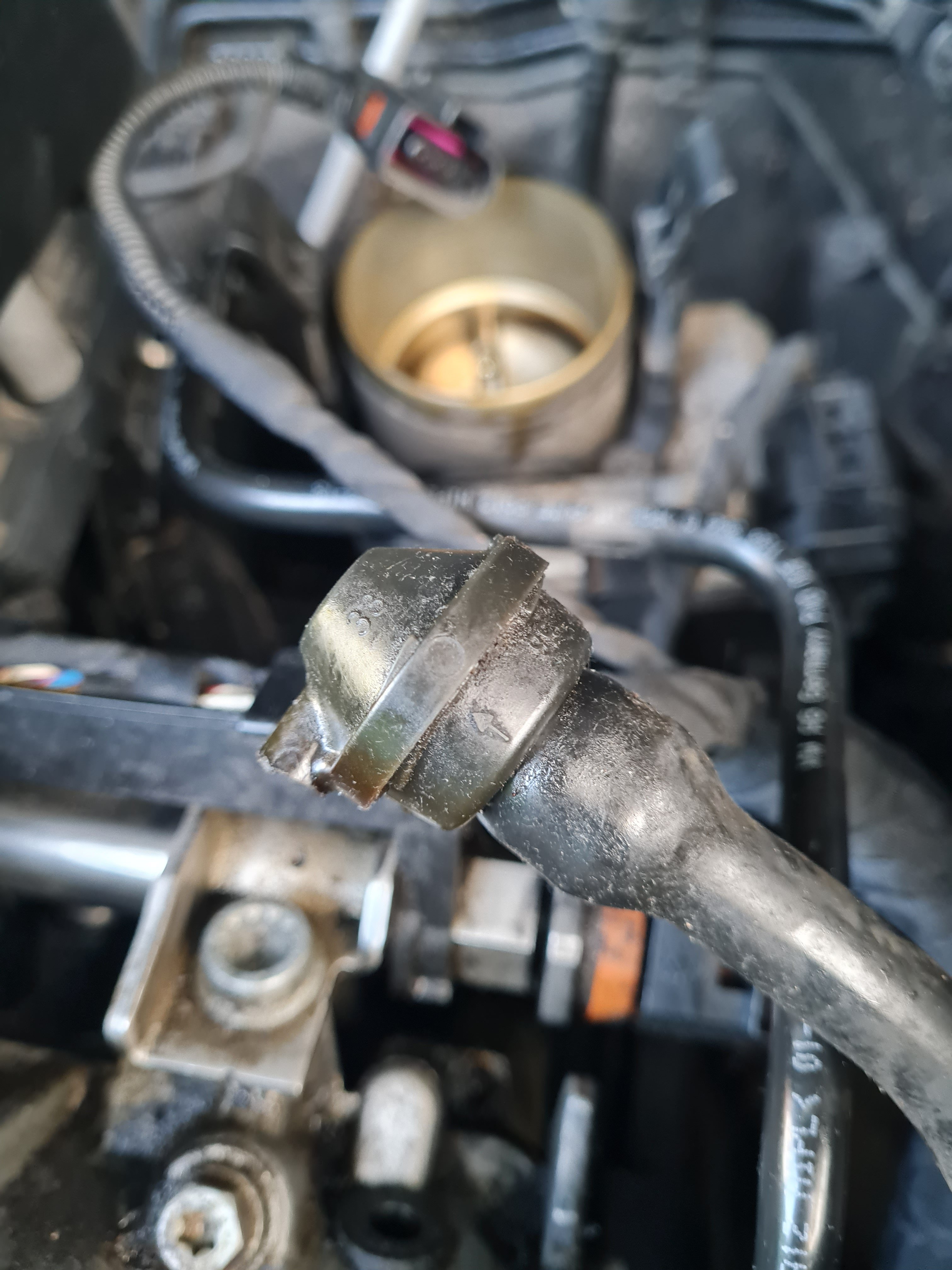

  1. Hi, after a closer look it is a you said a broken PCV valve. One is on order so hopefully it will be all fixed tomorrow. Thanks for all of your help.

  4. Hi, My wife's 2014 fabia 1.2 tsi has recently started to smell of fuel in the cabin but only after I stop at say some traffic lights for a few seconds. It also smells when I open the bonnet but this quickly goes. I can't see any obvious signs of leaks but let's be honest I wouldn't know where to look. The fuel cap is tight so I'm sure it's in the engine bay. Any ideas as to what it could be would be much appreciated.
