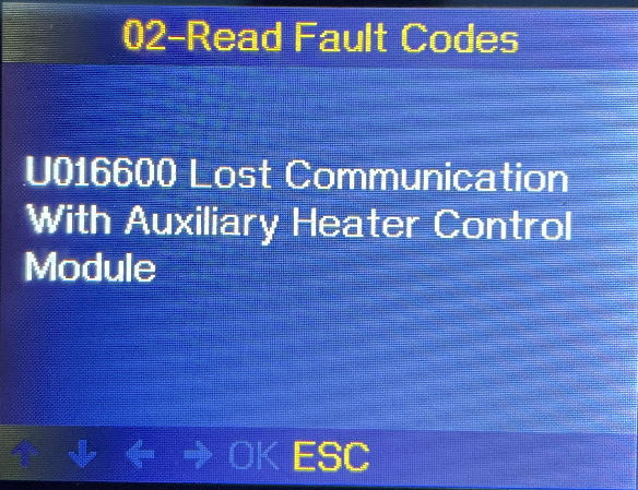

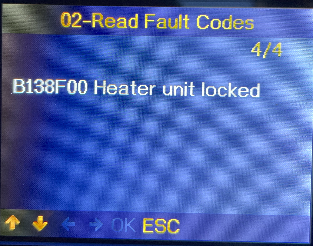

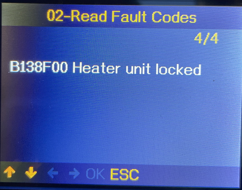

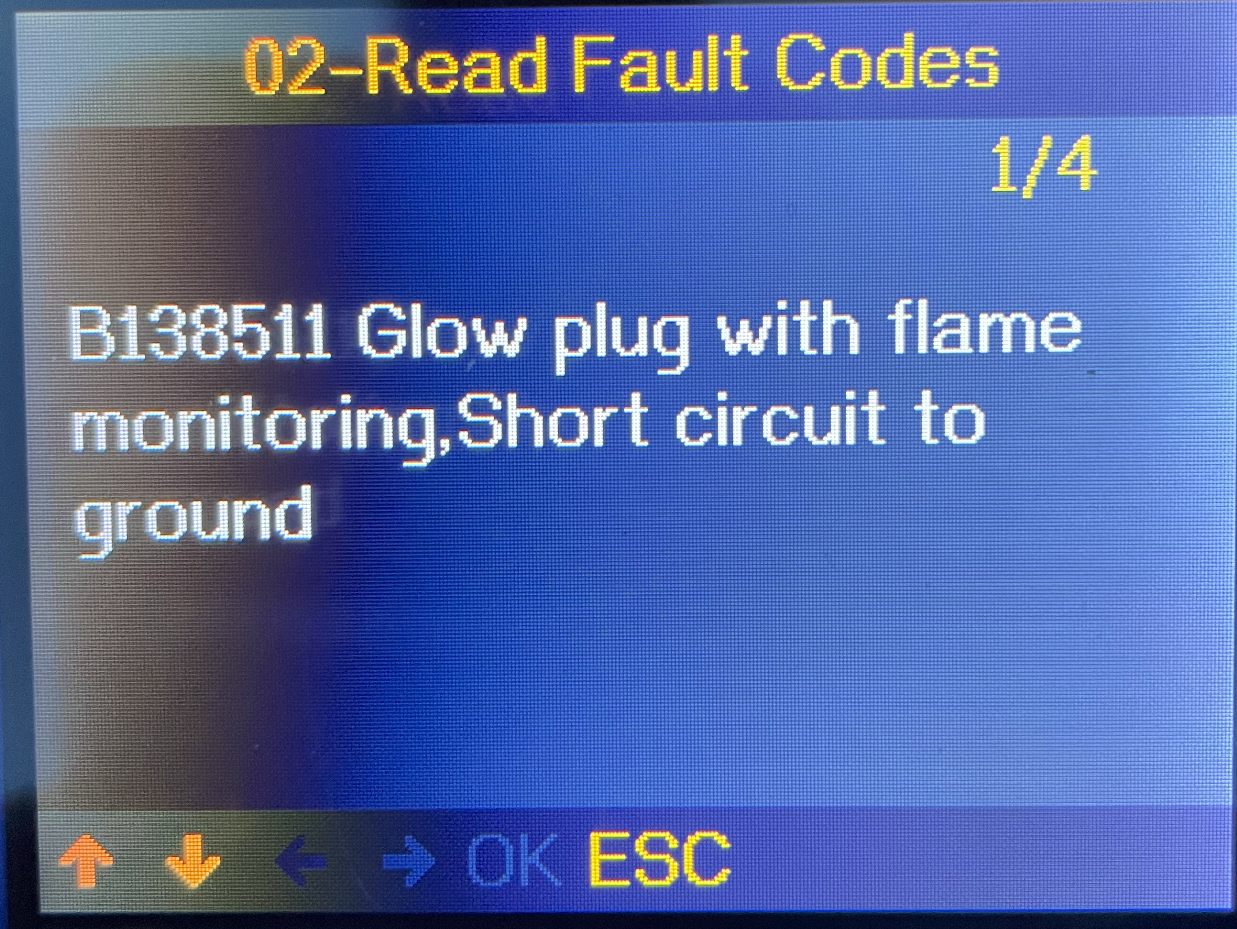

  1. Hi guys, thanks for these tips, I got myself a diagnosis tool and these are the fault codes I get. Any ideas how to fix this?
  2. Hi everyone, I have a question, my webasto stopped working. If I use the remote it first lights up an orange light (low battery) and then fast green blinking light. If I press the webasto button in the car on the dashboard it lights up orange for a couple of seconds and then it turns off and nothing happens. Any suggestions what it could be? I live in Norway so I would love if it would be possible to fix this by myself instead of spending a fortune in a shop. Thanks!

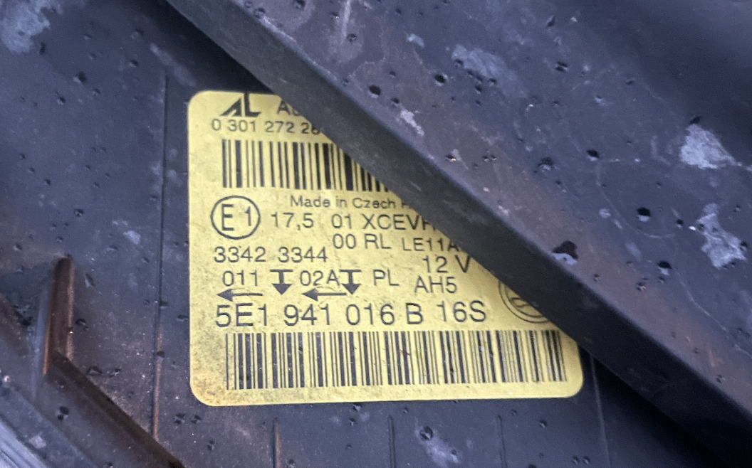

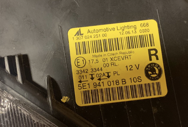

  3. Yes the one I am trying to buy has both, the light and the control unit. Do the numbers have to mach completely? Below you can see my light (left) and the one I am thinking of buying. So I guess this is not a match?
  4. Hi guys, LED strip on my right headlight stopped working with an error message of "check right daytime running light". I am thinking of buying a new (used one) and now I am wondering if it is possible to buy the wrong model? I am looking at Octavia MK III bi-xenon lights, but I am not sure if there is more possible options? I have Ambition model, and the lights do turn when I turn the steering wheel. How to be sure I am buying the right one? I would really appreciate some help, thanks!
