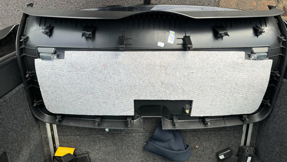

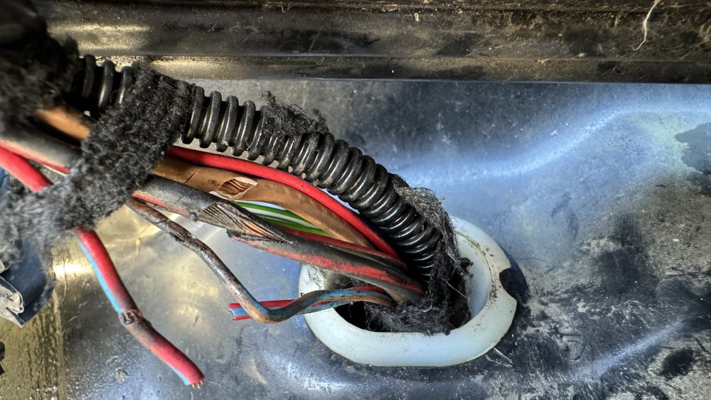

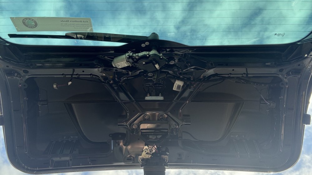

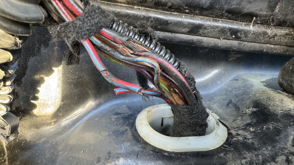

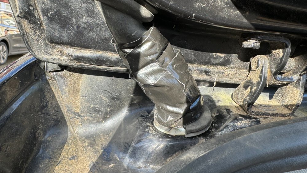

  3. Recently the manual tailgate on our Skoda Superb Mkii 2010 - 2015 stopped working. It would not release from pressing the boot switch and would not respond to either of the key fobs. All other functions (lights, wipers etc were ok). Unfortunately this model does not have an internal release so we’ve been forced to access/use the boot via the cabin. Skoda main dealer investigated for 1hr for £79 and concluded it could be multiple issues and would require further investigation for £274 (although if it were the motor that would include the fix) and to be fair only £130 was charged as fault found quite quickly. During that investigation they found the wiring in the tailgate to body to be damaged. Normally a new wiring loom is recommended but due to be the situation in Ukraine these are no longer available. Wiring repair was quoted at £479. Having seen the cut wire and (seen a colleagues similar repair) I decided to try myself. Bought a trim removal kit from Amazon for £20 and crawled inside the boot. Skoda’s photo and conversation confirmed that they had managed to open the boot. Using the metal pronged tool the tailgate trim was removed relatively easily - note the two internal tailgate lights will need disconnecting prior to final trim removal. Boot then opens easily upon moving the white catch lever. Skodas photo confirmed the wiring issue to be in the near side rubber convoluted tubing. I unsnapped the top and bottom white plugs and unhooked top and bottom tubing. I then cut 7/8ths of the rubber tubing inorder to gain access to the wires. Placing a heat shrink tube on one end of the cut wire I then soldered the broken wire together and then heat shrinked over the join. Temporarily raising the rubber tubing I closed the boot and confirmed it now worked. Opening the boot I then proceeded to wrap insulation tape around each of the damaged wires. I have then Gorilla taped the rubber tubing ( although I will probably see if I can get some rubber glue ( and then reseal with tape). Replacement of the trim was difficult ( and it’s definitely not perfect but it appears to be stable enough for normal use) In conclusion there appears to be a serious product defect in the wiring connection between tailgate and body and looking at other posts not just limited to the Superb or indeed Skodas. incase it helps anyone I offer up my photos of the wiring damage, tailgate interior and tailgate trim
