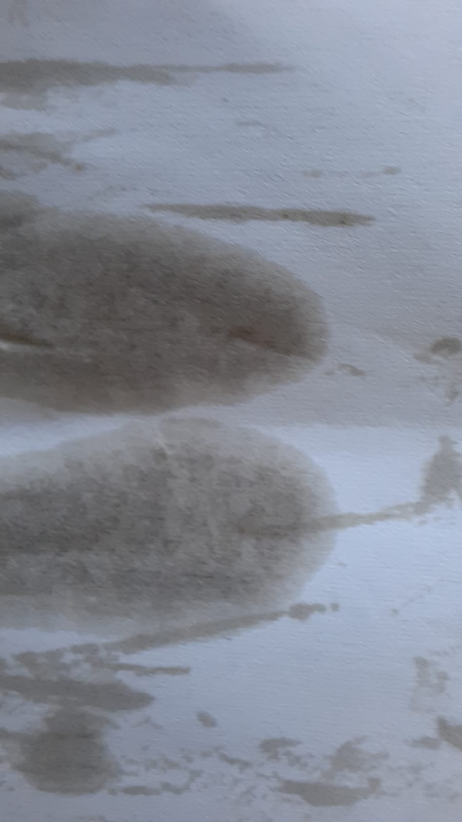

  1. Thank you, very useful advice. I checked online, and looks like the way to check for diesel in oil is to wipe the dipping stick on some paper, and if there is a differently shaded circle around the central circle, then there is diesel in the oil. I'm afraid if this methodology is true, then this confirms your suspicion - looks like there is diesel in the oil. I guess the best course of action now is to stop driving the car until the oil change to avoid wear of the engine. Is there a serious underlying mechanical issue, or can this be caused by eg. reckless driving style?

  5. Just reuploading the image in a better resolution and embeddable format:
