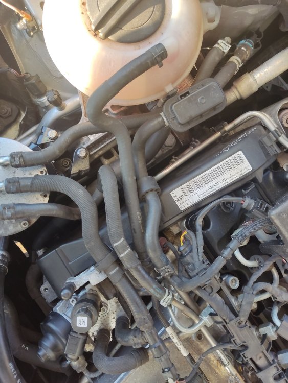

  1. There are three hoses in the filter, back line goes straight to tank. I have talked to some people about my problem, and all of them say that metal shavings (flakes) from HP pump should be very small, mine are big and not many, like from drilling of some sort. As I do not know what has been done with the car as I have it for half year, for now I will be putting secondary filter on fuel line and will check how the situation is going. It is just to see if there are new metal rubbish or not, and at the same time I will not have to take fuel filter out every time.

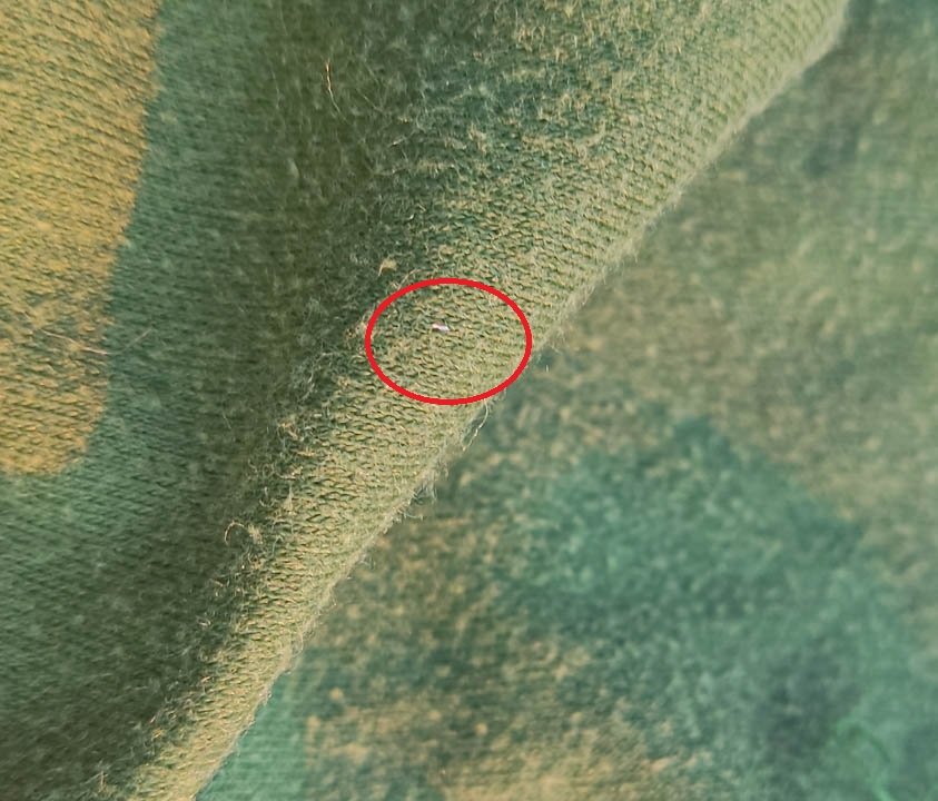

  3. Hey, all screws looks good and tightens as should (But I have not inspected holes for screws). Today I rechecked my fuel filter, all seemed clean. Nothing on filter itself from top or sides. When gave some light into fuel it kinda seemed there are some metal at the bottom, but it could be shining metal from filter housing. All fuel sucked from filter reservoir was clean, but when I cleaned with cloth I noticed one more metal shaving, which do not react to magnet. (added photo). It is kinda big again. I was researching this problem and shavings from HPFP should be more like sand grains (even smaller), so mine metal in fuel kinda does not make any sense. Last time shavings on cloth was even more bigger. I have also lifted pressure sensor from HPFP, all clean there. I have also found mine first fuel from filter reservoir, I have poured it into glass jar. There are some rubbish and maybe couple little metal shavings when I shake it, but it can be air bubbles, it is very hard to judge. When all rubbish sits on bottom I do not see metal, but I had to little time to look at it from different perspectives. I wanted to look at fuel tank, but can not lift back seat, and do not what to brake it. I was ready to change HPFP, but now I do not know if it is really needed. Guys from Poland sells these Bosch CP4 pumps for 400+. They say it is new, but I think they are renewed, anyway better then used. P.S. After recheck added new filter and primed the system with VCDS
