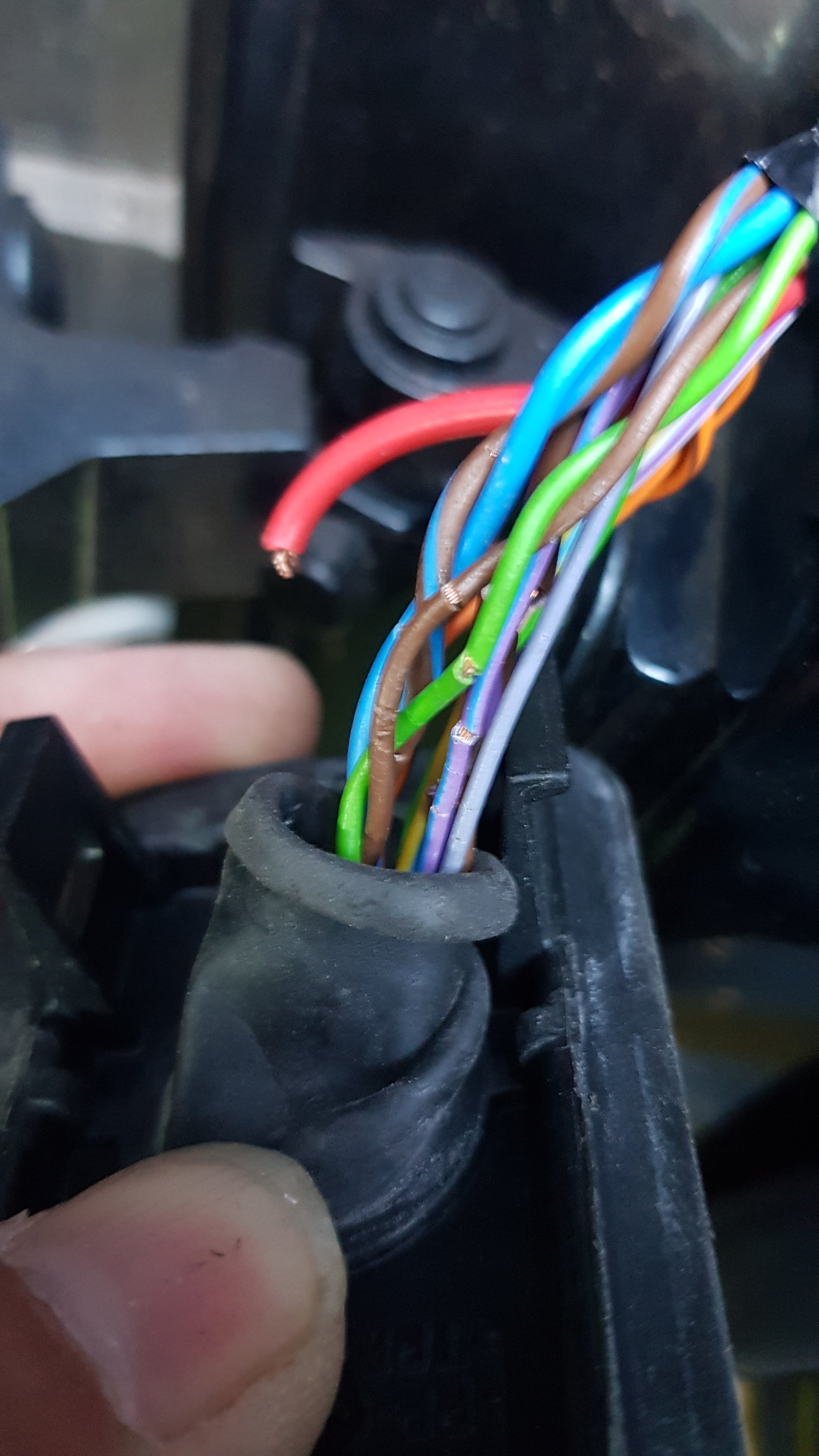

  1. Soldered them up. I was confused as to why it affected other door, but all sorted now.
  2. Hi All, As above, rear door will not unlock and drivers door will only unlock with a key. central locking button in drivers door wont work and mirrors not operating. ( passender door locking button operates but only passenger side. ) I have noticed over last month or so I kept having to reset the auto window on the drivers side too, but not passenger. Auto mirror retract by key also stopped working. I suspected broken loom to front door, but would this affect the rear too? could it be a broken earth and if so where to look for it? Any advice gratefully received. Regards Paul
