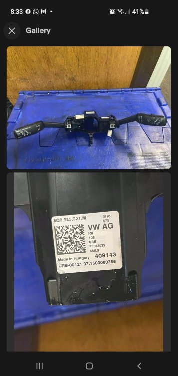

  6. Hi i have a 2014 octavia mk3 dsg want to fit cruise control to it but not sure what is needed, i have purchased the stalks already image attached. any help would be really appreciated. Thank you
