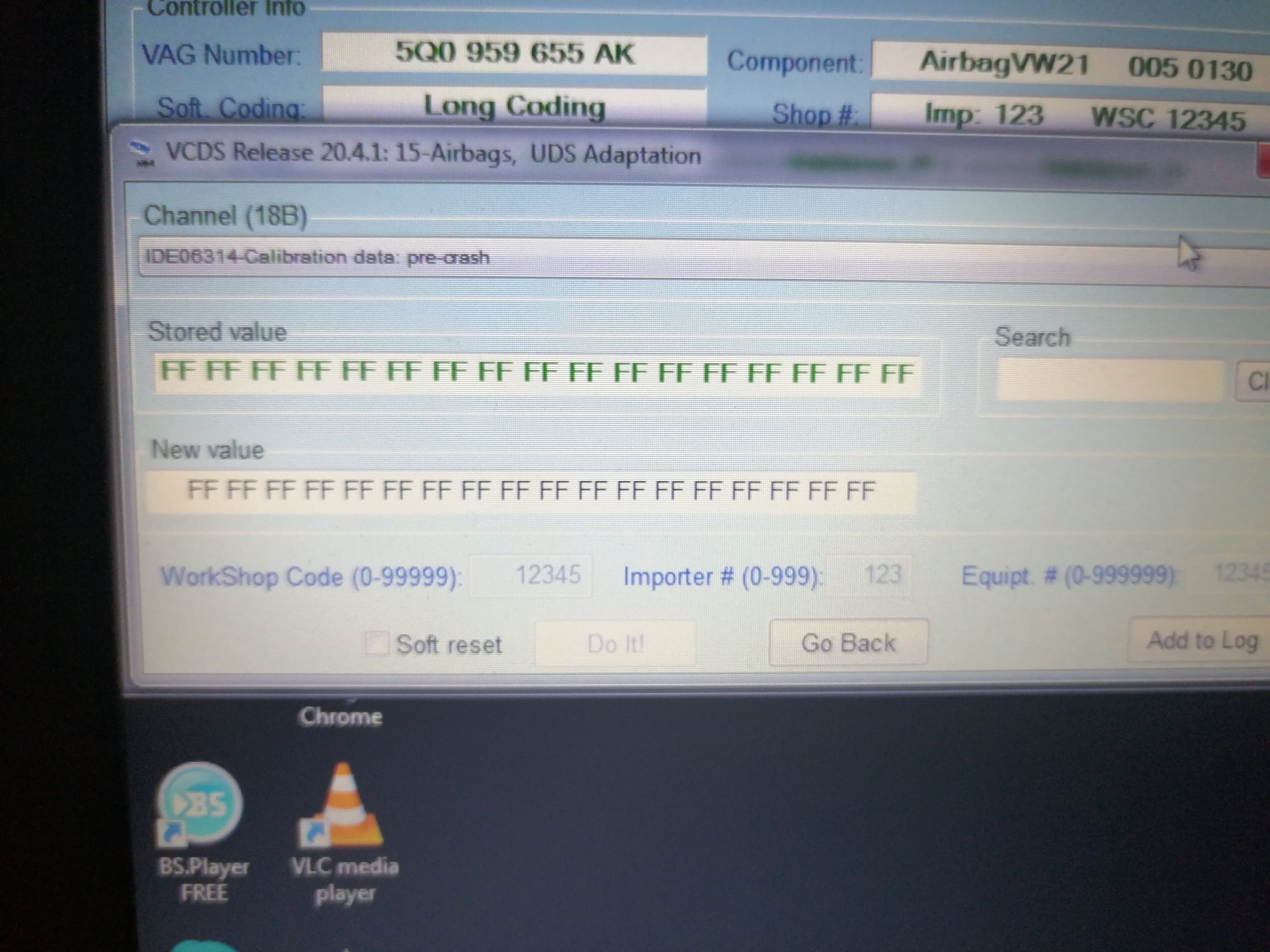

  1. yes, I bought it new parts from allegro Poland Coding and protection of components are made over odis-vas
  2. Does anybody have 5Q0959655AK airbag control unit to read me the whole configuration and coding In official vw/skoda service mention that AK is not available anymore(from March 2021)alternative is a new modul with letter BS at the end so,new software is done!
  3. Original airbag modul just stopped to work,no crash,nothing,airbag light on then I checked 26 errors,so then I bought new one(not in vw/skoda workshop),put code like in old one,remove component protection and one error stayed that pre crash not configured! really strange situations 😞
  4. Hi! I have some problem in airbag control module 5Q0955655AK I have no accident, the signal light on dashboard light, On vcds scan write: 1 Fault Found: 10493696 - Pre-Crash Not Configured B201F 00 [137] - - MIL ON - Confirmed - Tested Since Memory Clear I also visited vw/skoda official repair shop, and they could not configurated,they want to sell a new module Does anybody know what code should I write ,for sure is not FF FF FF FF.........FF FF ??? Thanks in advance Log-TMBAH7NP2H7018885-156902km-97494mi.txt
