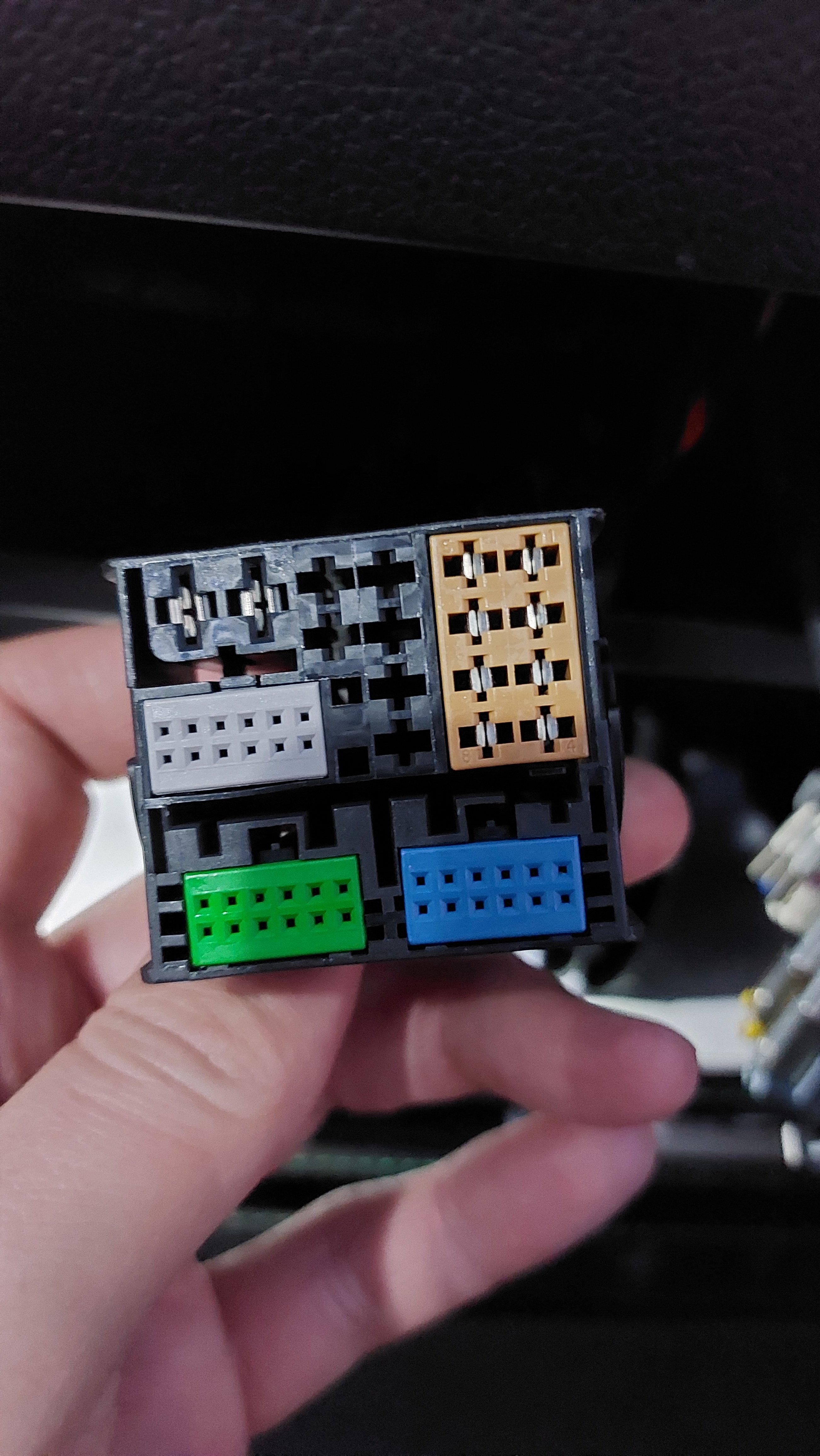

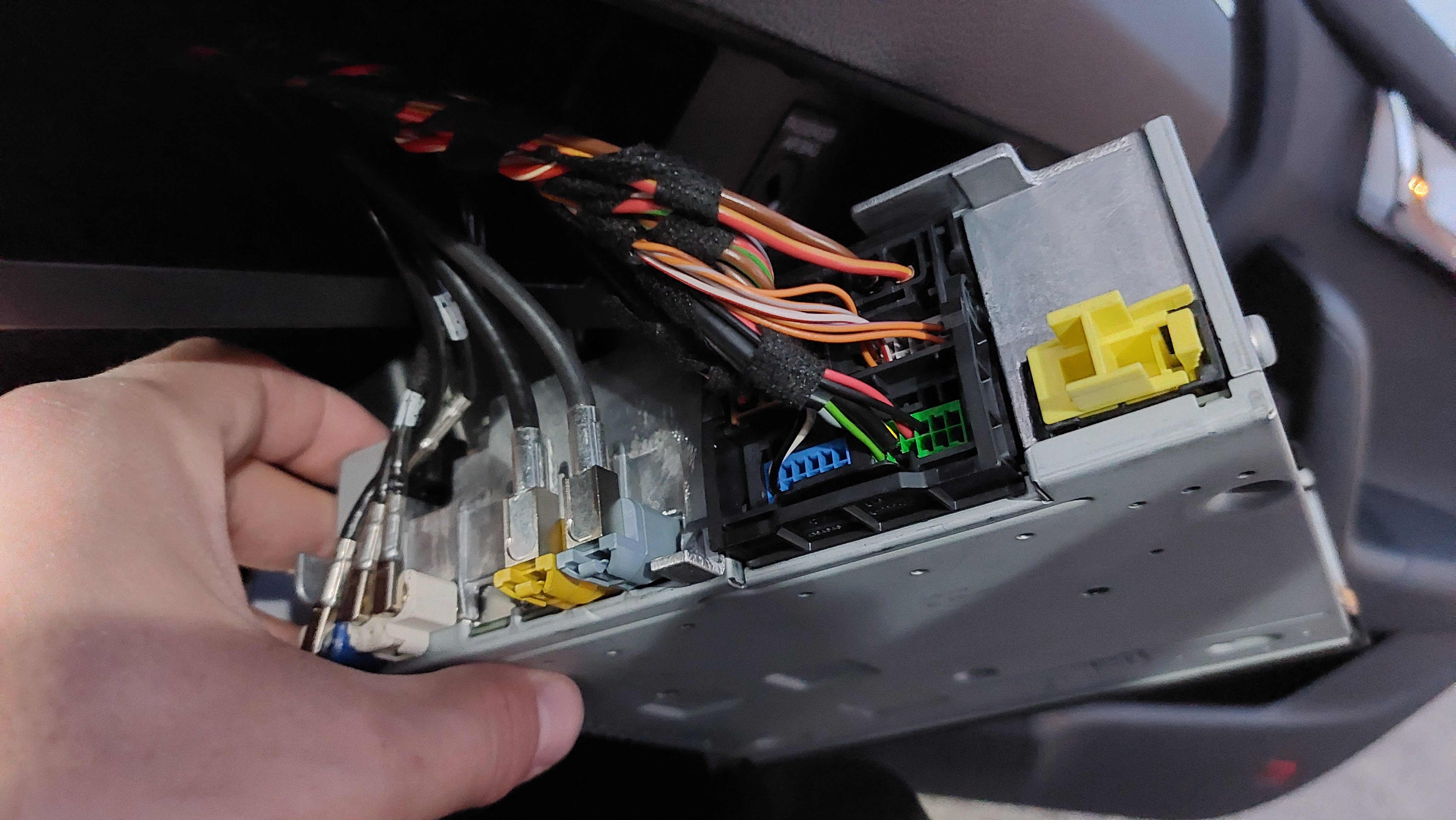

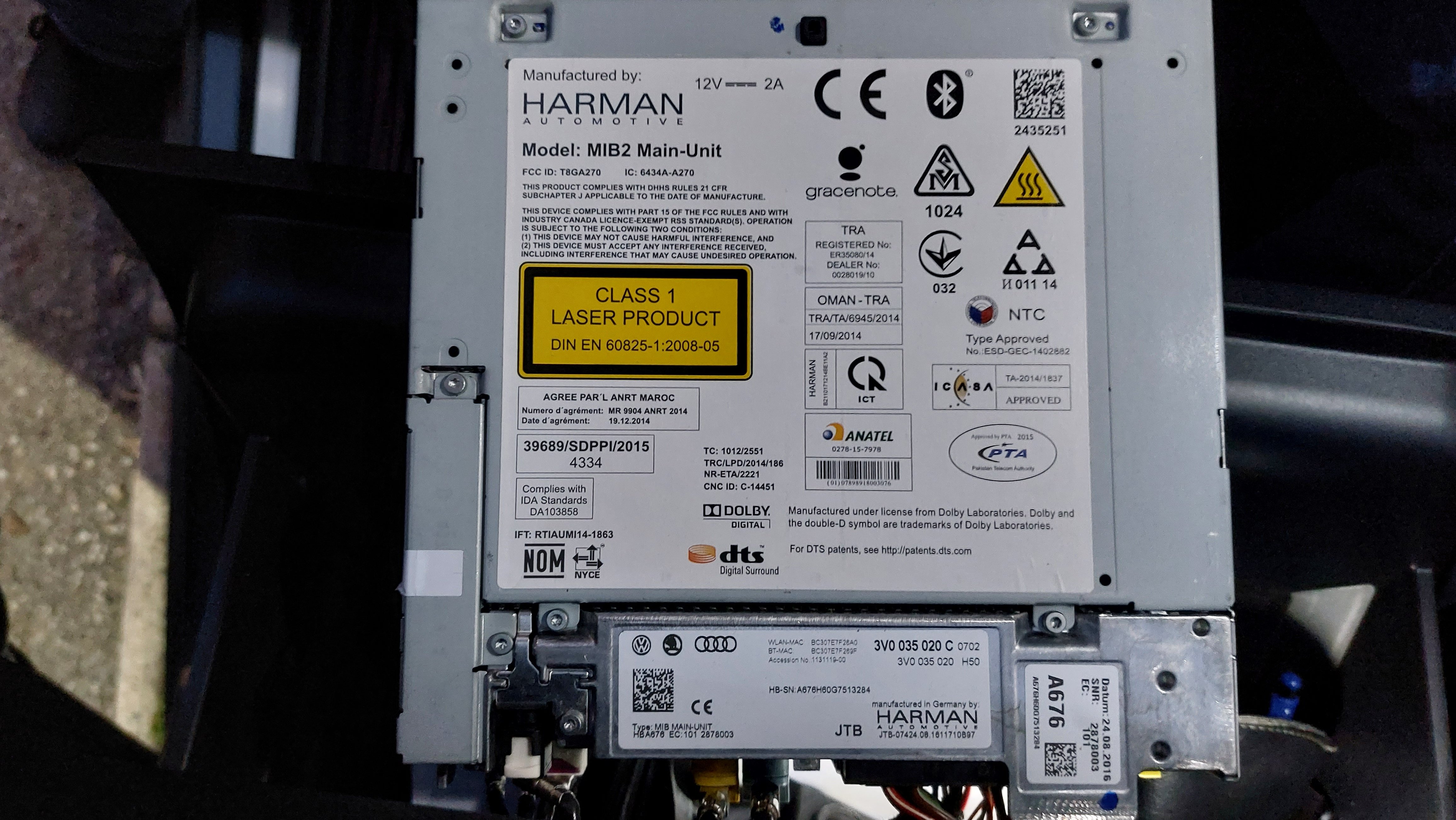

  1. Hi, first sorry If this is answered, I tried to find answer but I'm not sure if the posts apply to my case... I have Octavia MK3 2016 estate (model 2017 - left hand drive) with MIB2 Columbus infotainment system. I want to retrofit the rear camera and found one (model A) on aliexpress but the seller is not sure if the camera will work with my infotainment. Can anybody know will this camera fit my car or the exact model of rear camera that will fit my car? Connector: infotainment model: Rear Panel of MIB2: Posts regarding my case: post 1 post 2 Thank you! Regards svet0
