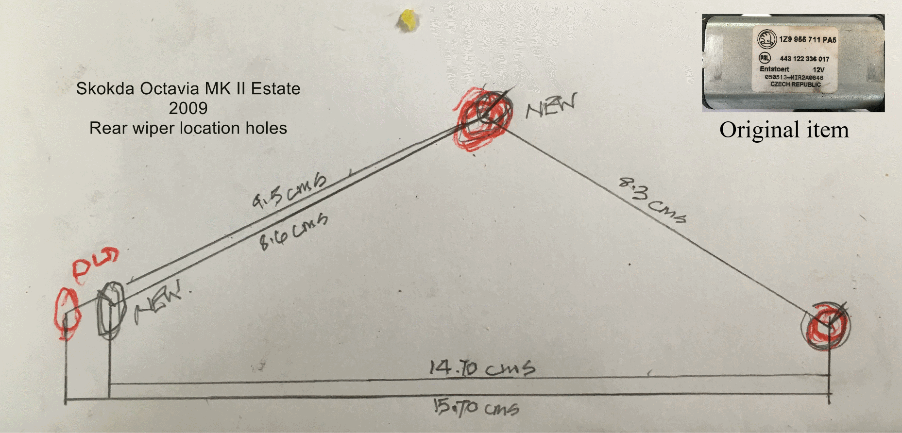

  3. This has become an ongoing saga because the replacement item had (It's been returned) a different screw hole alignment. Looking at the comments above maybe I should by a replacement and replace the guts.

  5. Thank you, Morph. Much appreciated.
