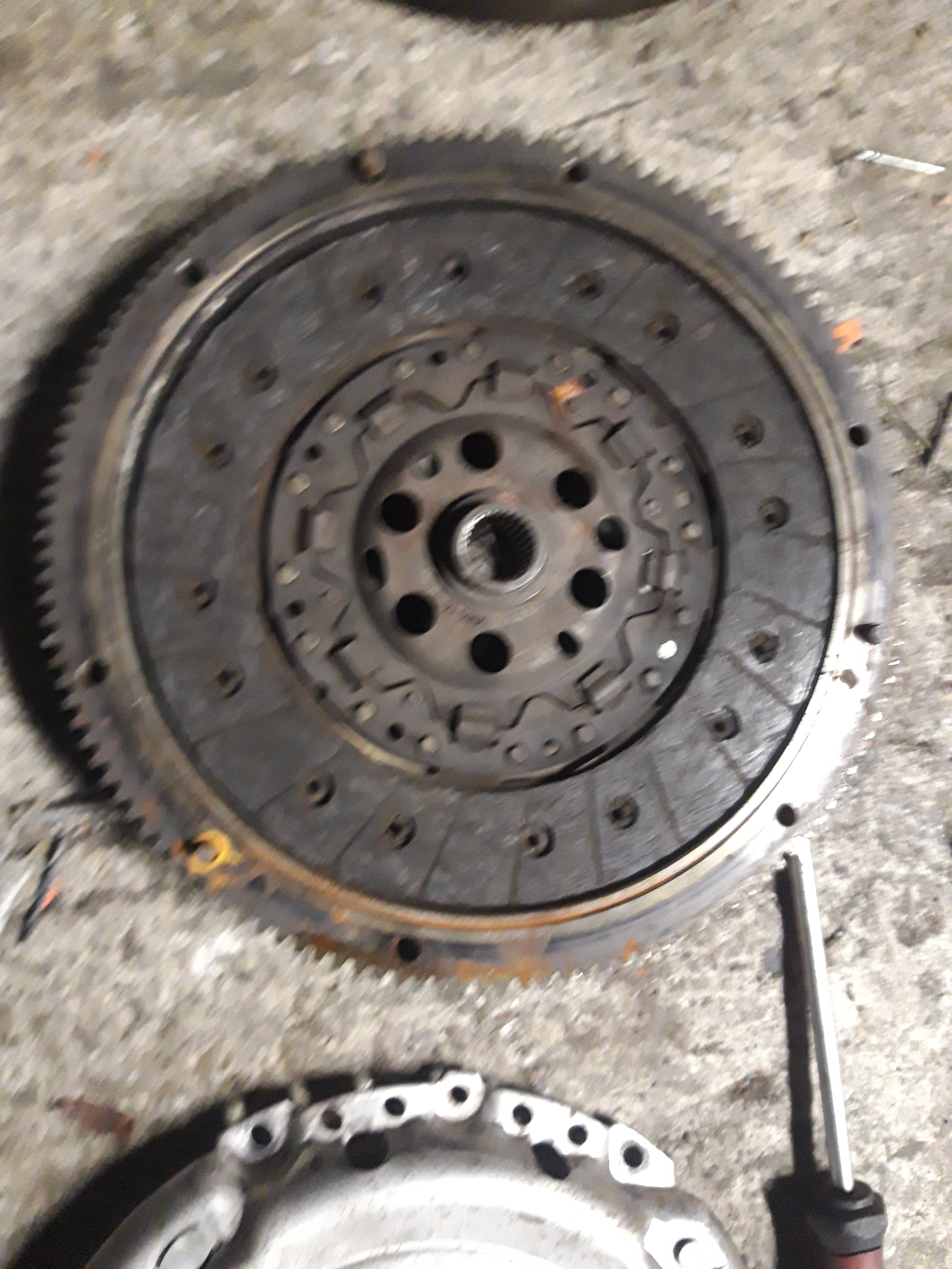

  13. Ya I had figured it was a bad idea but thought the solid clutch disc shouldn't really have any play so essentially the same as the dmf clutch disc. And I had the question at the back of my head saying, should I send it?. Thanks for the reply, i will just replace the smf kit as I have a bad rattle from a loose spring on the disc
  14. Hi all, probably a stupid question but just wondering if anyone had tried it. Can i use the luk clutch disc from dmf with a solid flywheel and pressure plate, it fits perfect in the solid flywheel so no reason it shouldn't work only difference is the springs
