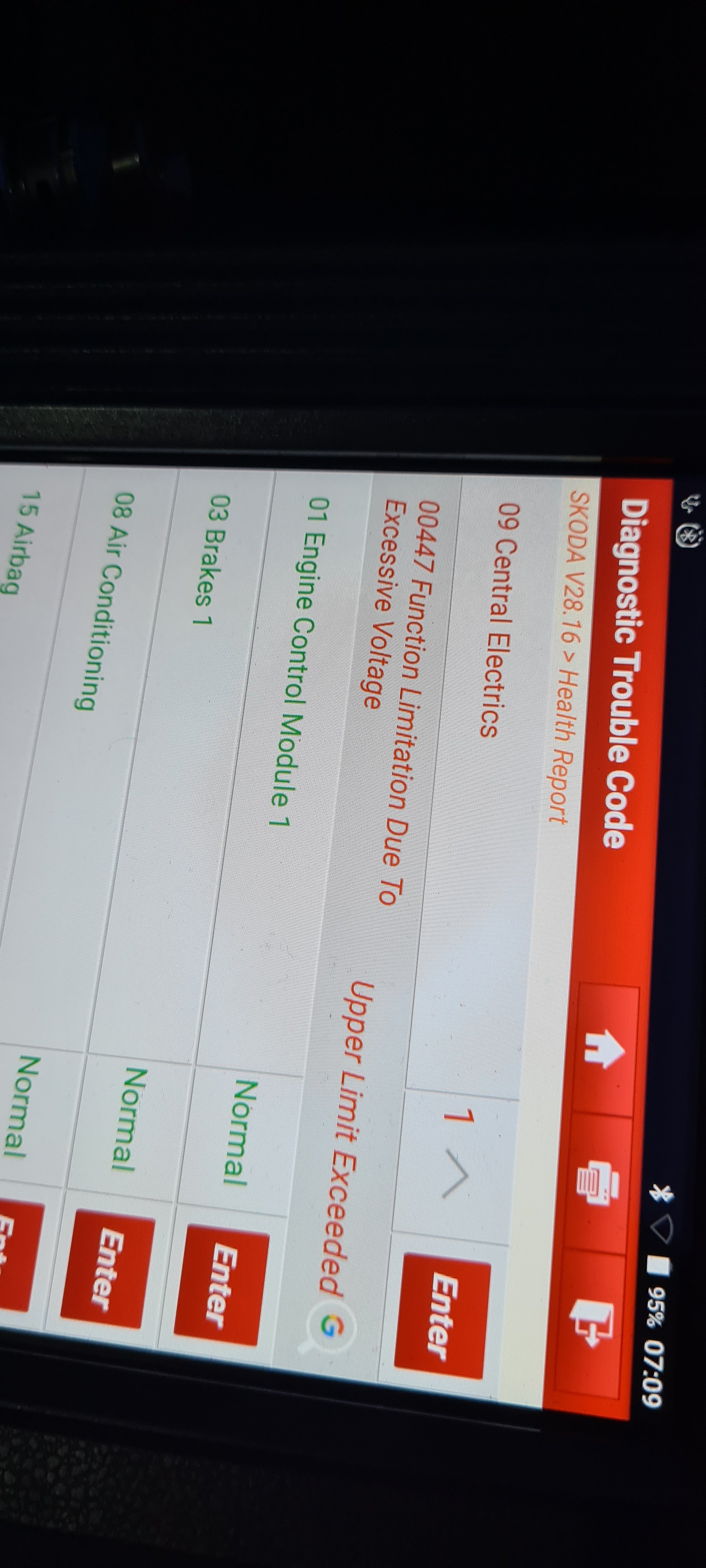

  4. Update! I changed the battery I inspected all the earthing cables and everything else and after putting the car on the tester I ve got 00447 error as seen in the attached photos. I said ok the error must be a relay and reading forums and other pages the error is from 447 relay . Good to be done . After searching the entire car for the position of this relay while I was with the mecanic I told him lets test the car again. But with vcds original from vw so I got no error with this one. After getting mad I started to open all light and every consume and told the mecanic to listen to the sound that happens when i start a consumer its like "clang " like a relay wich triggers. The sound its on the left of the car next to all the relays în the bottom of the wheel from what I ve heard there its the confort computer or the eletric one . Wich has the relay with the problem on it. Next I need to go and see an electrician to change the relay or all the console..
