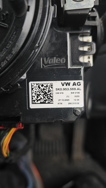

  3. Hi i have a 2012 superb and since ive had it the mfd hasnt worked. I ran a diagnostic check and there are faults with steering angle sensor and clockspring. Ive took the steering wheel off to get a look at part numbers but on the clock spring theres a date with 27/10/2020 so im guessing someone has fitted the wrong part before. How would i find the original part number for my car? Thanks

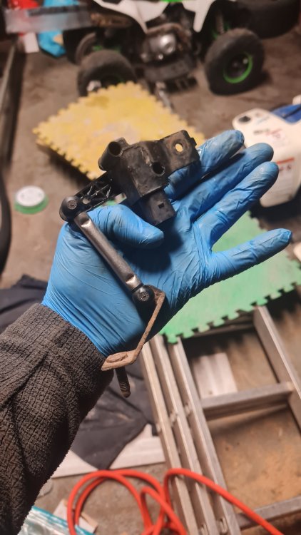

  9. Bought a superb elegance 4x4 lastweek and had no bend lighting appear with the orange bulb light. Changed the front level sensor on the suspension arm and fault is away. Just incase anyone else has this fault. Cheers
