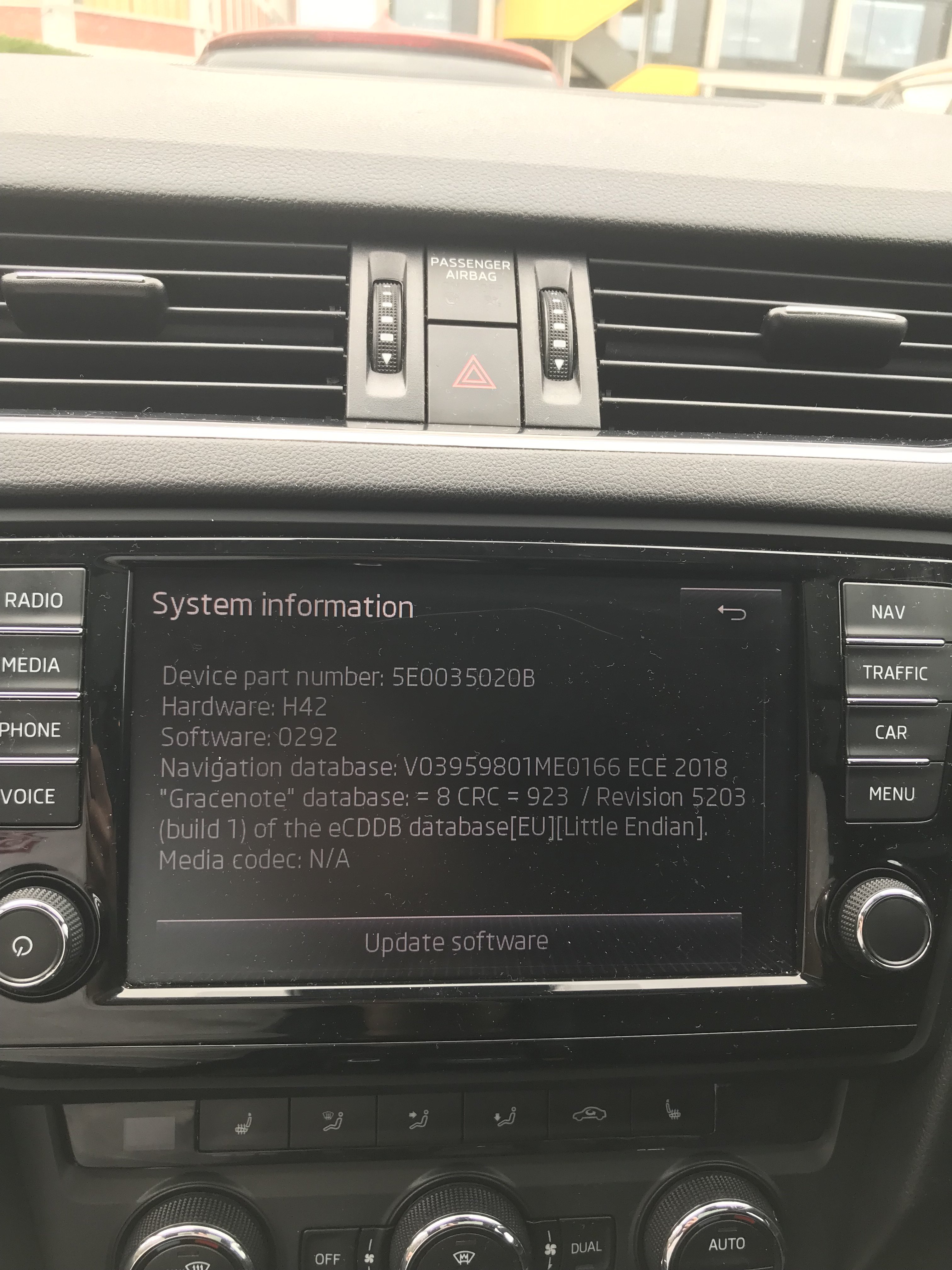

  1. So I've had the unit out of the glovebox and the DAB antenna is plugged in at the top. Stumped as to what it could be now that's confirmed

  3. Tried the radio button multiple times and the options through the touchscreen, but just cycles between AM/FM. I thought all VRS models with Columbus units come with DAB? I'll try to get the glovebox unit out today to take a look
  4. Hi, I bought an 2014 Octavia VRS a few months ago and i'm almost certain it showed DAB as an option when I picked it up. Since then I cant find it anywhere, Tried all the reset options I can find on forums etc. Can this usually be fixed with a firmware update? I've attached a pic of the current Sys info. Thanks
