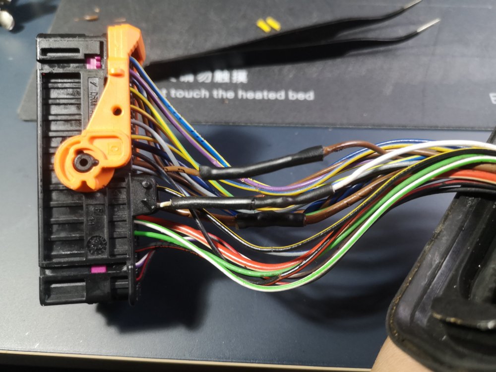

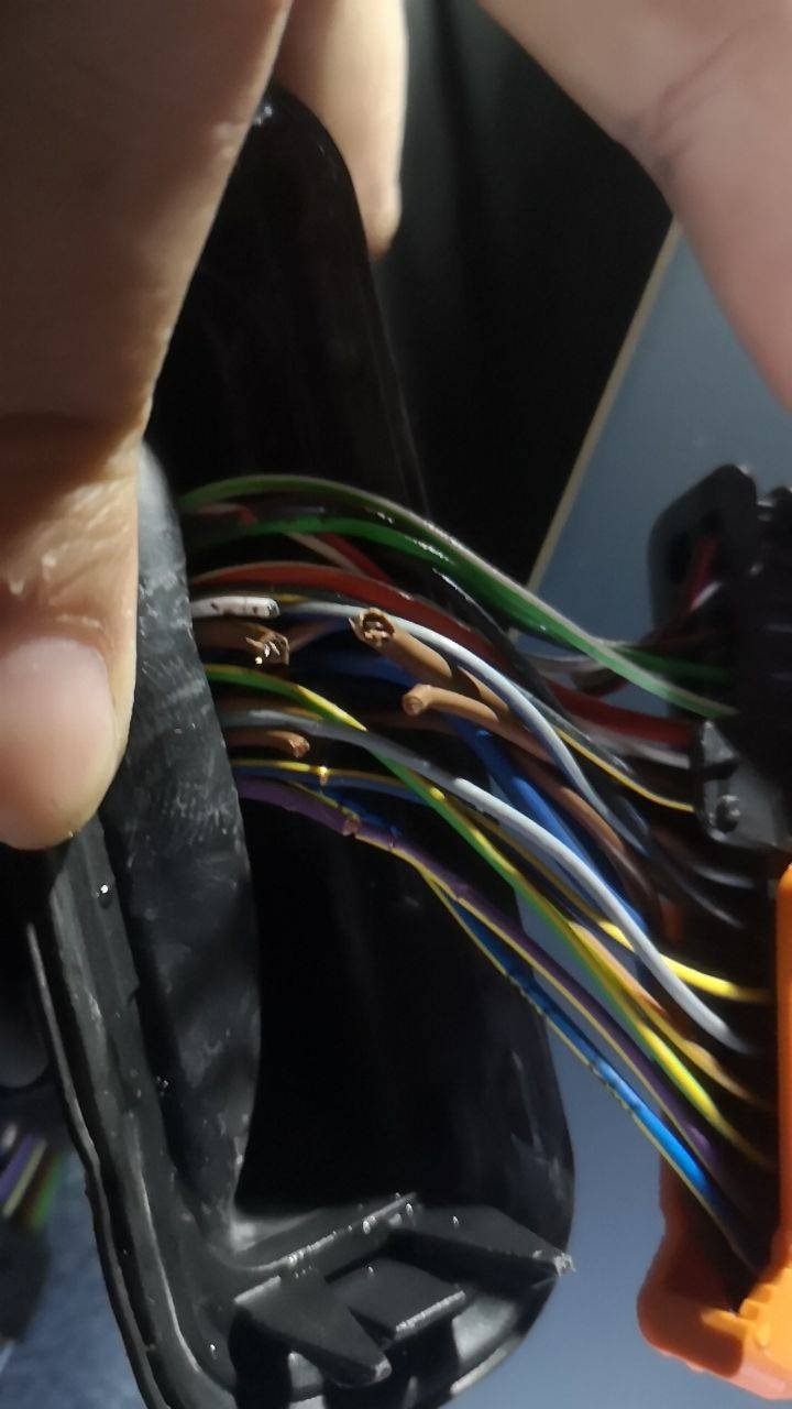

  5. Thanks guys, you were right. Wires in the door had clean breaks. I took the loom out and soldered them for now and everything works now (including the left mirror), should do for now. Other wires are starting to go brittle and crack so I'll order a new loom from skoda (£120 Inc. VAT)
  6. Yeah I want to check, the up down on the passenger mirror isnt working either. Just have no idea which wires are which!
