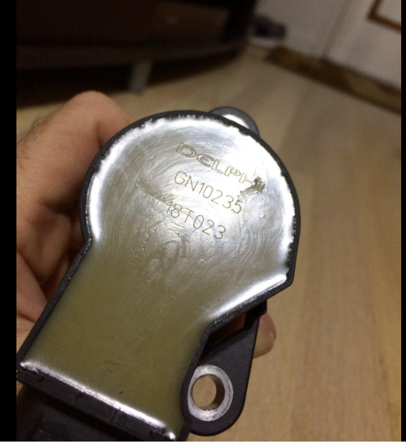

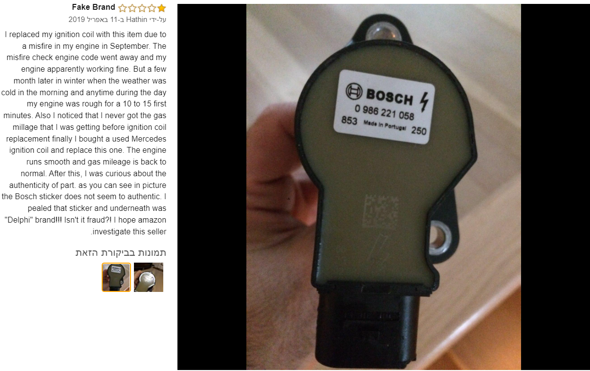

hi Advice help...π After some homework, I realized that these are suitable and should be of good quality ... 1. Bosch 0986221048 2. ngk 48010 Anyone know which one is more recommended? π

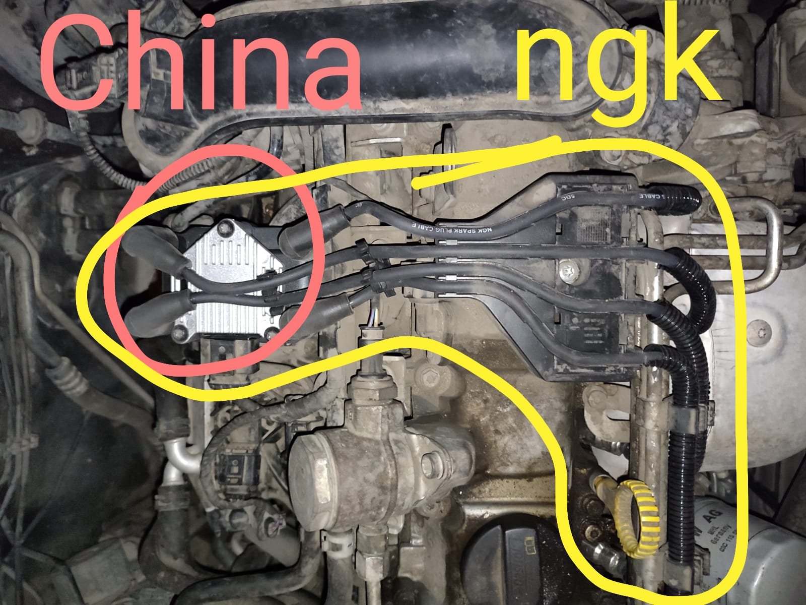

Hi A month and a half ago I had a problem with "Misfire Detected", in cylinder 1 and cylinder 4 (P0301, P0304) and also "Random / Multiple Cylinder Misfire Detected" (P0300). I replaced the COIL, ignition wires and plugs. (COIL - simple from China... plugs - NGK. ignition wires - NGK.) Until today everything was fine ... Today I had almost the same problems again ... (Attaches the test ...) Does anyone have any idea what the problem might be? Thank you!π Log-111-TMBJN25J6E3037014-242160km-150471mi.txt Log-1111-TMBJN25J6E3037014-242160km-150471mi.txt
