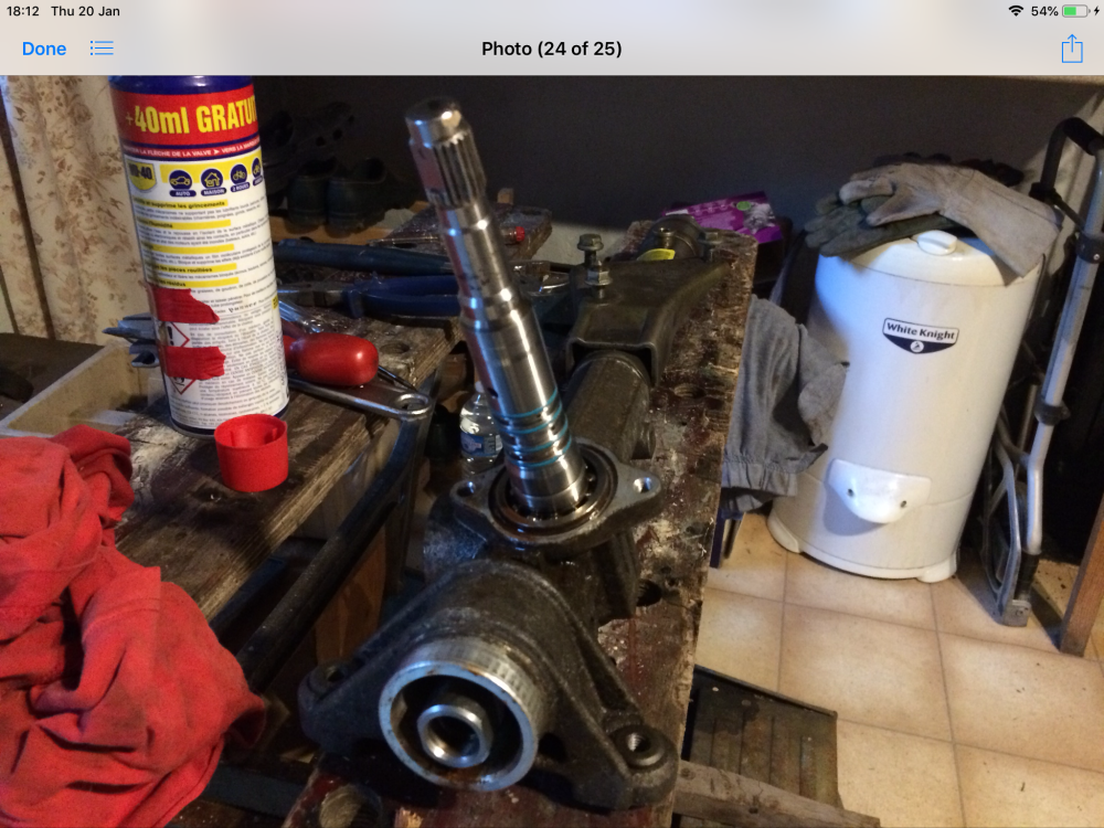

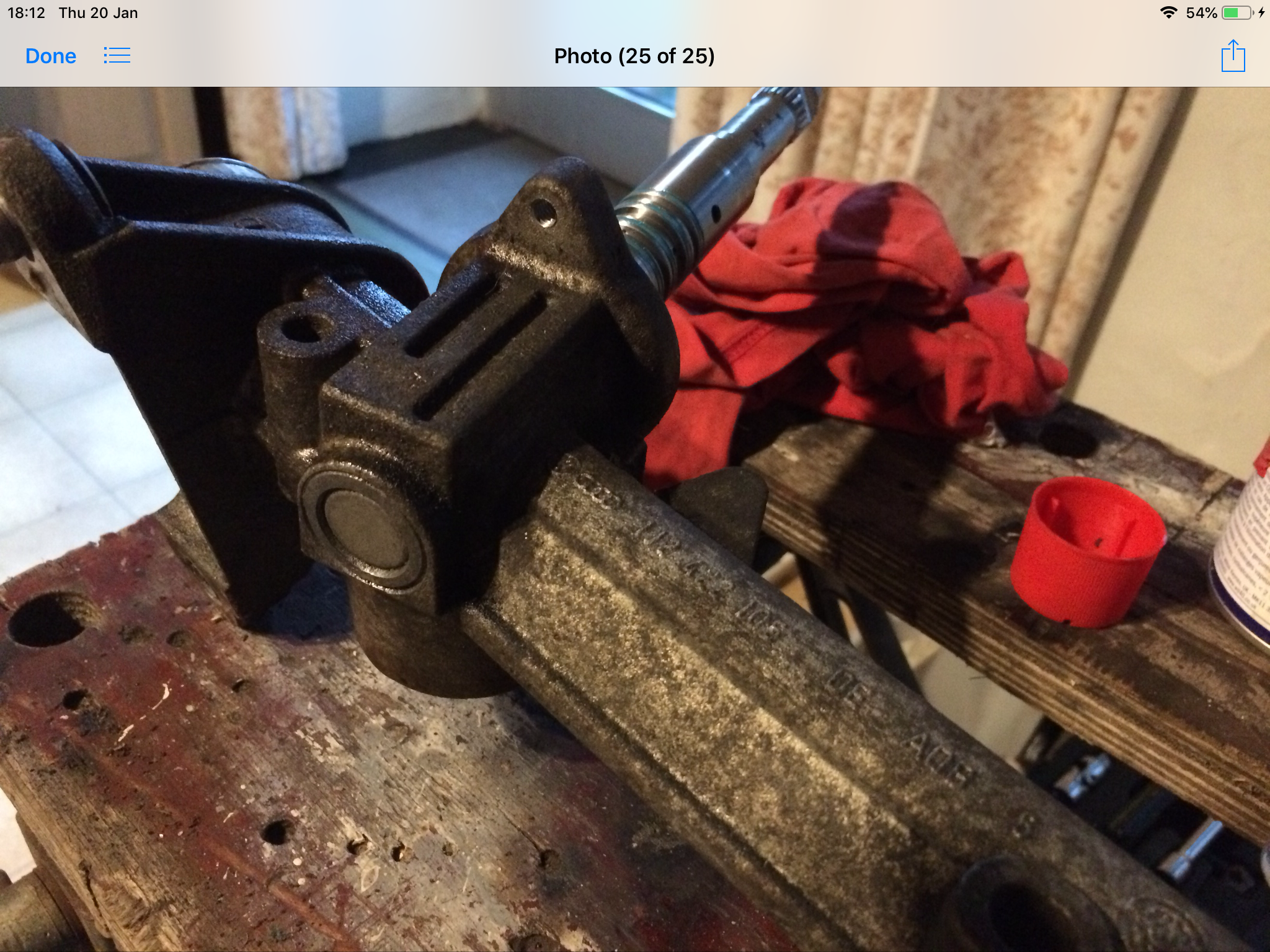

  6. Thanks guys for your positivity πŸ˜‰. Boy what a job! I think I’m pretty good at sticking to tedious tasks.... and this is one of those thats for sure. Tried drilling the coreplug but no joy, seriously hard metal-none of my new bits would touch it!?πŸ€”. So thought I’d weld a bolt to it and pull it off, but it wouldnt weld either. So ground the alloy around it down until it tapped out with a hammer. Distorted the roller bearing cage on the end of the shaft a bit but hopefully still ok. Quick tap with a drift and the pinion shaft popped out!πŸ‘. Next job getting the rack out the housing-theres a circlip holding the seal/bush in the end furthest from the pinion, sprung it out with screwdrivers, removed the seal/bush and rackπŸ‘. Next job inner seal/bush.....what a bas#ard! Had to make long reach tools out of steel rod to pry it and chop it out in the endπŸ˜•, buts its outπŸ‘. Just need to clean the rust pitting off the end of the rack, and any other blemishes, then I can start putting it back together. It will be an absolute miracle if it works!πŸ˜‚, but we’ll see. But the amount of time and effort is just nuts, never worth it really. Do any of you know if an Audi TT rack will fit? Serial number is pretty similar all but the last few didgets!?πŸ™„πŸ˜‚ Brace yourselves for the next exciting episode...........πŸ˜‰πŸ‘
  7. Looks like nobody has done this judging by the amazing response!πŸ˜‚, so I’ll whip the coreplug thing off, nothing to lose.πŸ‘πŸ˜Š
  8. Hi folks! I’m trying to repair my leaking steering rack,on my 2001 Octavia TDi, and remove the pinion/shaft shown here. Looking at other vids, the shaft pulls out from above, but cant get this to budge, and the bearing housing is probably/hopefully the reason.The core plug type thing on the bottom-should that lever off? Any tips appreciated please. Many thanks.
