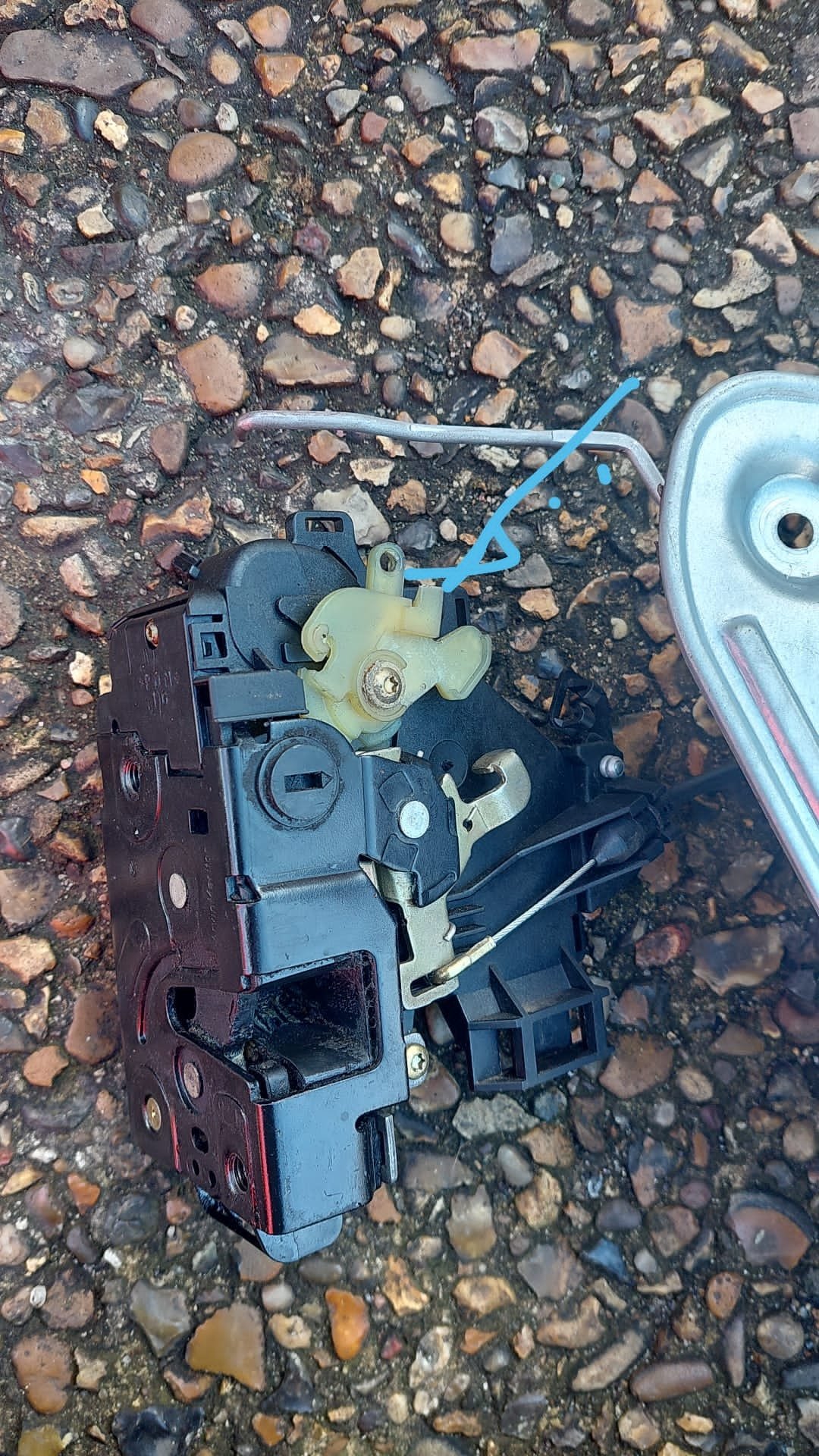

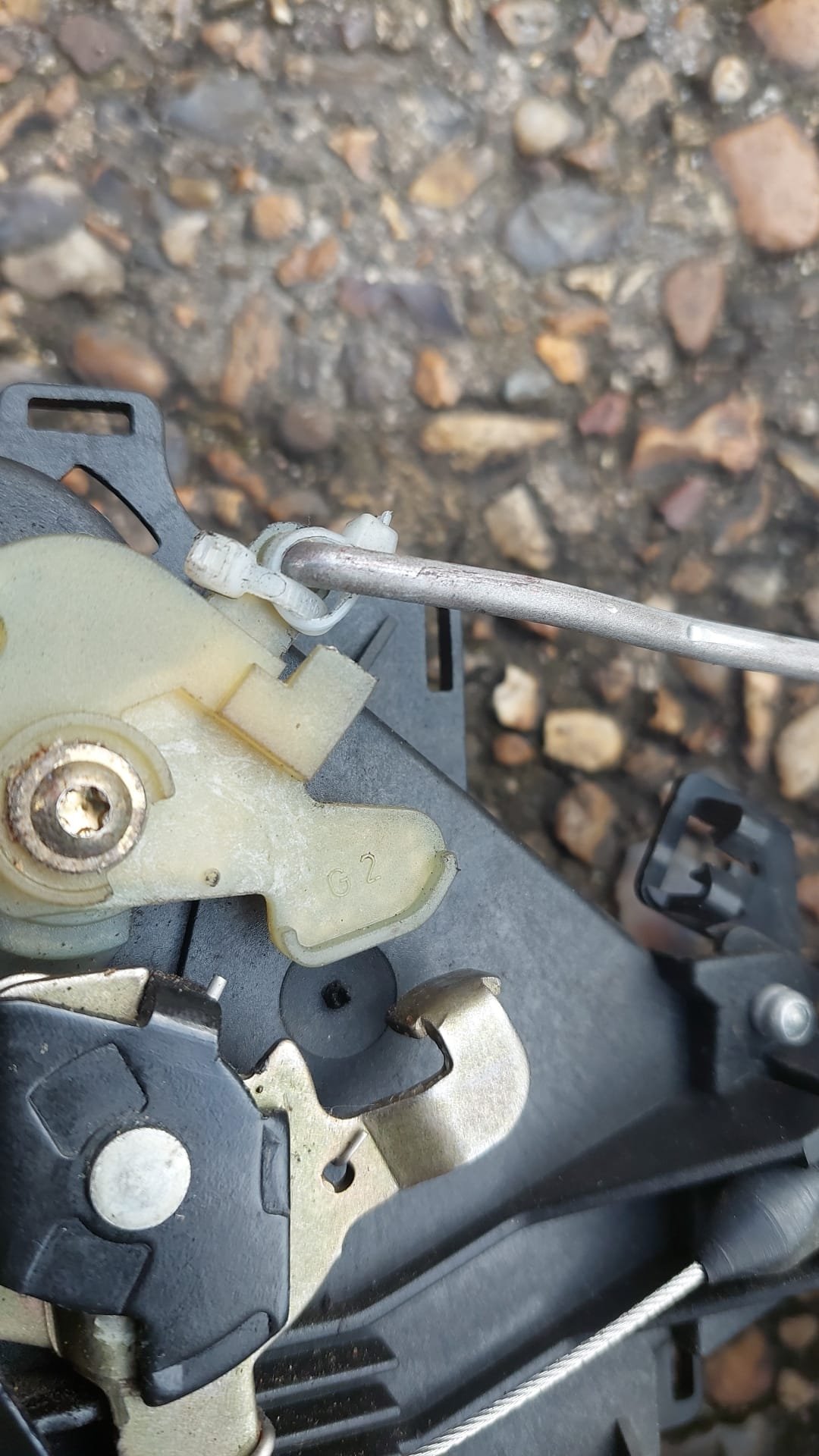

  1. Hi @Pete_Ex-Wino OK I got this fixed, well sort of. I removed the door card and was faced with a rivetted plate covering the whole door. I drilled out the 8 rivets to get to the inside of the door handle where the thin bar joins the pop up button to the handle mechanism. I found that the two were not connected as the eyelet that the bar should have been connected through had broken. Best attempt at repairing this was with a tie-wrap which appears to have done the trick. Not best pleased with the body shop so will be having a word this morning. Also had to find a friend with a rivet gun to put the plate back on...... Not sure what Skoda were thinking of with a dirty great plate riveted behind the door card, there must have been better ways of holding the window winder on!
