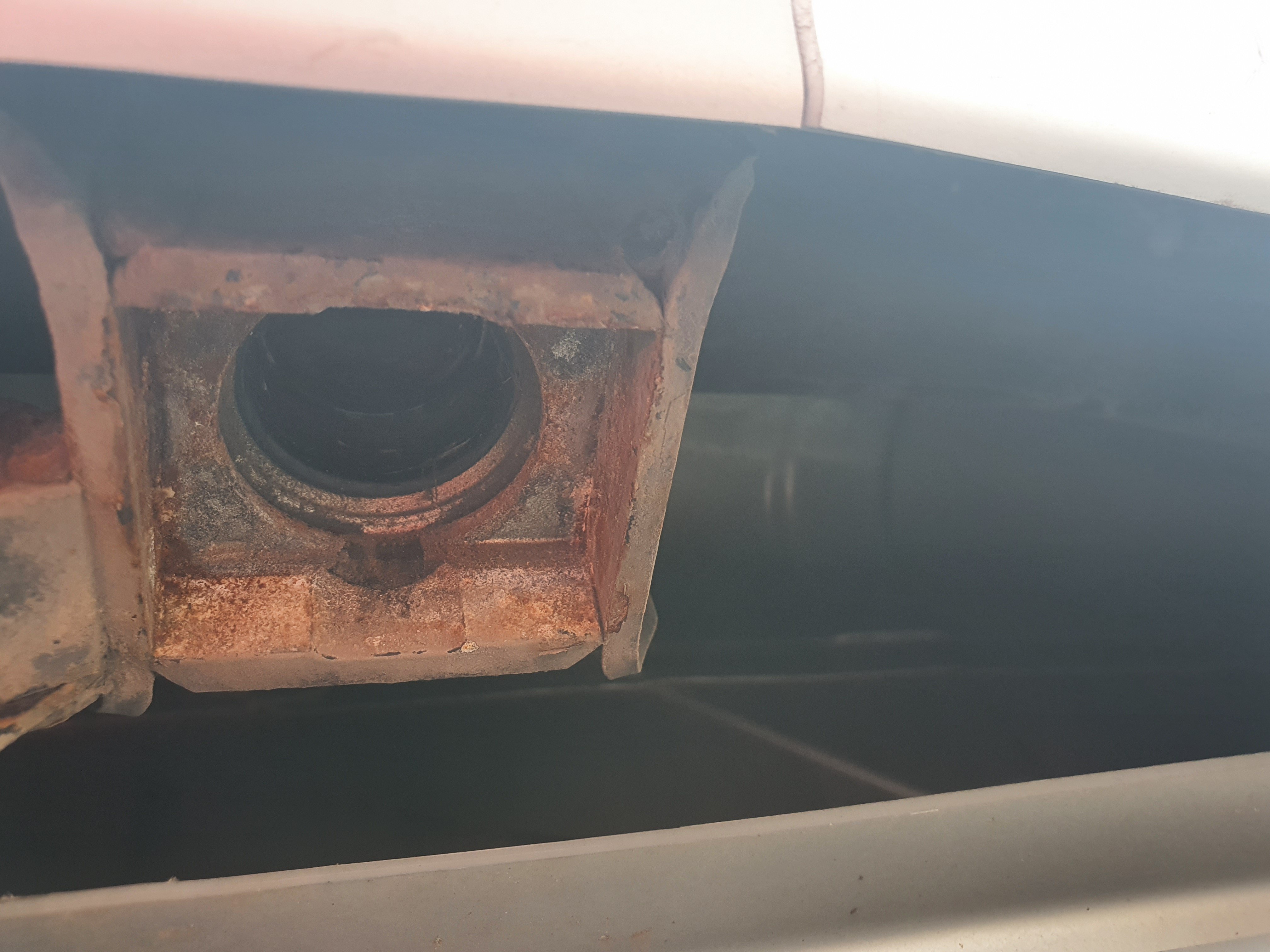

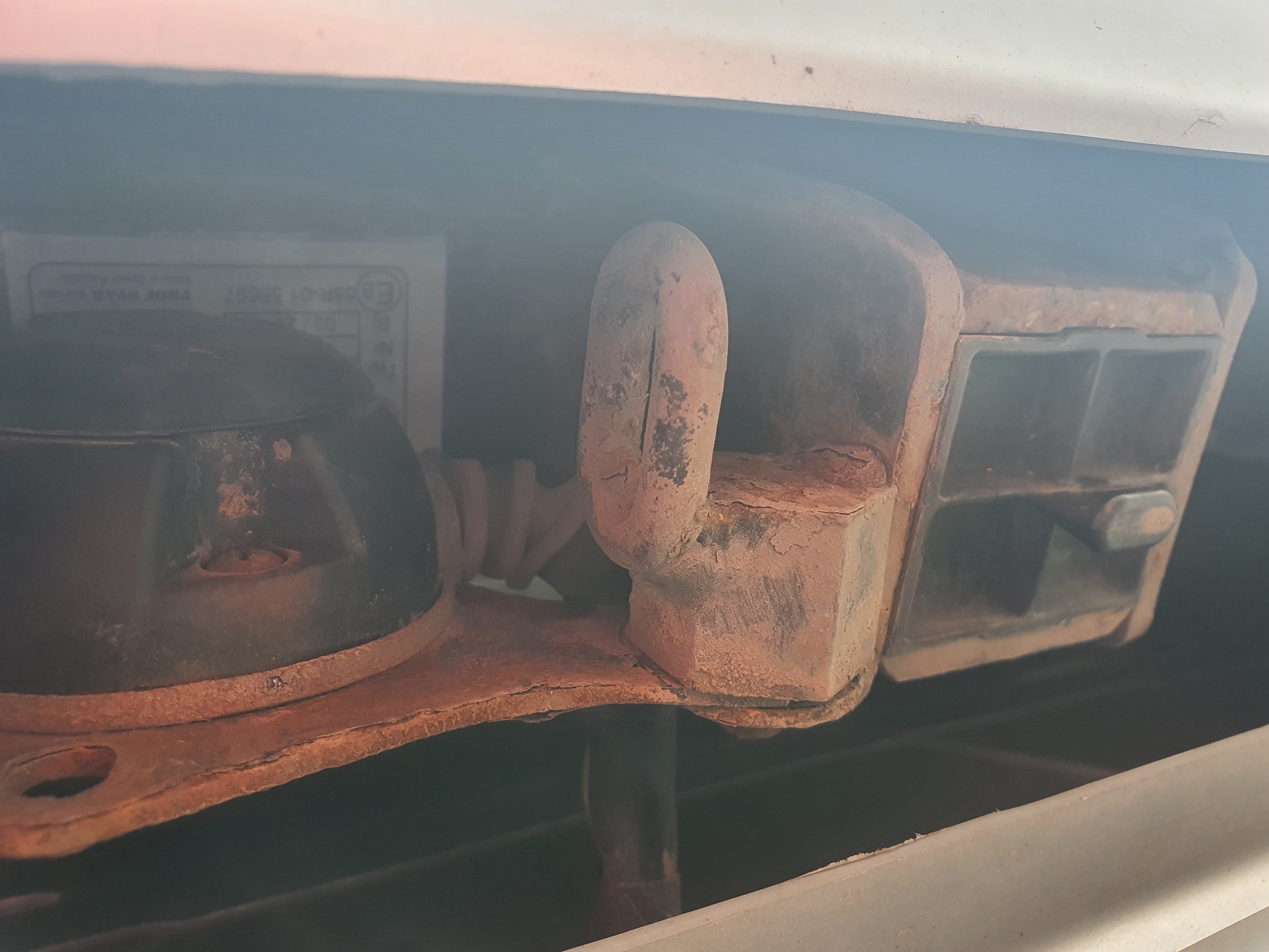

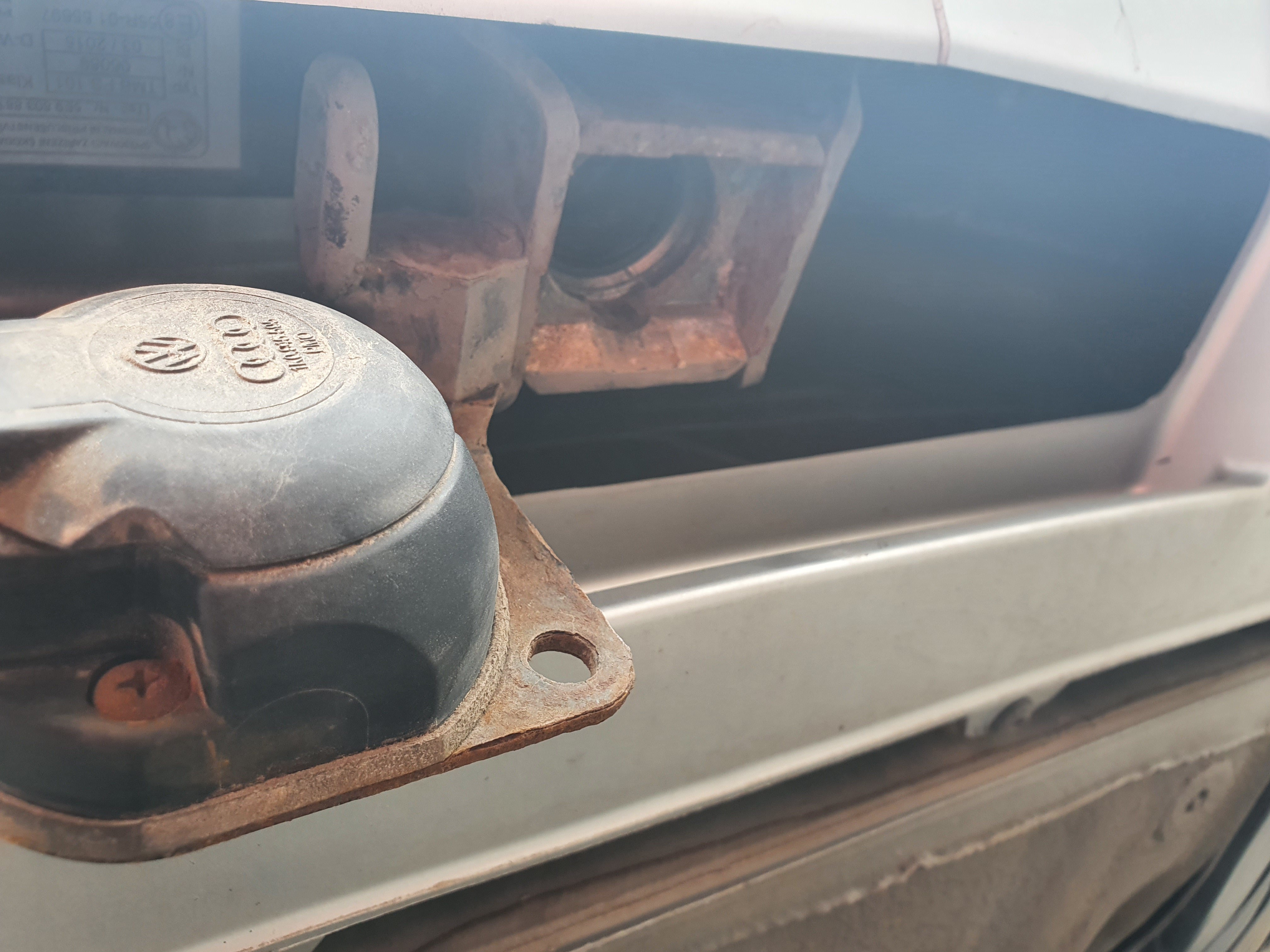

  8. Hi all! I have an Octavia 3 Scout from 2015 which I bought used in Czechia. I didn't know or need a towbar until now, and I didn't know this car is equipped with one, but apparently it is. The problem is that the towing ball appears to be missing, I can't find it anywhere in the trunk. I went to an official Skoda service in Prague and they told me the part nr for it is 5E9 803 902 A, but they don't have it. I tried to look for it online, but I can't find any sellers by the part nr. I'm attaching some pictures of the system. I'd really appreciate some advice on where I could find one. Thanks!!
