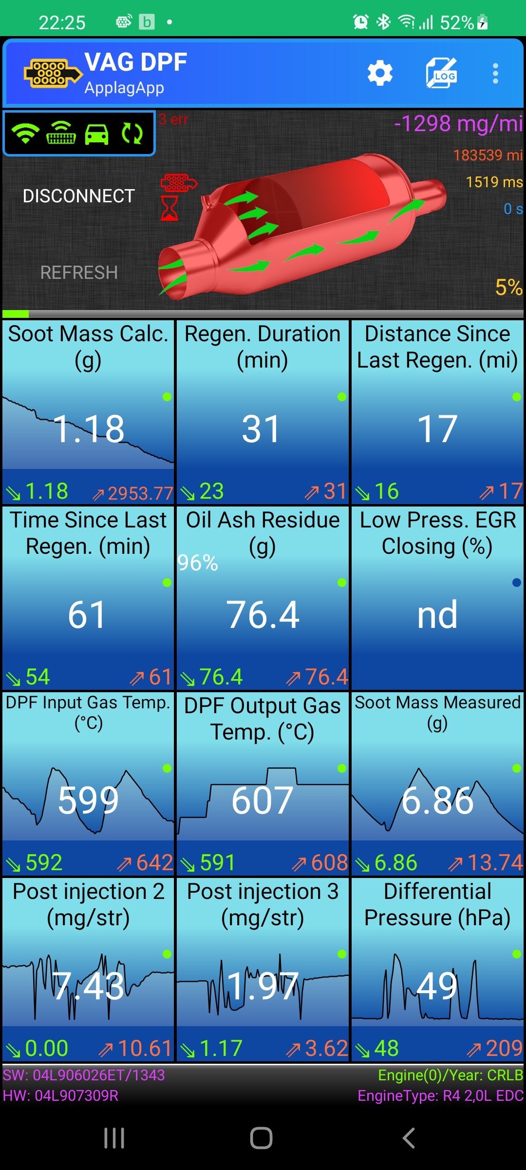

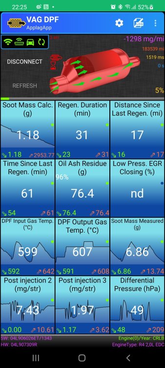

  2. Thanks everyone for reply. I'm booked tomorrow for a cleaning to see if improves anything. The new sensor hasn't been adapted so i'll do that aswell. Forgot to mention that the car has problem with the oil it's burning ( 5l in 10k miles ) which i think it made the dpf blocking sooner than it should.
  3. Hi, any advise would be appreciated. Couple of weeks ago my dpf started going mental. It's regenerating continously like the picture attached. I have a crap mpg but nothing else. No fault codes. I have replaced already the glow plugs( had an error on glow no 3) and the pressure sensor aswell and while there's an improvement it's far away from what it should be. It is a superb 2016 2.0 dsg used for taxi so does a mix of city-motorway driving and has plenty time to get the regen completed.
