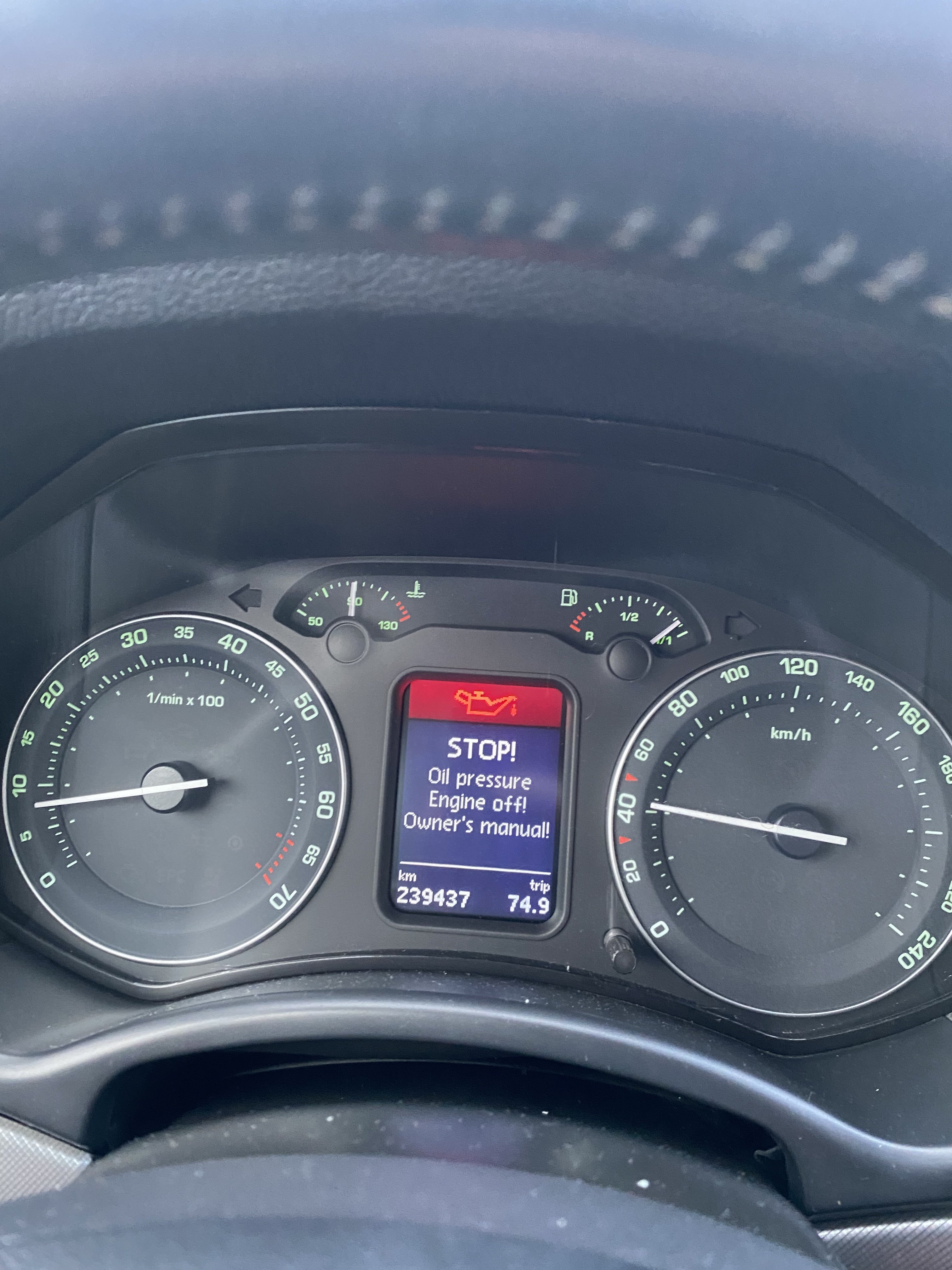

  3. Hey! Thanks for answering. Luckily it was a half broken oil pressure sensor wire, fixed that and now working like a charm 😁😁😁.
  4. Hello! My octavias red oil pressure light randomly comes on, then goes randomly off and repeats. Anyone had this kind of problem and what seems to be the issue? I add a picture of the warning light. Also oil level is max and changed 3000km ago and no oil leaks.
