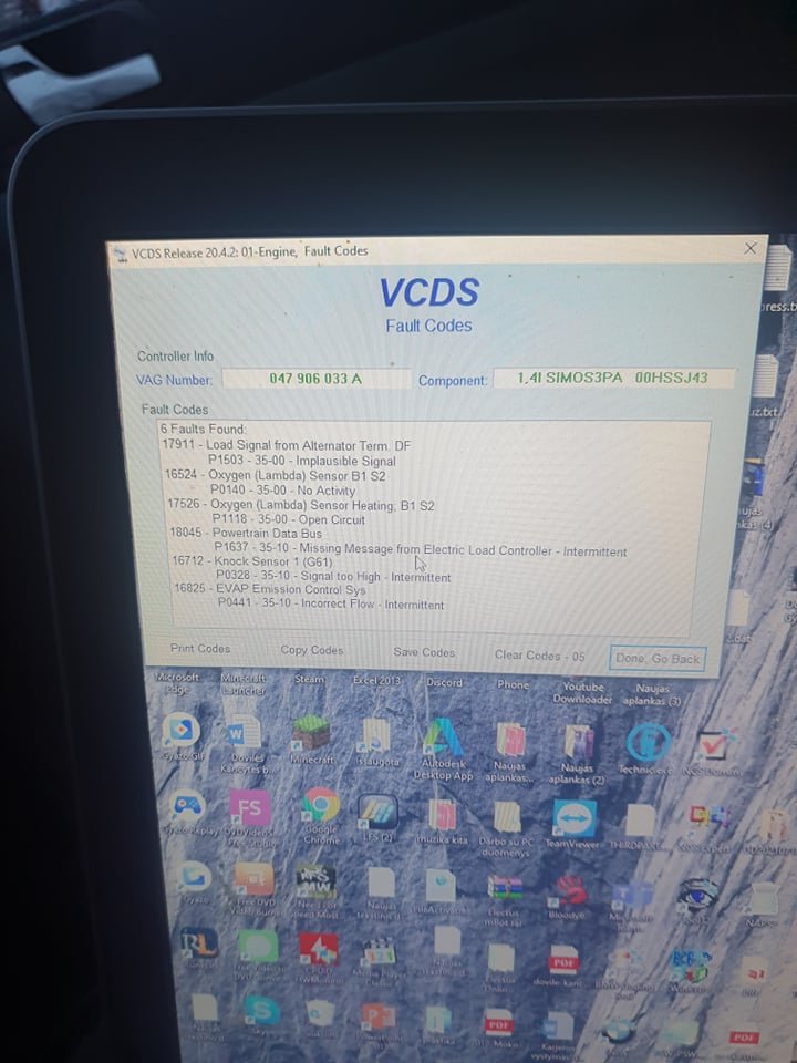

  6. but its quite hard to accept that because the noise is quite noisy, i can even hear it in the seat when driving without music for example, i will look what codes pull up and update the post
  7. Hello recently i bought a skoda fabia 2001 1.4 8v. After the purchase the car developed a ticking noise. It is still apparent when the car is hot, and it is apparent from 800 to 2500 rpms. after that the noise almost disappears. Did and obd check and there a few faults and uploaded the file, every fault code clears up and i will do a check on friday to see what codes appear again. Also the battery was dead when i bought it. So what could cause the ticking noise? There is enough oil in the engine, however the engine seems low in power and the engine twitches in low rpms. Any help or suggestions would be wonderful
