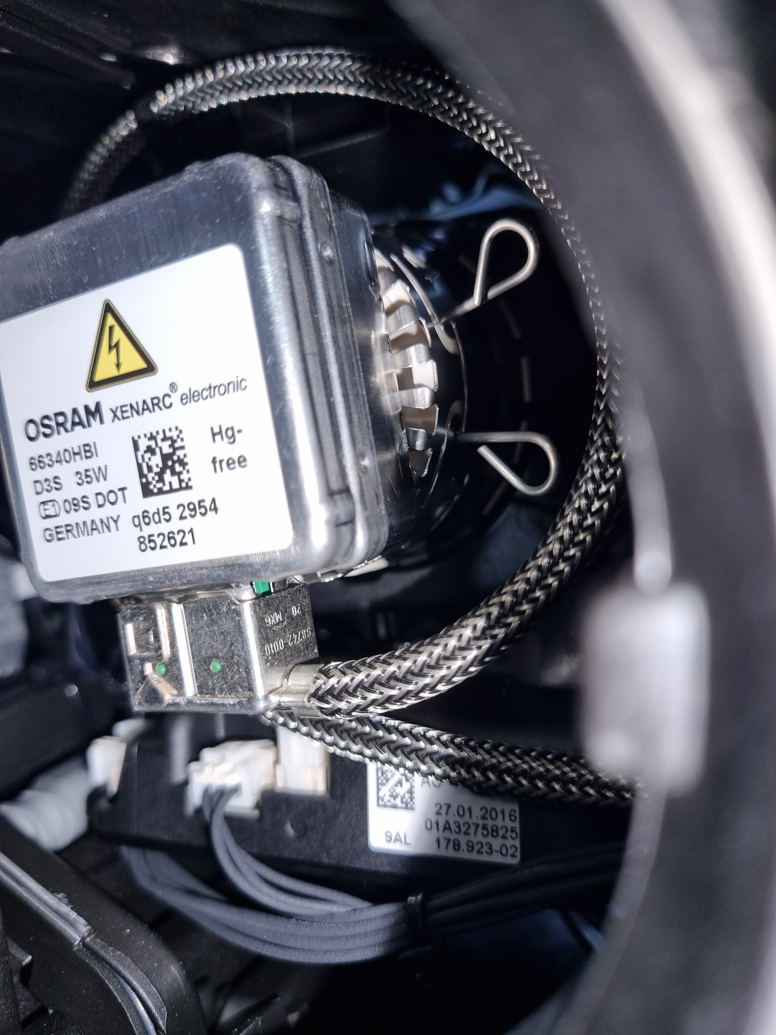

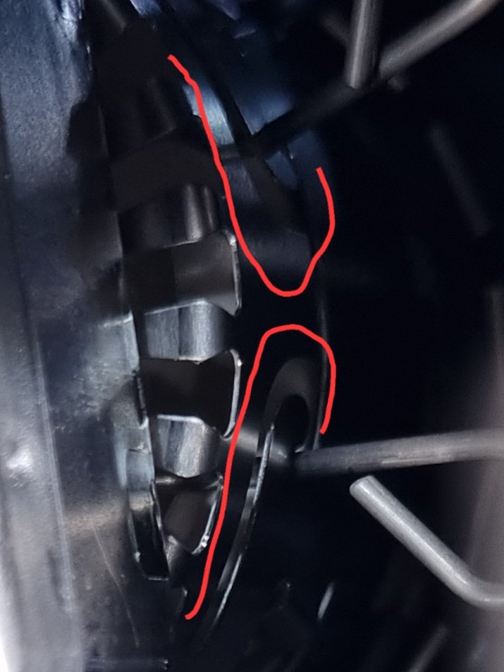

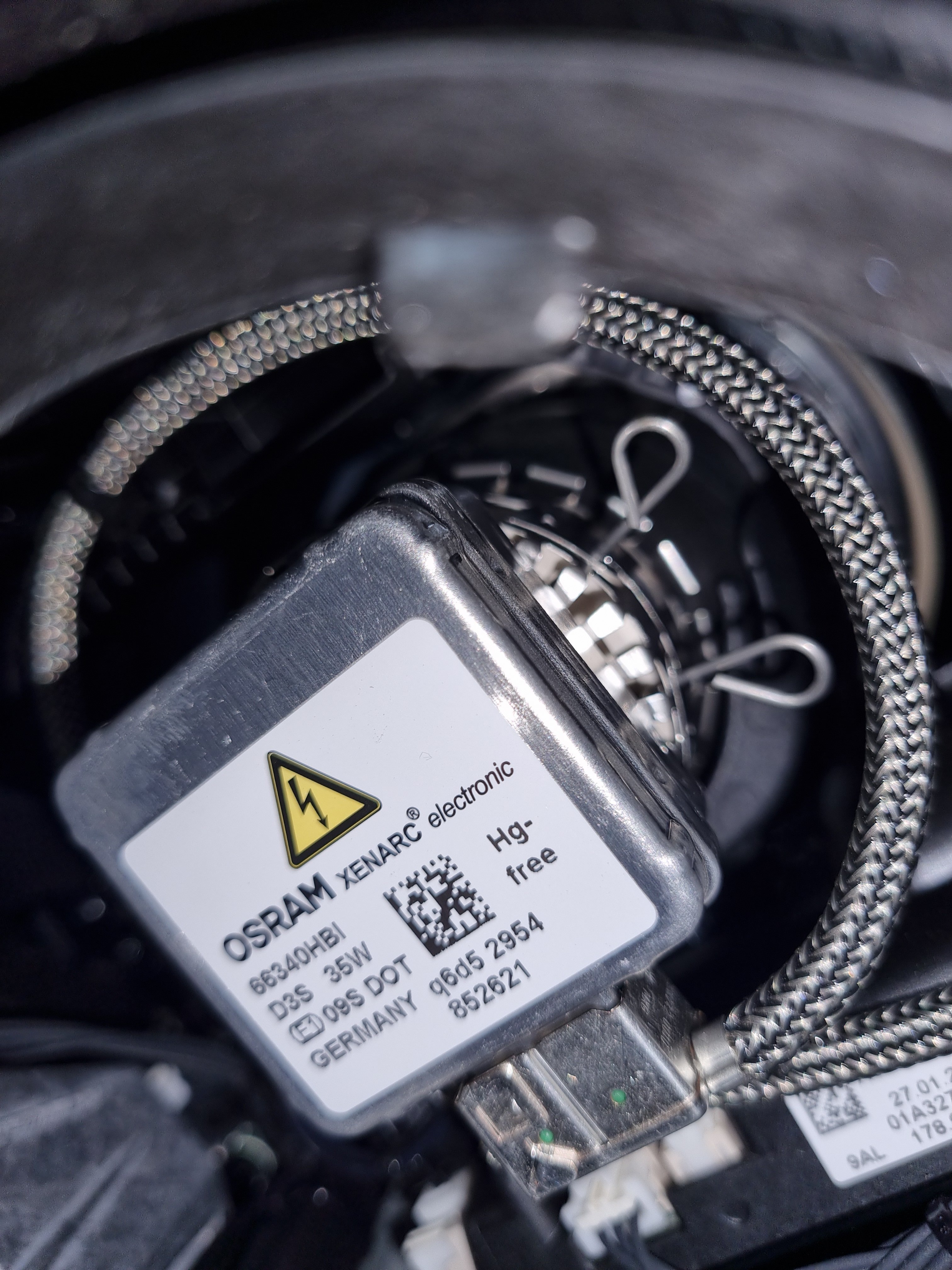

  1. @shea1980 Today i could release the lock, remove the old bulb and put the new one in and lock it. Check the picture in a few entries before that shows the path the wire travels in.
  2. Thank you all. I could see the release path after having a closer look to my photos. It is like J as Xman mentioned. I can now try....
  3. I understood that we fisrtly need to do something with the wire strap. But still dont know how to release it. Should two wire loops become closer to release or we push out the loops at reverse direction or hold the straps and turn it counterclock direction ?
  4. Hey all, What is the basic way to remove the bulb? I tried pushing counterclock side but i couldnt remove. I afraid to break something and stopped forcing. I believe it shouldnt be that much hard. Is there a lock or piece i need to push before forcing counterclock? Thanks
