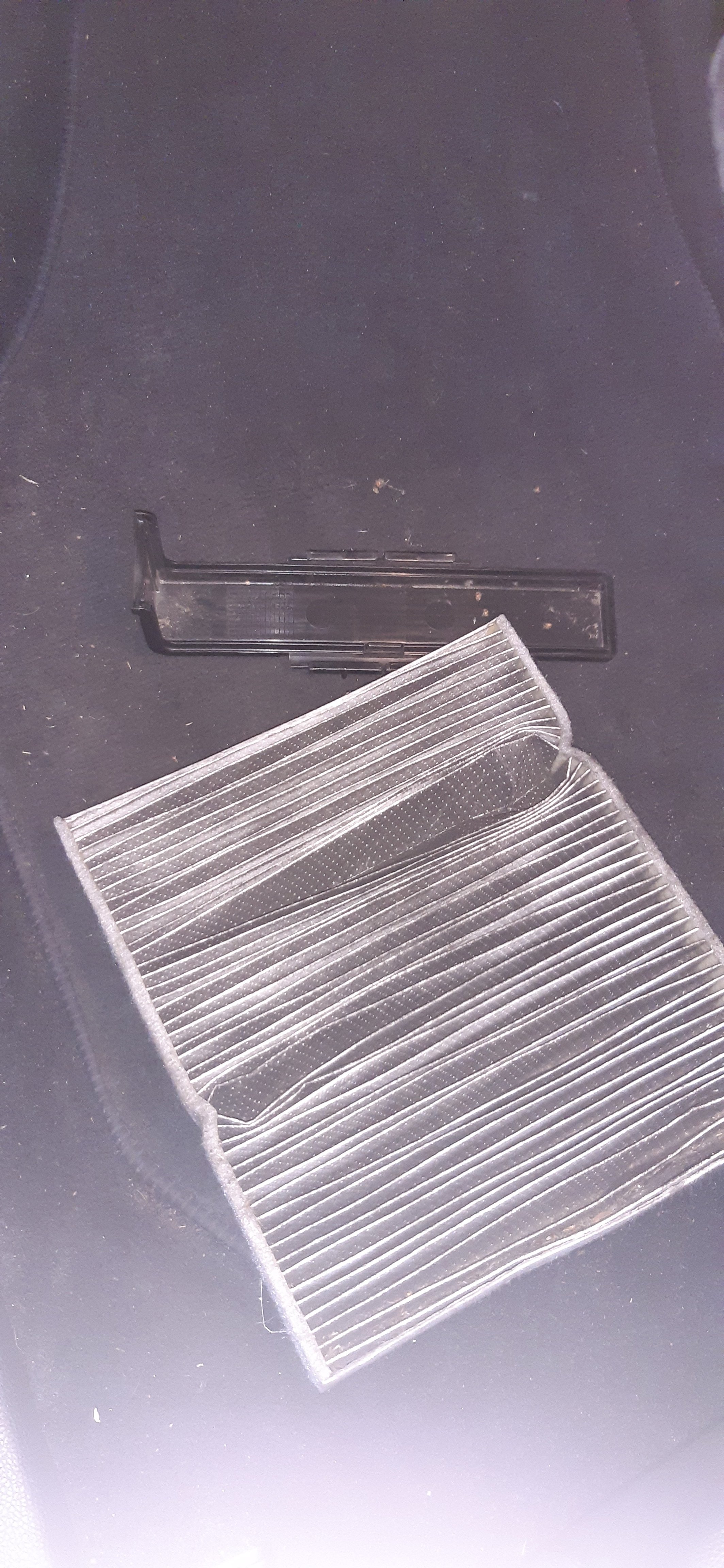

  2. ... I mean, I don't think the pipe work that feeds the pollen filter is blocked. Also the pollen filter does not look particularly dirty or full. So have popped it back in. Picture attached above. Thanks for reading and considering this post. Happy for any other suggestions as I don't know exactly how the system works and what to check next.
