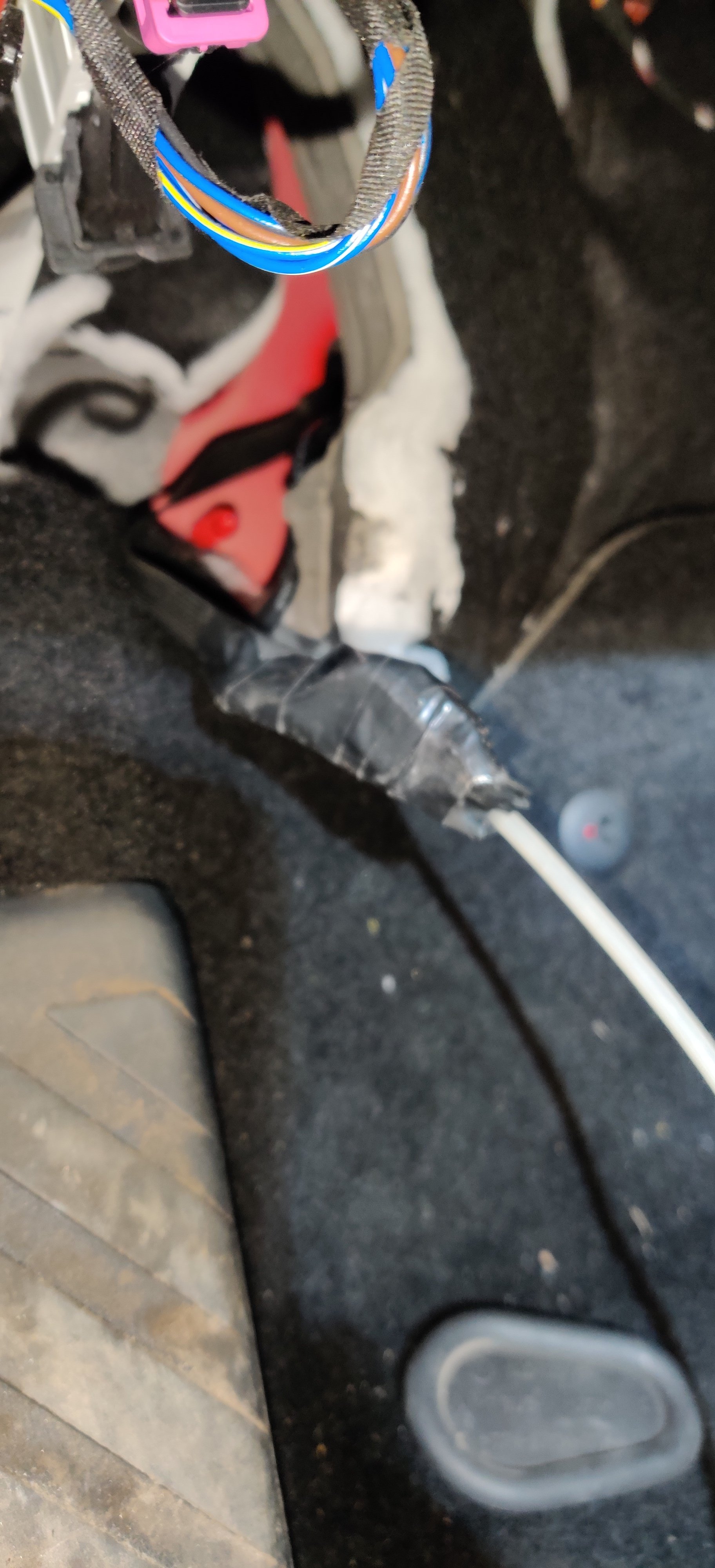

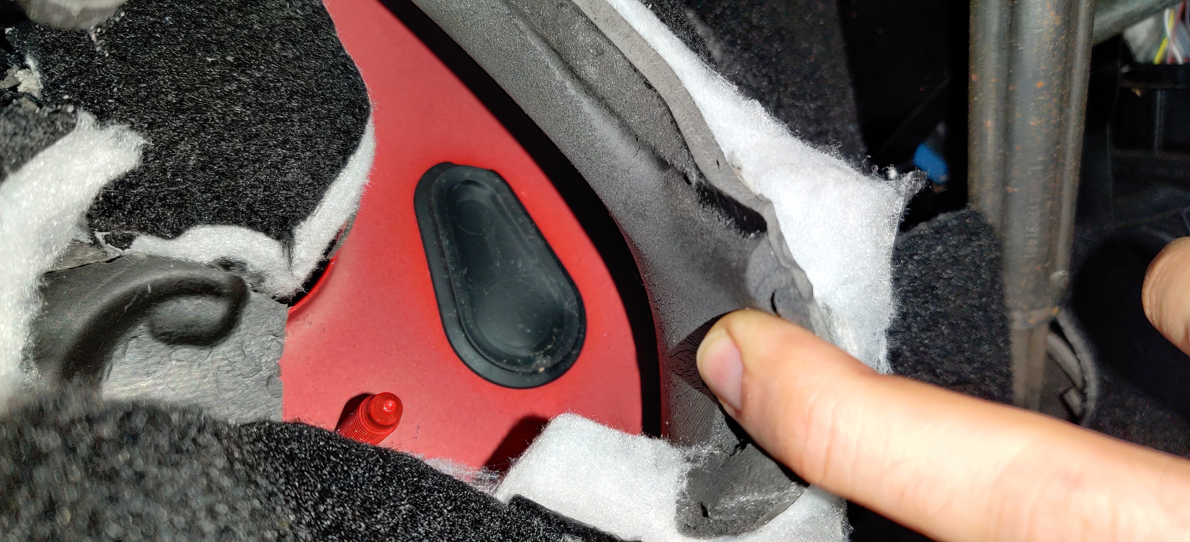

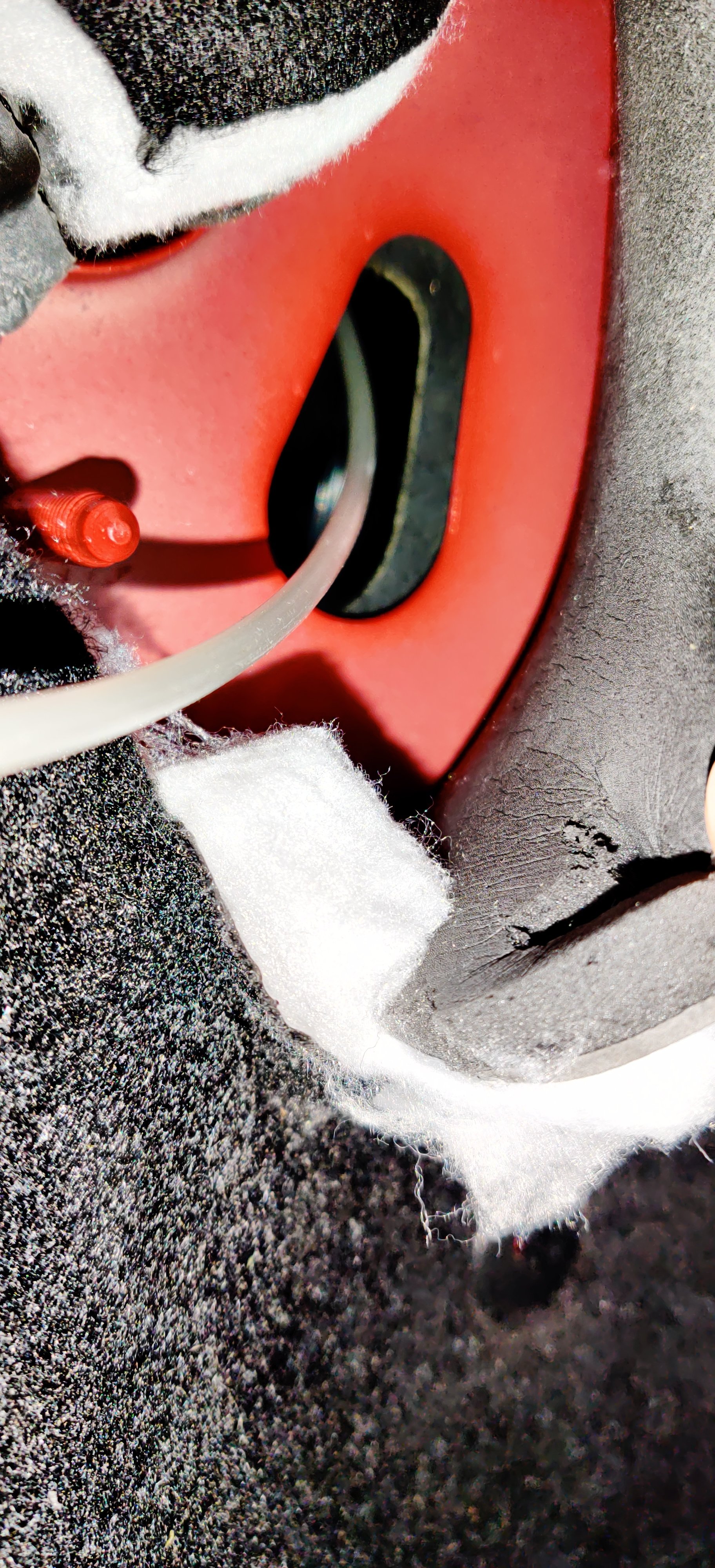

  1. Nice of you to point out but i drove like this for 4 years in another VAG car and no problems. There is no water going on the back of the firewall, especially not that high up. Maybe if you drive through a pool But yeah, ideally you make a hole in it and put it back, i just put it back and let the wires rest on the top. I don't like cutting and poking holes in OEM stuff
  2. Remove this rubber plug. Run a stiff wire through the hole, it will pop up behind the battery or next to it. Tie or tape the the OBD wire to it and pull back from the foot well.
