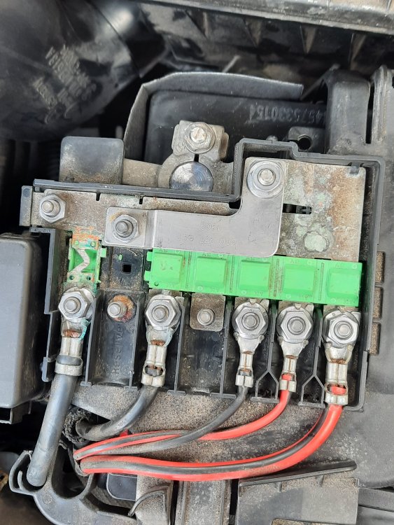

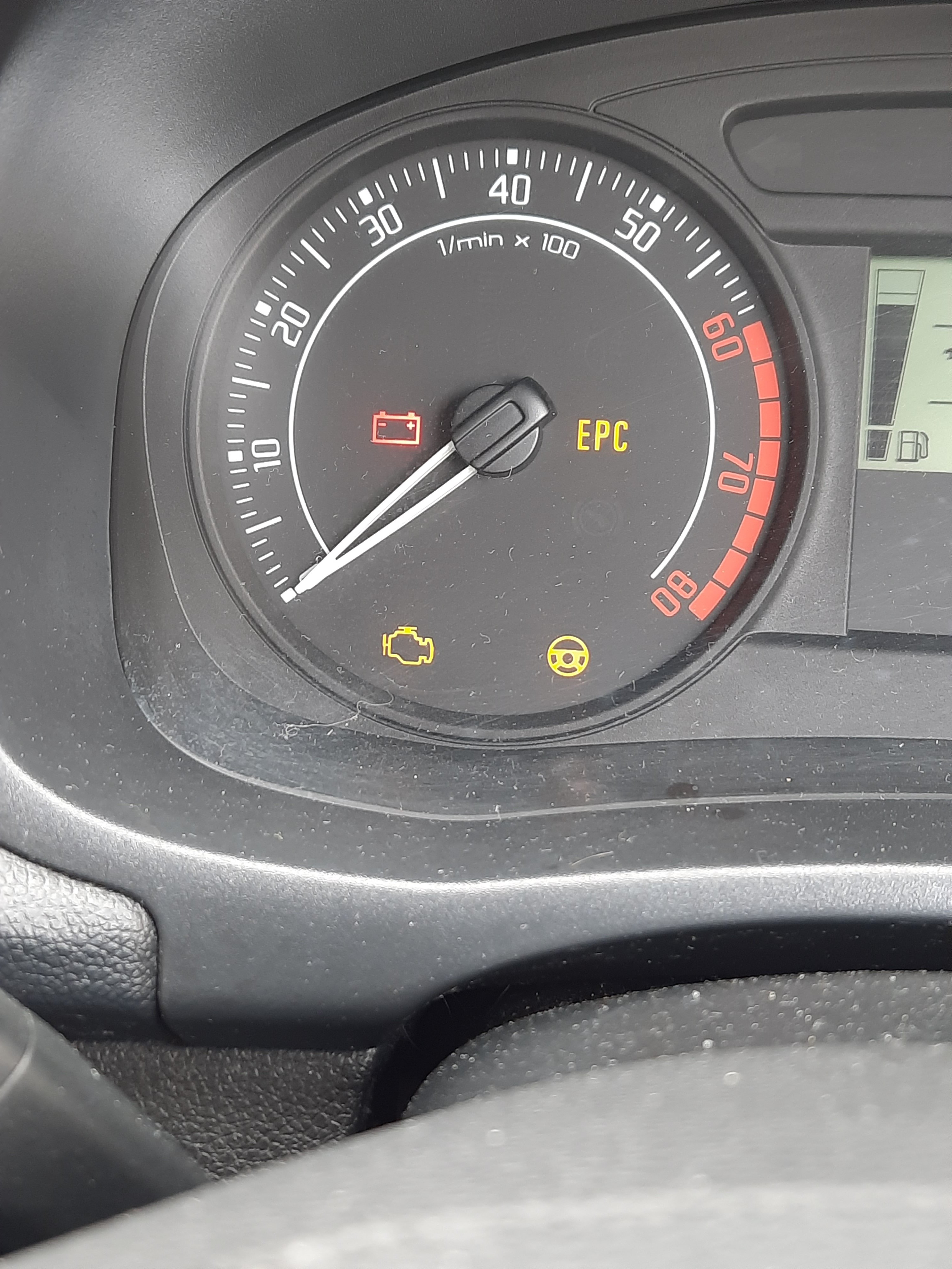

  6. Aside from the steering light, the rest have been a regular feature on my dash. I've tried two different obd2 scanners and neither of them discovered any fault codes (although they both appeared to connect), they worked on another car so this makes the situation a lot more annoying than it should be as it sounds like there's a separate issue there. I've also uploaded with the fuse panel on top of the battery, it looks pretty grim but wouldn't know myself what issues this would cause

  9. Hi guys. My steering light has been on/off for about 4 weeks now. Each time the light is on the steering becomes heavy, but when it's not on the steering is back to normal again. The light would come on about 50% of the time I start the car. Until a week ago, now its on every time I start the car. After various false hopes I've decided to bring the car into the garage. They've told me it might be a problem with the steering rack, which is something they don't have the equipment to deal with. After a quick Google, some sites are saying to expect it to be at least £400 depending on the manufacturer. Has anyone here had to replace/repair the steering rack on a fabia 2? And if so how much did it cost? And was that a garage quote or a self repair cost?
