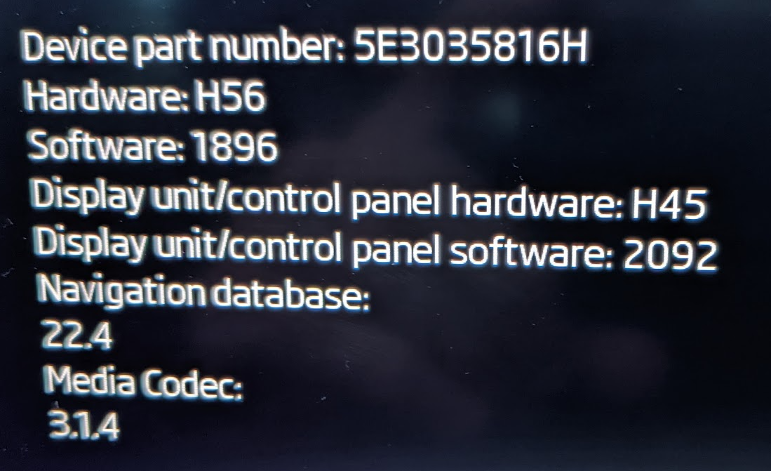

  1. To anyone following this thread - I complained to Skoda UK and after a few e-mails (and an escalation) my car was booked in for a software update - that was yesterday and it has been fixed! I have used it a few times since picking it up and each time it has remembered addresses and settings. Tested and working: Addresses/favourites saved. Last Journey details saved. Addresses sync from online (although there is a bug in their online system so I wouldn't spend much time on that!) Settings (such as traffic signs) saved. (Note: I do not know about the ACC lane/undertaking issue as I'm not even sure if I had that problem anyway). (I should add that they failed to address the two recall/notices outstanding on the car but this seems to be a general issue with parts and training - that should happen in a few weeks).
