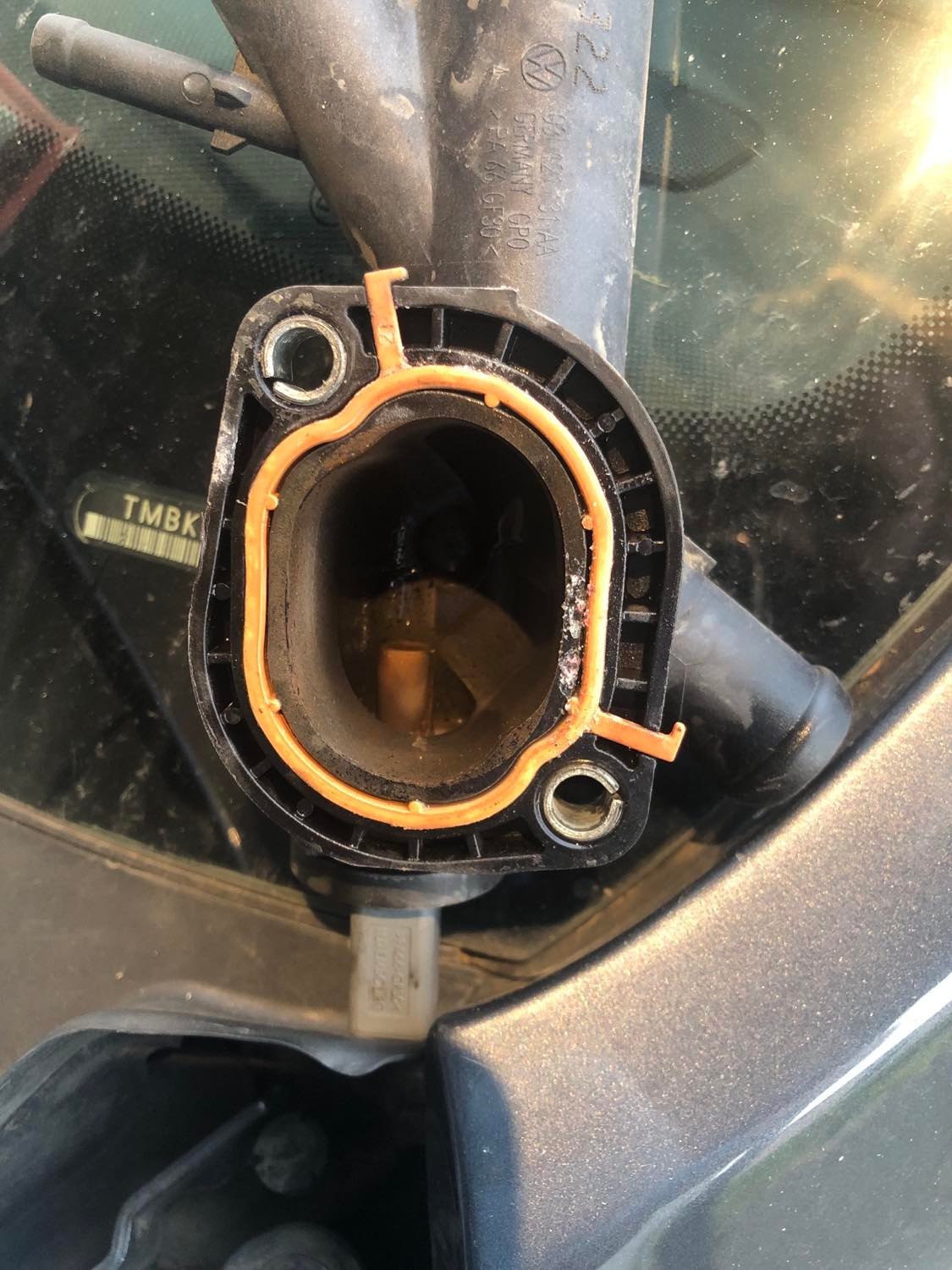

  1. So, I had plans to take the car to a workshop but they didn't have availability for me... and being diagnosed with "immediate illness" I tore apart what I saw in the engine bay and found the reason for the leak. The workshop I was going to have this checked at had changed this not so long ago, but they still did not find anything leaking it in a quick inspection, just said "it's the EGR cooler"... I cleaned the seal and made sure to tighten the lug bolt well, the one on the right (facing downwards in the picture) was clearly not tightened enough before I took it apart. I have already ordered a new seal to replace this one. Am glad this was the "only thing" wrong with it...

  3. It seems that this is the EGR cooler... But a new one costs a liver and kidneys of a newborn here in Iceland, and spare part from a wrecked car not available at the moment. I am thinking of doing an EGR Delete so this way is perhaps the most sensible. Regarding the lights, I live in a rural area and drive alot during the long winter nights. The car is also equipped with "police lights" in the bumpers, headlights and backlights as it is also an emergency car..
