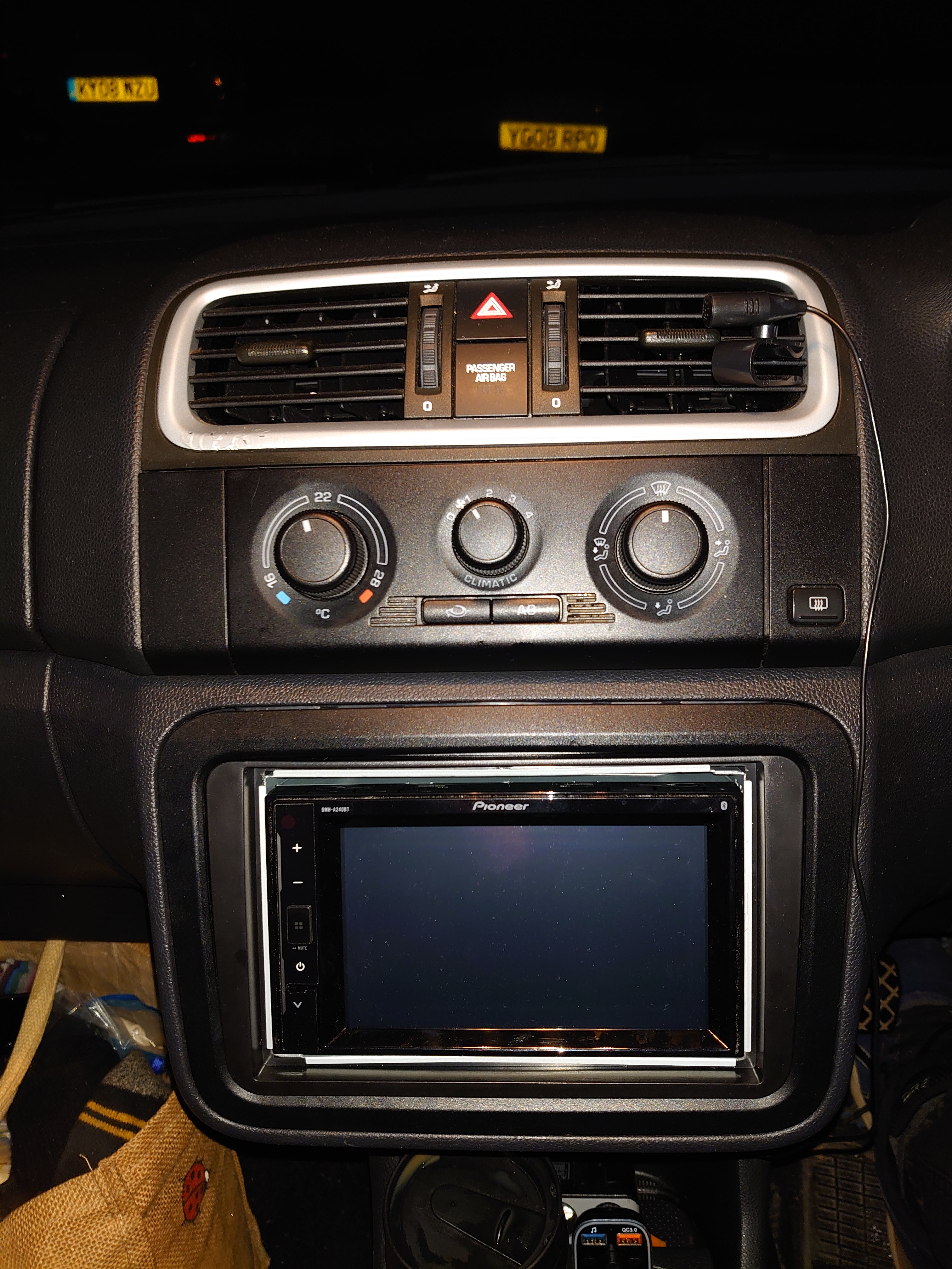

  1. My AC switch is above the radio see attach photo thanks

  3. Thank I have a 2009 1.4 TDI Sport. I need an ignition live so it switches off with the ignition so I don't brain the battery thanks
  4. Hi guys I have decided to change the stereo in my MK2 fabia. I have fitted a pioneer dmh a240bt double din. The adaptor kit comes with a red wire for power and a orange for illumination. I have contacted the red to a live within the original radio harness. This works fine. However it doesn't switch of when you switch the car off. Where can I easily find an ignition live (is there anywhere within the original harness). It doesn't pose to much of a problem as long as I remember to switch it off when I get out 😂😂😂😂😂 Thanks in advance Regards Jim
