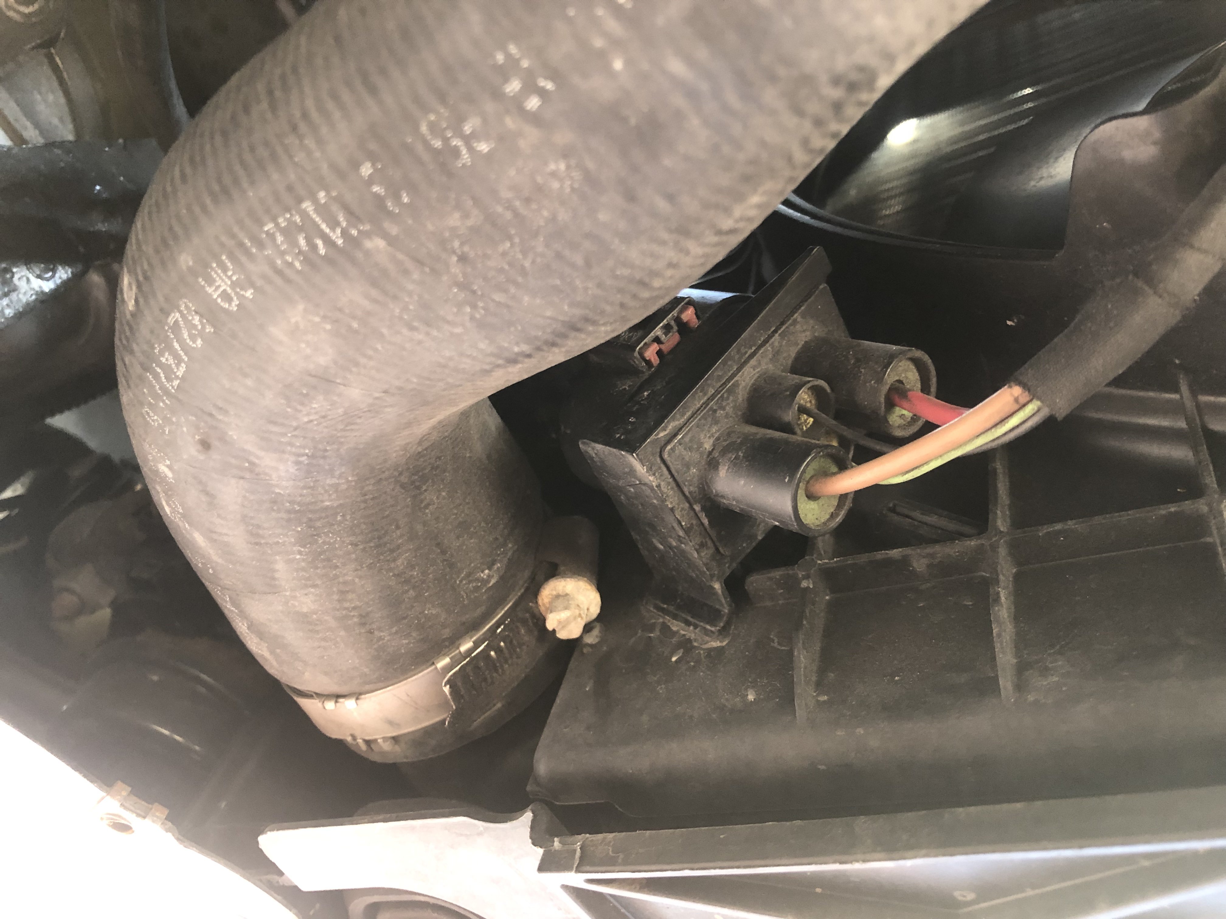

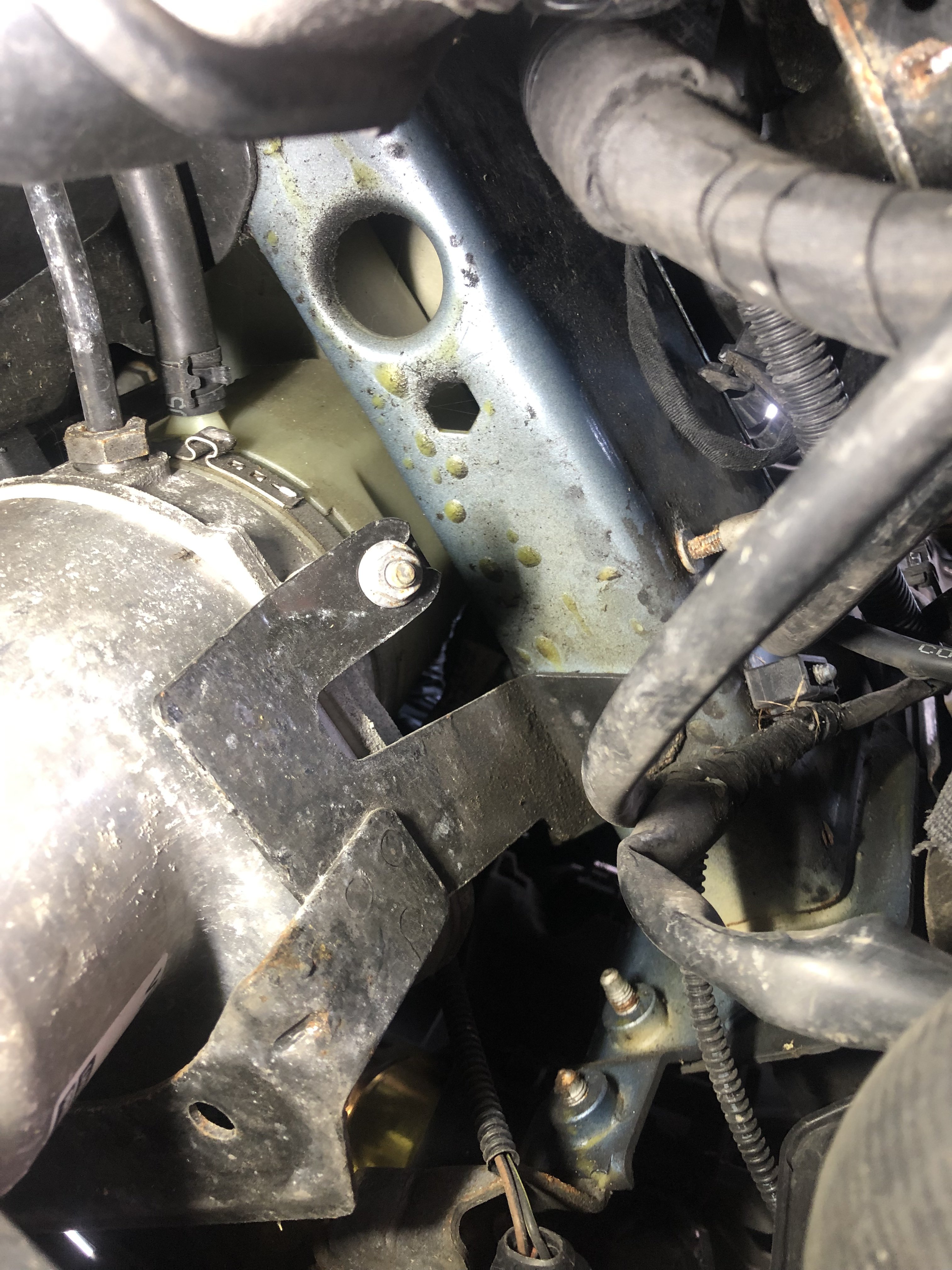

  8. Yep, (still) isn’t there The 2 rods are welded onto the chassisleg. The loom is tied to one of them. No relaybox there. I’ll take a picture later today.

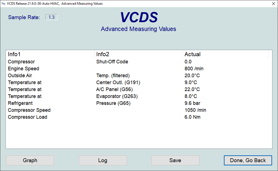

  12. Well this evening wasn’t well spend. I took apart the loom from altenator to 8p connector. All is in good nick. So tomorrow I can wrap it up again. And put everything back together. Brainwave: I think I’m in a loop. ECU oversees proceedings and detect the new N280 valve. Blocks valve because compressor run in hasn’t been carried out. But I’m unable to start this procedure (see screenshot) -> ECU keeps blocking the compressor. Blockage is now causing 00898 to pop up in 08. So I think my best bet is: Put the loom back together. And to be 400% sure, check loom (2 wires from N280 connector) by measuring the resistance. Ground merges somewhere below the battery box. Buy a C or D Climatronic unit and pray that it will be able to perform the compressor run in. Any other suggestions? VIN as shown in VCDS matches sticker in trunk.
  13. Thanks for all the input, I alreadt tried to get nearer to the fan, diffucult to get access to. Lets see how the loom looks first The loom looks as old as the car and standard as well. Really really strange.
