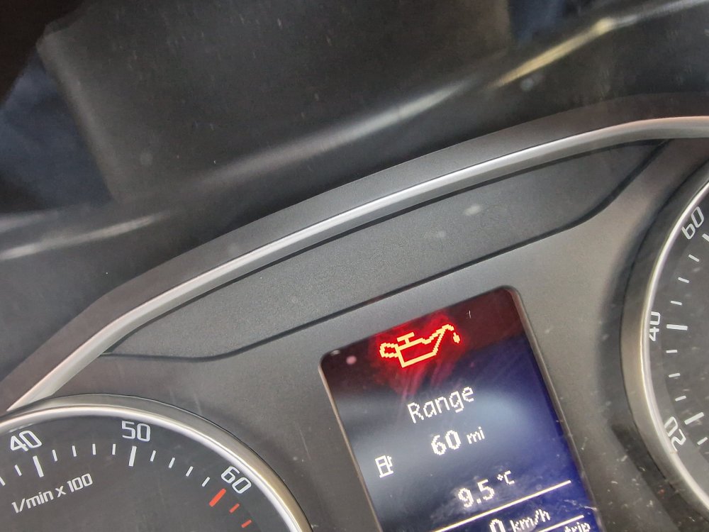

  1. No I did not change oil . I just change filter and error is gone .it was wrong filter fitted and nobody thought that could be the issue. You guys point that out for me .engine oil was changed when they changed oil pump even that garage don't even bother to change filter . I am going to go to that garage and tell them if next time somebody come around with low oil pressure. It will be good idea to change only filter and switch first then open sump .might save money for car owner .your guys are great .thanks again for your time and help I really appreciate it
  2. Hi Guys thanks for your help . It was wrong oil pressure fitted on the car . I changed oil filter as you guys adivsed. Its fixed no more error . We're been looking at the wrong side .
  3. Hi I have changed oil to 5w40 .nothing helps . Error is still there . I have about 3 oil change all together in between those oil change I drove only few miles . I trying to find someone to look at engine now .any suggestions where to possibly look .let me know

  9. Hi I have skoda 1.4 tsi . Last year it went for routine service .they changed all filters,oil and spark plug . When I went to pick up the car .as soon as I drove off from garage .oil pressure low light comes up . I went back into the garage . They looked everything. They changed switch check all wiring . They changed oil pump as well.no blockage found . But error is still there . On driving its as normal . No engine Heat up or losss of power. When I start my car in morning no error until car temperature goes normal they every few minutes you get error on speedometer . If you are on motorway and going on 70 mph then there is no error. It's only comes up when I drive on low speed . Like a said on driving the car on daily basis its normal no loss of power or anything. I have no idea. I have been to many garage They couldn't find problem or don't want to check because its worth looking for them.time consuming. I have been told by some garage just get the new engine .its the easy way . Some say its crankshaft wear . Or some say crankshaft valve . Some say turbo charger or some say timing chain .or engine ecu computer. I can't change all these to experiment and finds out problem is still there . Anyone have same problem let me know which garage fixed your problem so I can go to that garage and have it fixed .
